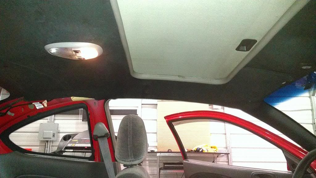

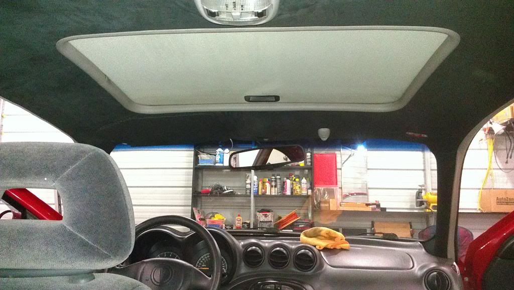

MAC the KNIFE 01-03-2014 07:57 PM

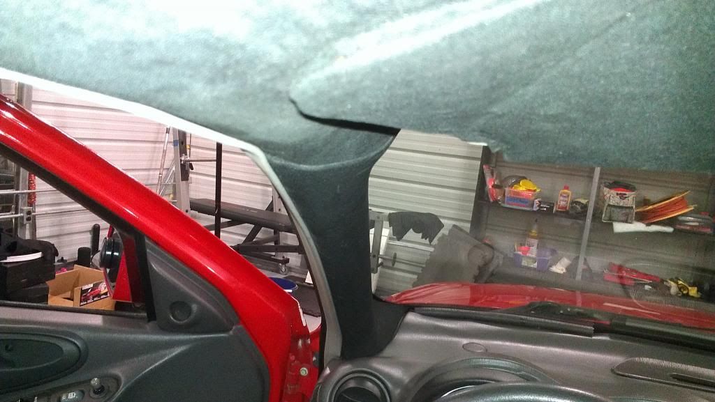

micro-suede headliner in the process
http://i1367.photobucket.com/albums/...ps2d668ca5.jpg
http://i1367.photobucket.com/albums/...psbeb8eb0c.jpg

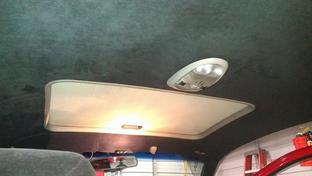

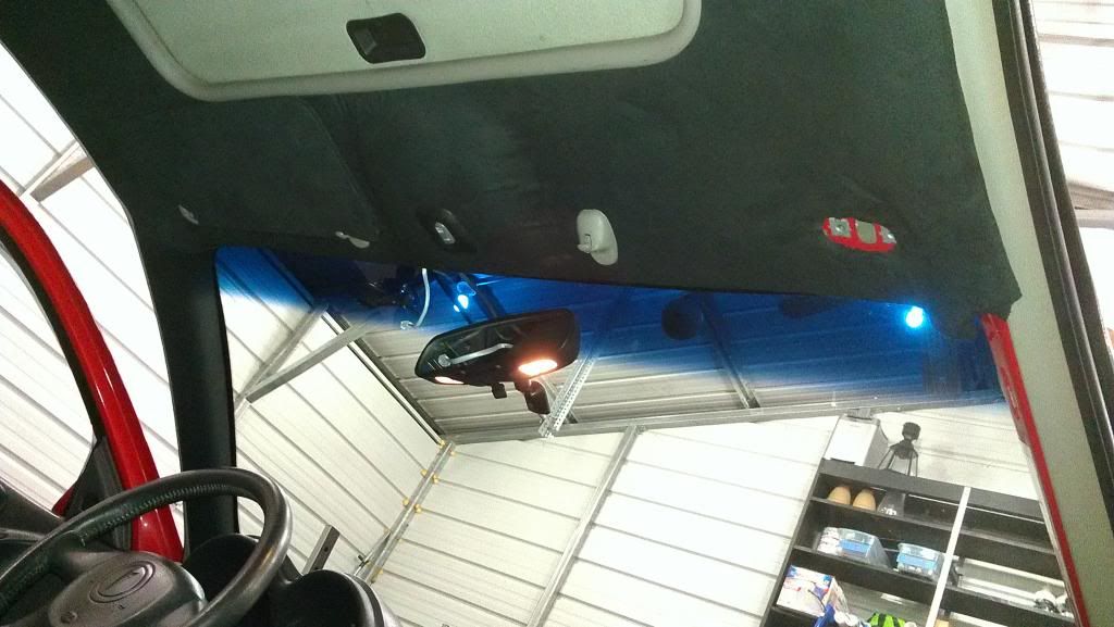

planning to do the rear side window panels too. i used regular auto-upholstery glue on the plastic trim pieces. wiped them with alcohol first. it's sticking pretty good.
http://i1367.photobucket.com/albums/...ps8e0cebf8.jpg
those aren't bubbles. i pulled off the old cloth but left the foam in place. i used a heavy duty sealant for an adhesive. i worked it into the foam, then put the new fabric on. those are areas where it contracted when dry. you can touch them and tel they're not bubbles! and it's still got the softness of the foam backing when you touch it.
also, these wrinkles aren't so obvious when the light isn't shining directly on them.
http://i1367.photobucket.com/albums/...ps7e09d256.jpg

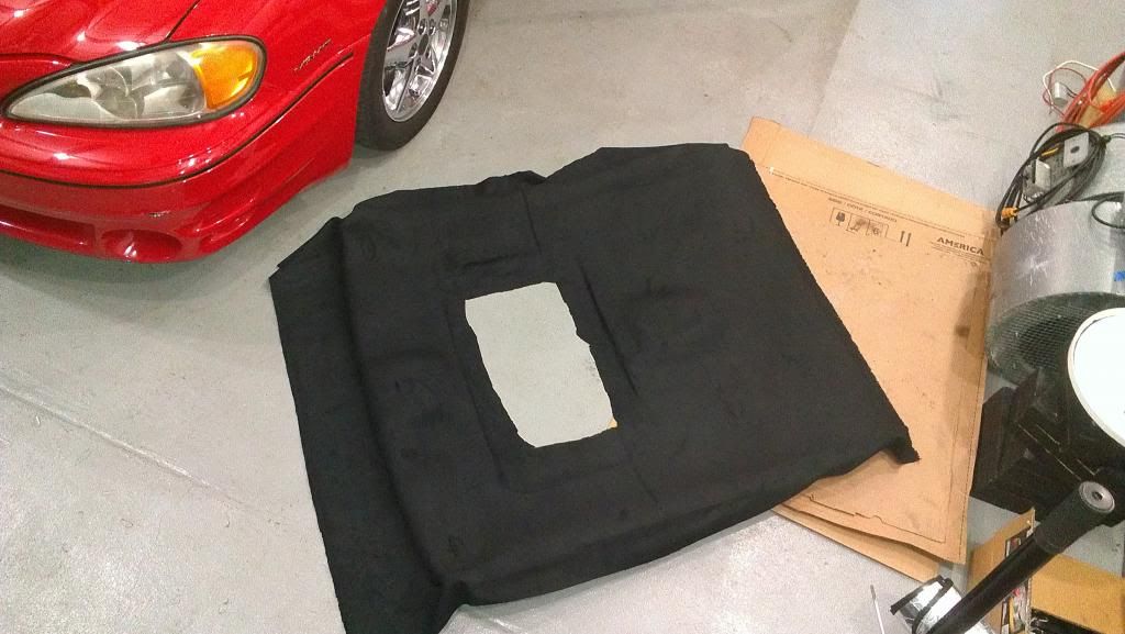

i'm not sure i can take the panel out of the sunroof track w/o pulling the sunroof out, and i dont want to do that. any you guys have experience?

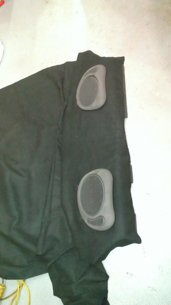

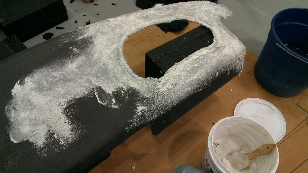

the rear shelf. this carpet won't come off easy, so i just smeared it with the sealant stuff, then spread the fabric over. it's so thick that it won't bleed through the fabric, so it's easy to work fabric and stretch it around the curves.

stewartfn18 01-03-2014 08:15 PM
looks good man. the a pillars turned out good

TDavis 01-03-2014 08:37 PM
You can just fully open the sunroof and pull the sliding panel out from the top of the car, you might need to bend the panel a little to get it out, its flexible so its nothing to be scared of.

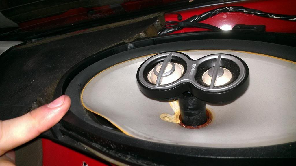

there's a finger in the picture lol. those are old infinity reference or kappa? (whichever one was cheaper) i thought the sound quality wasn't as good as it used to be.
Car's looking good Mac. :) Replacing the factory speakers is on my "to do" list one of these days. Not looking forward to it. I've thought about doing some more upholstery work as well at the same time, but don't know if I want to go to the trouble.
The only fabric actually coming loose on mine is on the sun visors, and those would be difficult to recover and make a good tight fit, without having them professionally done. I did some other stuff using that 3M interior spray adhesive and it works pretty good, but isn't super strong either. It works really well as long as you have something to clamp down the edges to make sure they don't start getting pulled off. I did my center arm rest and side door panels like that. You should be pretty good there, what with how the the fabric folds behind the A-pillar covers and the covers clamp over the corners of the head liner. That should hold it pretty tight. Where did you get the suede from?
