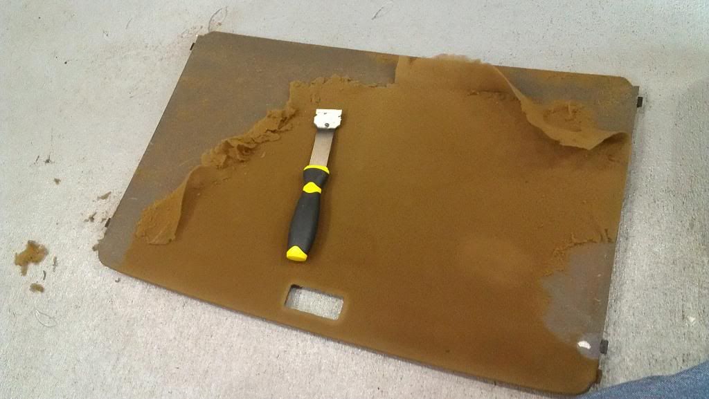

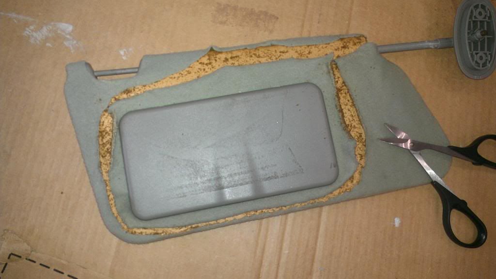

all the mods you've done, i CANNOT believe you still have factory speakers lol. the sun visors are definitely a bizsh. i pretty much destroyed the driver side one. BUT now i know what NOT to do on the passenger side lol. the visors btw are literally paper. calling them cardboard would be too generous. i got the microsuede from joann fabrics. i got enough to do the headliner 2x and them some. only $26. the b/c pillar plastic trim is being a real pain. too many curves. i might just plastidip it black. oh and i got the sunroof panel out, thanks Tanner.

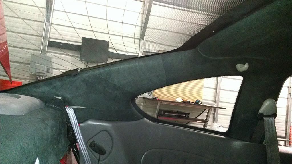

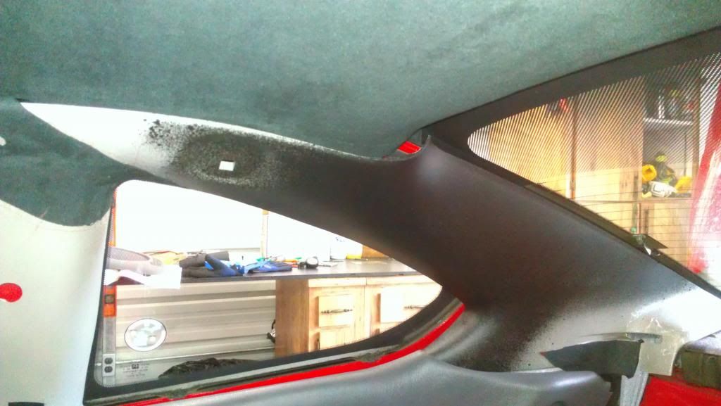

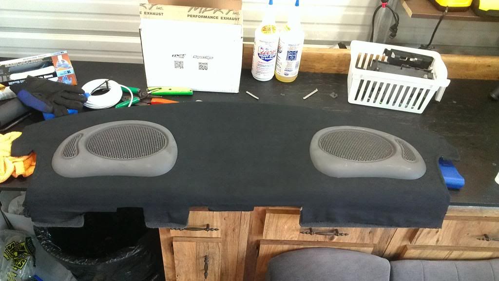

MAC the KNIFE 01-05-2014 07:27 AM
http://i1367.photobucket.com/albums/...ps7aa72f71.jpg
comparing plasti-dip to the suede. the p-dip was semi gloss and didn't fit between the suede headliner and rear shelf. but it would have BEEN SO MUCH EASIER
http://i1367.photobucket.com/albums/...ps8b1181b1.jpg
http://i1367.photobucket.com/albums/...ps58a1c607.jpg
http://i1367.photobucket.com/albums/...psc146287a.jpg
http://i1367.photobucket.com/albums/...ps71444138.jpg
http://i1367.photobucket.com/albums/...ps0d42a3ac.jpg
biggest PITA ever. made out of 20 little pieces of fabric. it's like a quilt. too many curves.

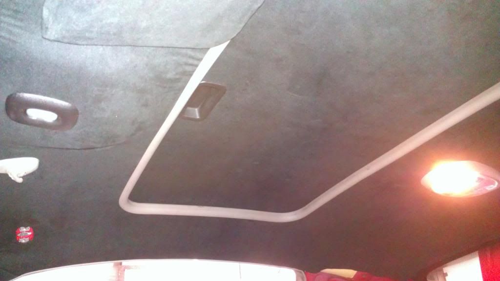

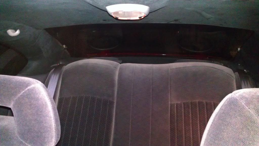

http://i1367.photobucket.com/albums/...pse8905c0d.jpg
http://i1367.photobucket.com/albums/...ps4920dcef.jpg
http://i1367.photobucket.com/albums/...ps8fafb27f.jpg
http://i1367.photobucket.com/albums/...ps5cb76a8f.jpg
i haven't done it in this pic, but wipe it all the same direction with a microfiber and it looks perfect.

the sunroof looks perfect. the A pillars look perfect. the headliner has those wrinkles, but that's on me b/c i left the old foam and used a hevy thick adhesive. probably would be perfect if i'd scraped the foam off headliner and used the glue. the C pillars are just tooo BIIIGGG to use a single piece of fabric on. they have too many curves. i hate how the c pillars turned out. but i got tired of fooling with them so i said screwit and did 20 odd pieces.
i put too much effort in this. i'd recommend p-dipping the a/b/c pillars. BUT somebody had to be the first lol.

Wow that actually came out really well.
