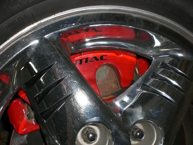

When I had no other choice but to use my stock rims I had to trim the plasic slightly....
not much room at all. I guess the torqued style rims work a little better.

that's the style of rims i have but mine do not have that plastic covering . will i have the same problems.
