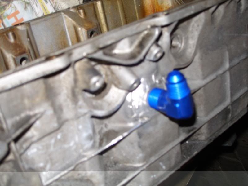

wow all that stuff that it says in the book, scratch that, it took us approximitly 5 mins to get that oil pan off, another 5 to drill it out. now tomarrow im getting it welded, car is going back together, prepare to see another boosted grand am

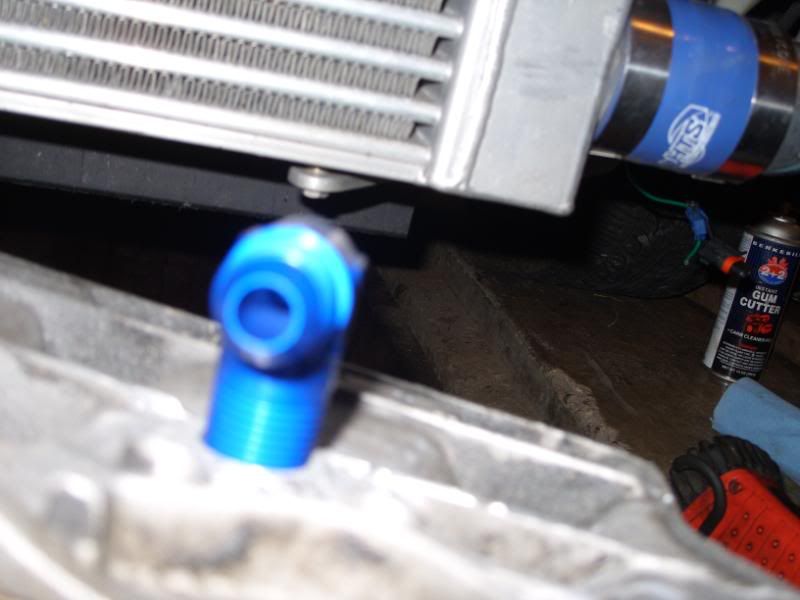

today: oil pan welded/install and we are putting heads/manifolds on

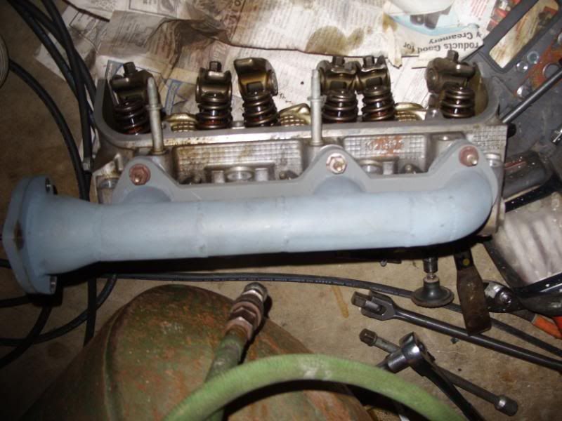

some new pics

The first picture is one that I took?.....

ya my bad somehow i put that in there hahahah

i didnt take pic with digital camera, didnt have it with me, but here is where i am at now(little further though) i have both rear and front manifolds on and heads bolted and torqed, along with oil pan is on and ready to go. things are going together pretty smooth.

LIM is on i should have this done by next weekened, not sure if ill have it running yet.
