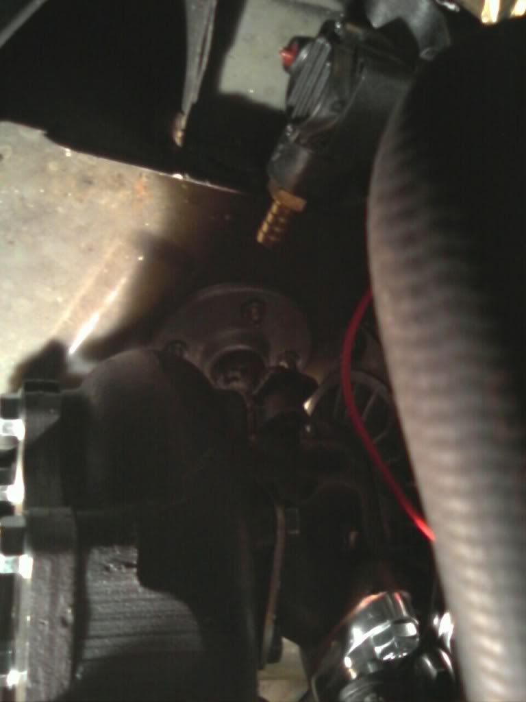

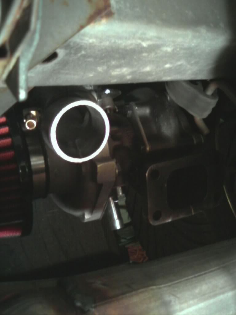

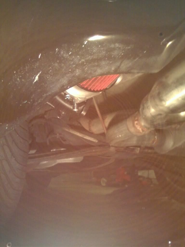

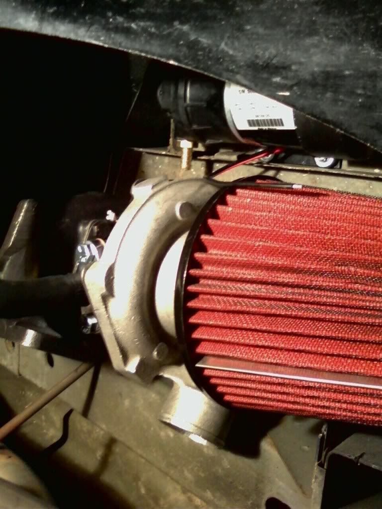

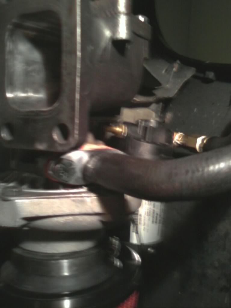

Ok, I got the Turbo and oil pump mounted this evening! PICS are coming! I am surprised at how good it looks. I won't plumb the hardware until I get my other car running.

I am still having more issues getting my pics online! Sorry for the delay. Now that the turbo and oil pump are secure, I can concentrate on the front of the car. This saturday, the front
fascia comes off and I install the intercooler, oil cooler, and transmission cooler. It is going to be a full day!
I will try again tonight to load the camera phone pics so that you can see. There is so much room behind the fender wells under the car that you can throw a party! The BEST part about the build is that neither the turbo, wastegate, or oil pump can be seen. Total Stealth. I am going to place a mudguard flap behind the driver's side rear wheel to enclose the entire system and protect the turbo from splashing road debris..

THANKS FOR THE HELP!!!!! The project is coming together real well. I will get the rest of the pics up tonight. I added a heat shield under the air filter. I am going to take some pics from underneath the car and behind it again. It looks like the turbo belonged there almost as if it were an OEM application.

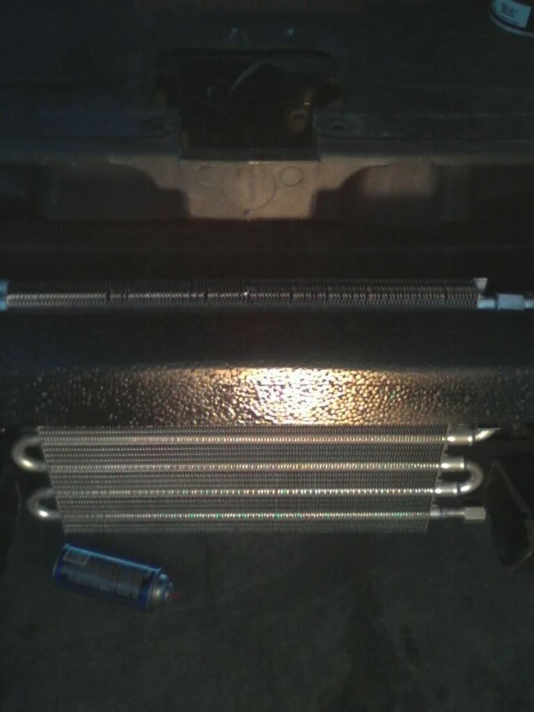

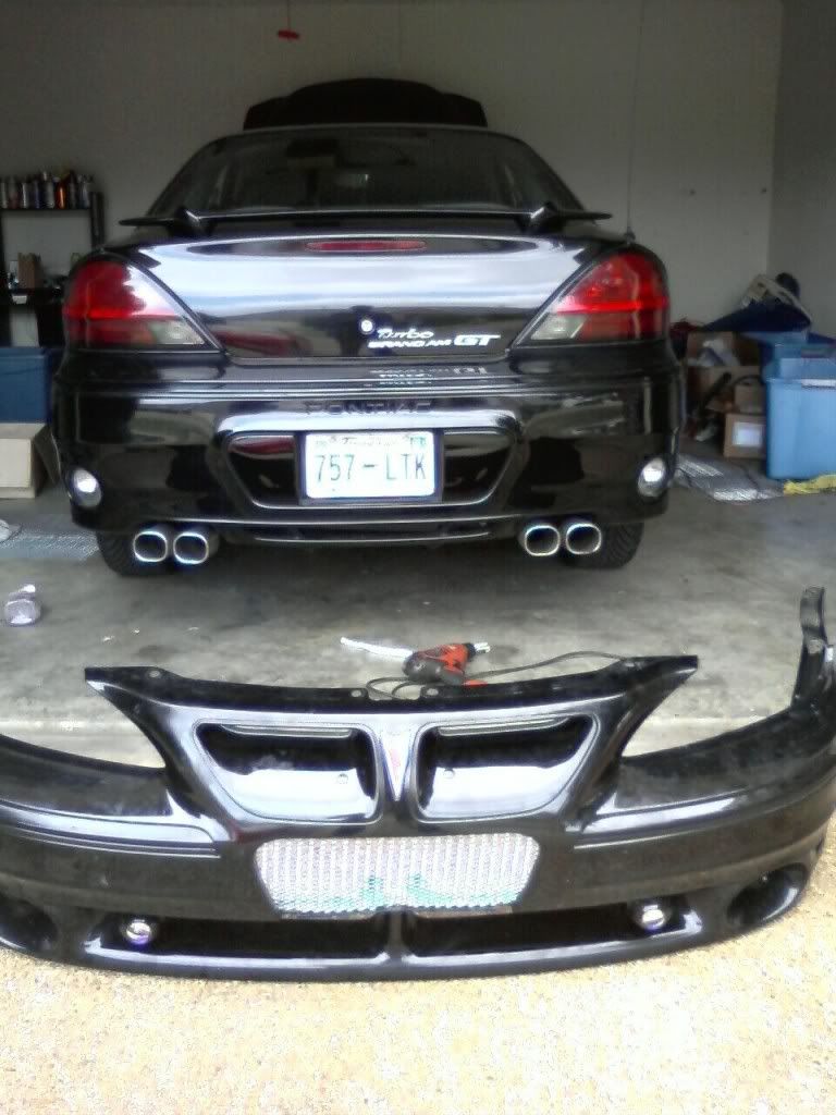

Ok, later on this week will be pics of the front intercooler and the oil cooler and transmission cooler. Due to the front bumper support, this job wil be a PITA!!!!
My plan is to have the brackets for the intercooler to be tack welded into the metal frame behind the plastic bumper. I am going to cut the front license tag out of the fascia, and use a
sawzill, angle grinder, and die grider to fut away a hole in the support for cool air to flow to the oil and transmission coolers. I am going to finally add a chrome painted wire mesh grille over the hole to give it a nice rally (or shoud I say ricer) look!

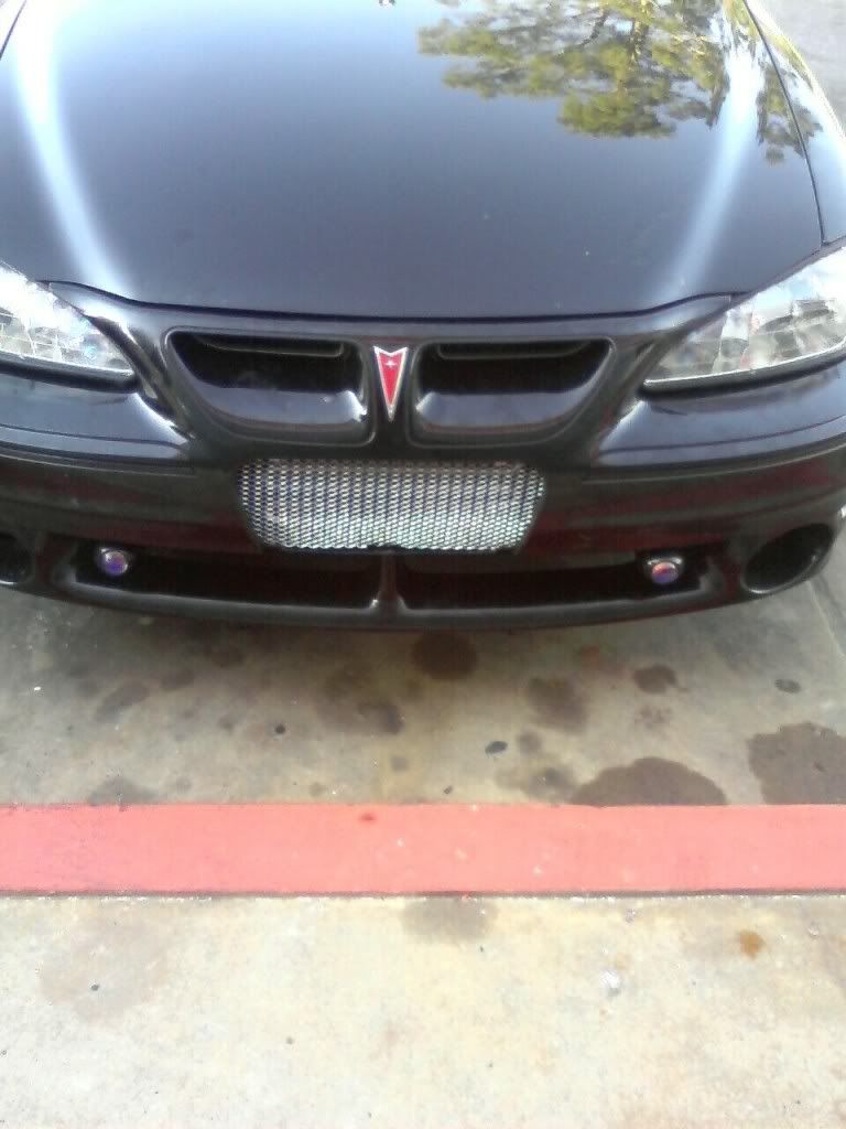

MORE PICS! I just finished the oil cooler and trans cooler. Now there is plenty of air for them
to receive! I am going to try to have the intercooler mounted tomorrow! I got ahead of the game by placing the "turbo" emblem on the back of the car! Enjoy the pics!

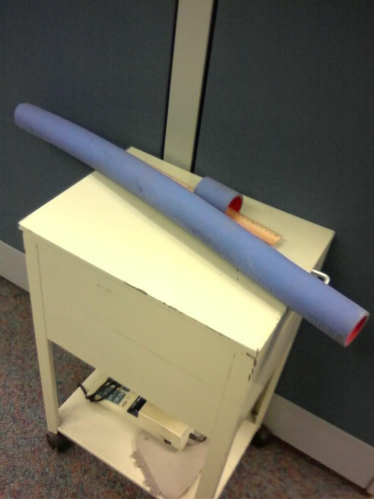

Hey! Do you guys need intercooler couplings? Check these out! They are the same ones that STS uses. They are from PUROSIL and you can buy them by the inch and cut them to the length that you ned. My 2 inch charge pipe will use at least five to six of these. They cost about $1.35 per inch,a nd I cut a 3 foot section into three inch pieces for a total of 10 couplers. I ordered these from Delaney & Alf....

Looking good I have a few questions though.
First of all are you going to leave the front bumper open like that? IMO you should put the license plate cover back on for daily driving then take it off at the track.

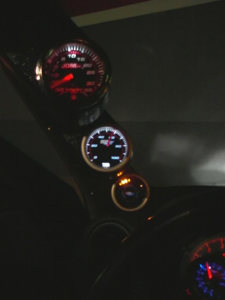

Also in one of the pictures posted above why are their guages right over the top of the stock guages?

To answer your first question... No, I don't want to put a license plate cover over the opening. what you see in that pic is the transmission cooler exposed, and there is a dual pass aluminum oil cooler that looks much like the one here mounted behind it.
http://www.derale.com/heat-sink-coolers.html
The second question: The pics are a little blurry, you can't see the oil pressure gauge and volt gauge very clear. On the Grand AM dashboard, directly looking in front of it, there is about three inches of space that a single gauge pod can mount and operate without interferring with the view of the tach, odometer, fuel, speedometer, or other factory gauges. I simply bolted the two gauges to the bezel and ran wires behind the steering wheel. Here is a link to what I used.
http://cgi.ebay.com/UNIVERSAL-52mm-2...742.m153.l1262
I think that I will make another sticky in the "HOW TO" section to help anyone that wants to do this neat mod!
If you look directly at the gauges, you almost cannot tell that they are aftermarket. The color change to the GA red looks amazing. Here is another PIC.
