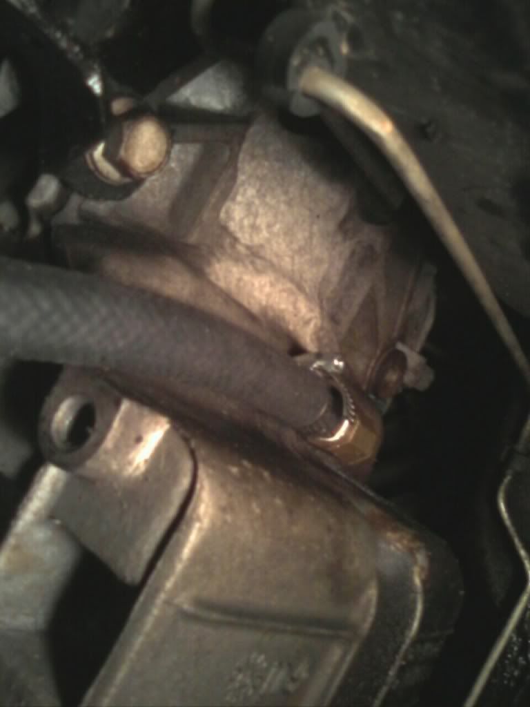

Last night I plumbed the oil pressure and return lines to the turbocharger and the
scavenge pump. I ran out of brass fittings and clamps so the work was cut a little short. I have routed part of the pressure hose inside the trunk where there is a
brass shutoff valve. If I grenade the turbo, I can easily detatch the turbo and cutoff pressure so that engine damage does not occur. I can do this in about 15
minutes and still drive the car home to safety if necessary.
I used a combination of nylon loops (from Home Depot), sheet metal screws, and
wire ties to brace the hoses under the car. I am still debating on wheter or not to
send the oil return hose to the oil pan or valve cover.

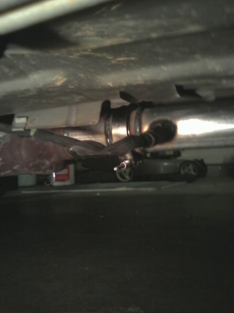

This is the oil line in the trunk behid the lining. You see the shutoff valve, and I will also place the Relay for the pump here to make things easier also. You can also see the check valve before the turbo which is underneath the hole.
Here is a shot of the oil lines routed along the safety brake cable
This is the nylon strap for the return hose

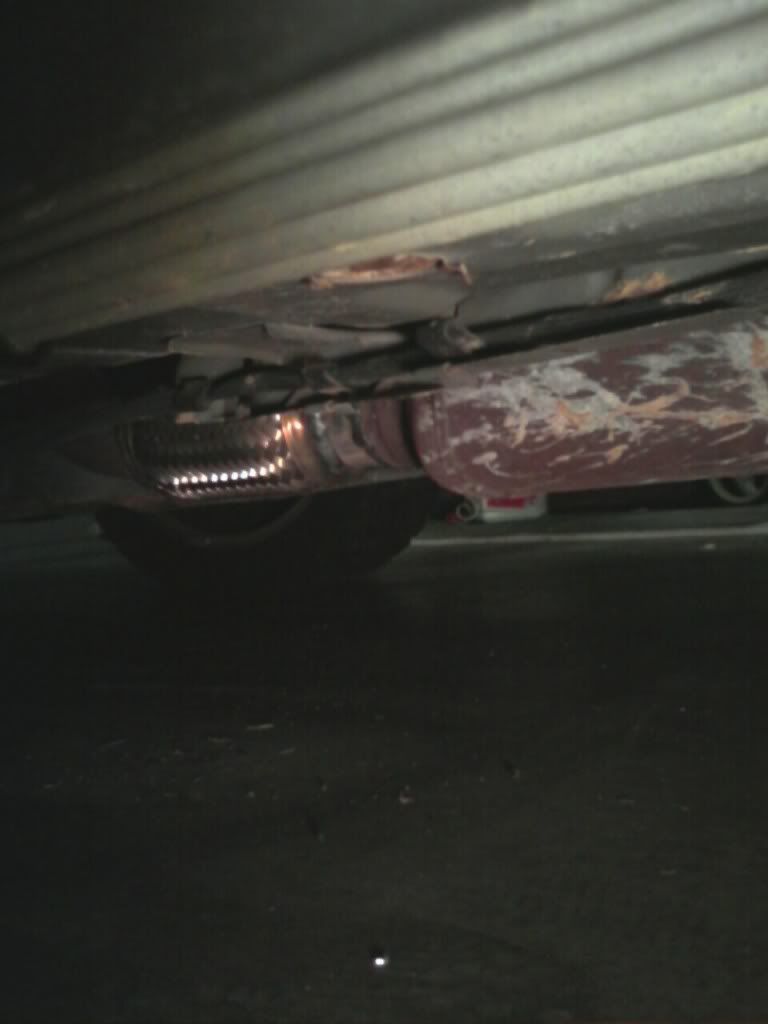

Here is a shot of the new main exhaust pipe from the cat back. Notice the V-band.
Can you see the flexjoint and CAT? I will get some new pics and get them up tomorrow.

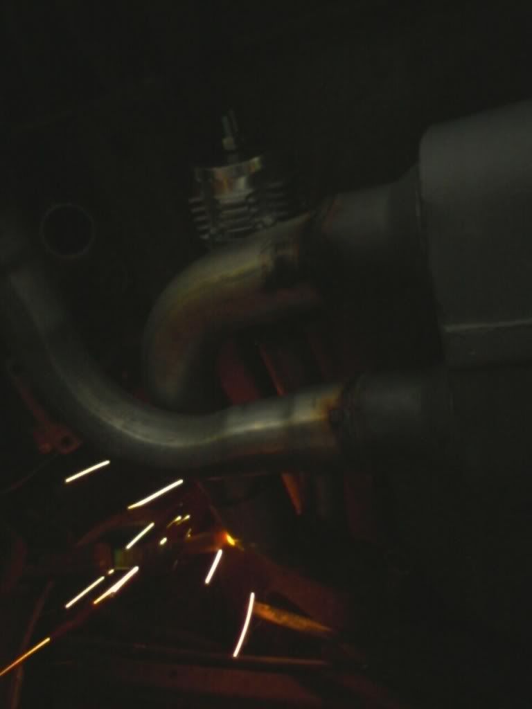

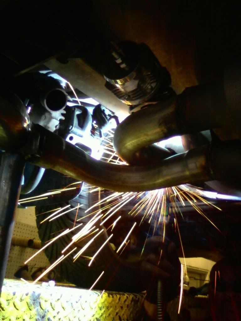

Guys, this is really coming along good! The guys at the muffler shop attached the wastegate today. hey are pros and the work is topnotch! You cant even see the WG standing behind the car. I had about two or three patrons at the shop wondering what the heck I had back there!
I still have not plumbed the main exhaust into the turbo just yet. I am working on the intercooler piping and oil return system this week. I should have those parts finished this Saturday

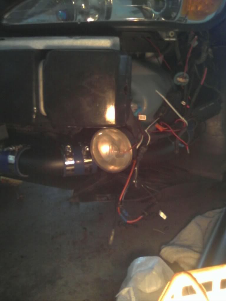

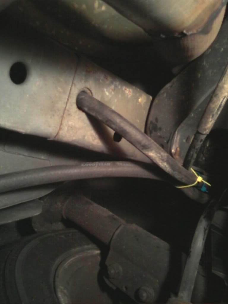

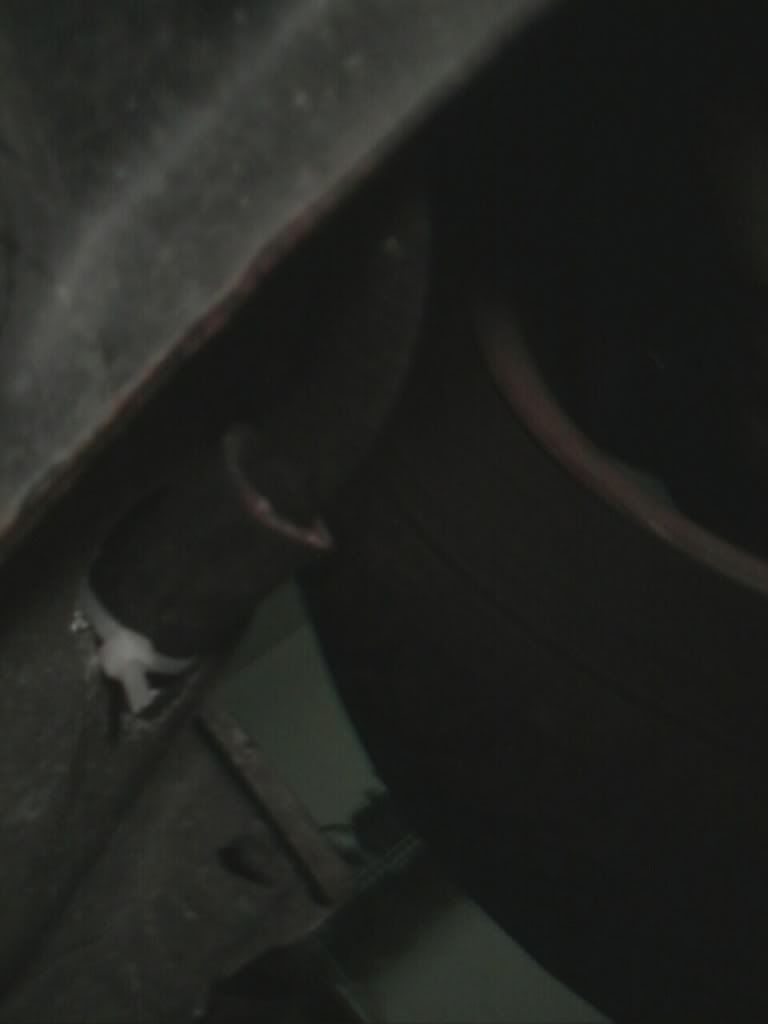

I completed the oil system tonight. I had to drill a larger hole in the frame area right behind the drivers side tire. Started her up and test ran the pump too. No leaks no problems. I tapped the oil pan (while still on the car) with a 1/4 NPT brass fitting. The tap is a little below the average oil line, but I don't think that it will be a problem because the pump pushes the return oil back into the pan anyhow...

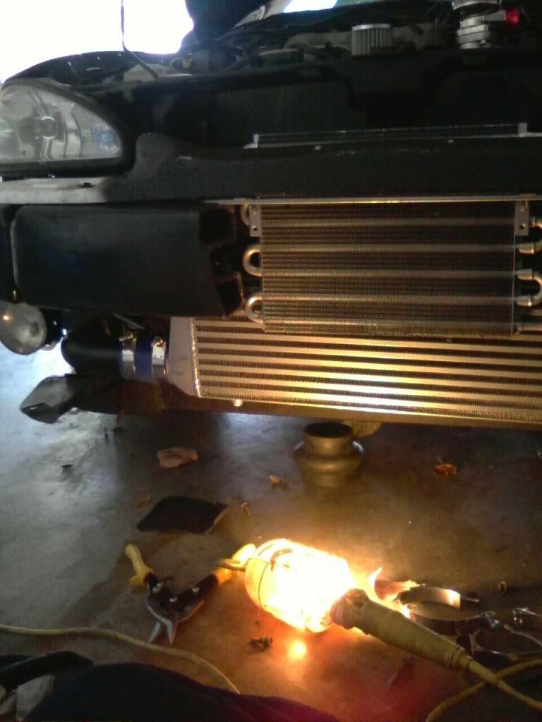

Here are some preliminary pics of the intercooler piping. I am using a kit from ebay, but I quickly found out how tough it is to route stuff behind the front facia without 45 degree bends. Needless to say, half the piping will be aluminum, and half will be aluminized exhaust that Will have to be custom bent from the local muffler shop this weekend. I will paint it black
along with the rest of the kit...
The toughest part will be getting the piping around the battery and to the intake manifold without having to cut the hole already provided for the Ram Air assist.
