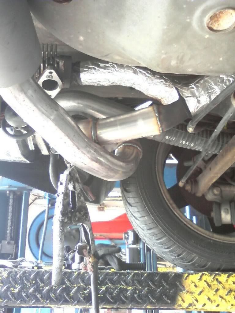

I will have to take some more tonight....This is what the finished product looks like
Oh and yes... the check engine light finally came on I am thinking of taking the
O2 Simulator off my Firebird and putting it on the GT until I get a good tune...

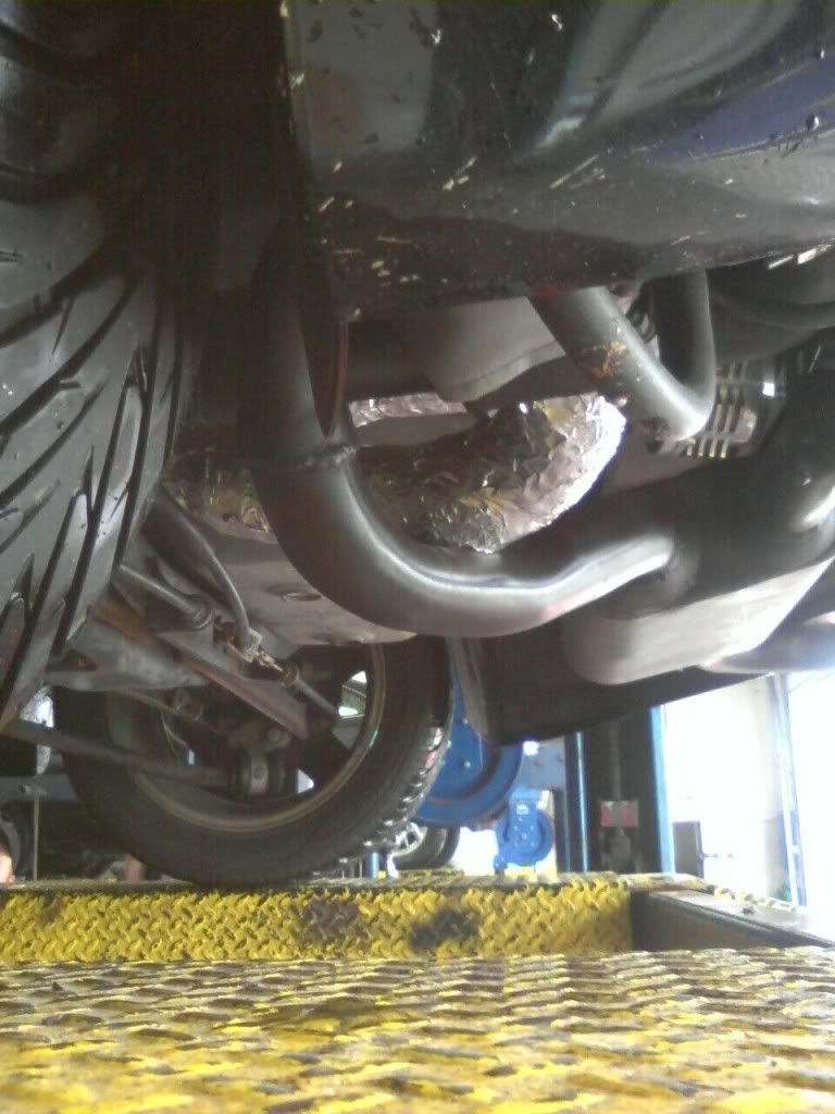

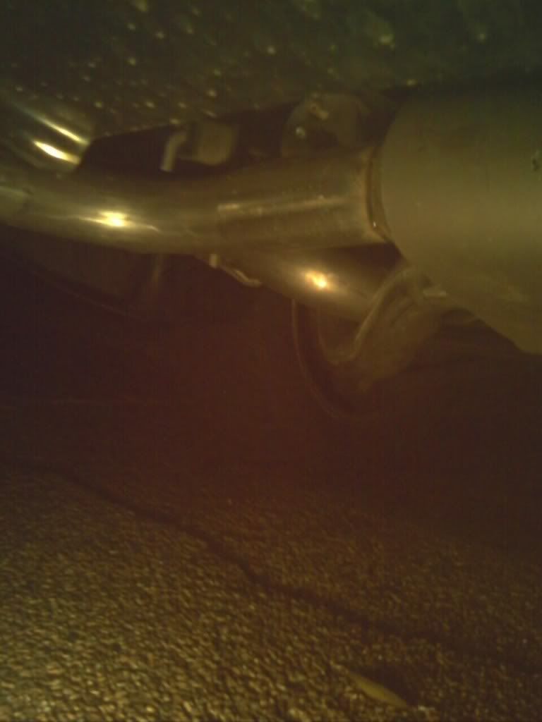

Here are some more pics... They are not the best, but I hope you can get the gist of it. I will need to shoot some more during the day...

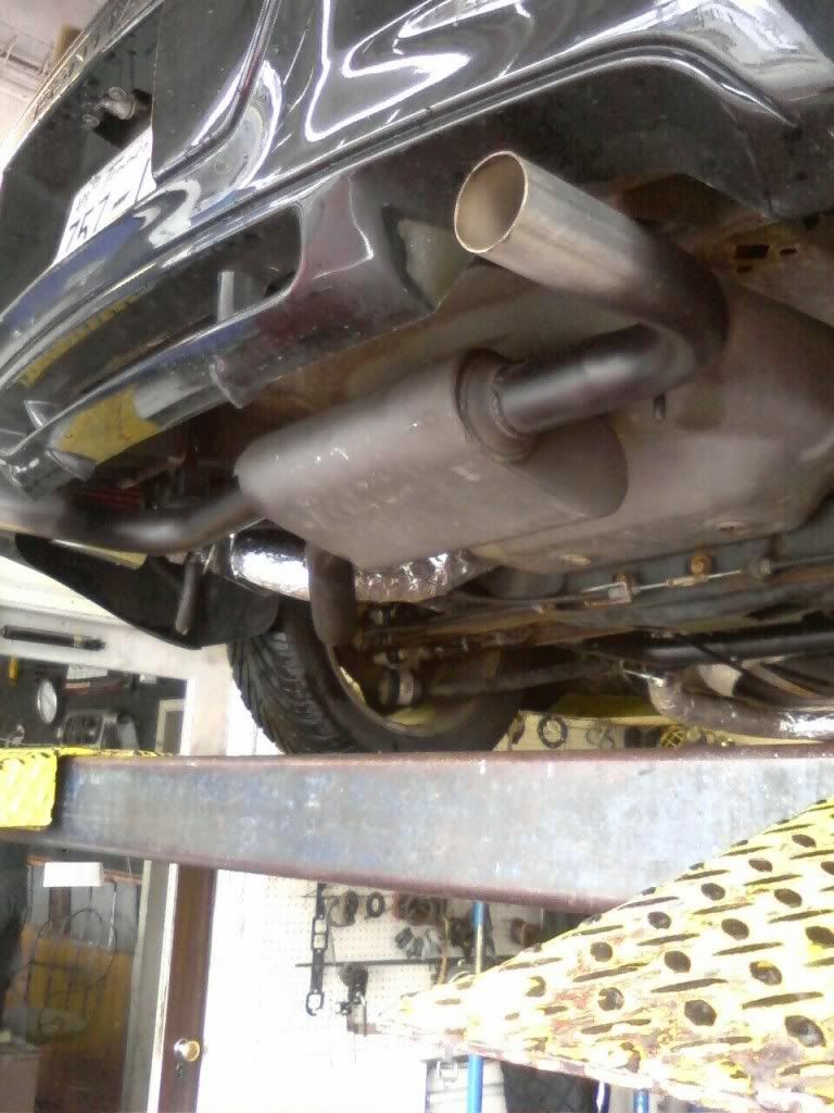

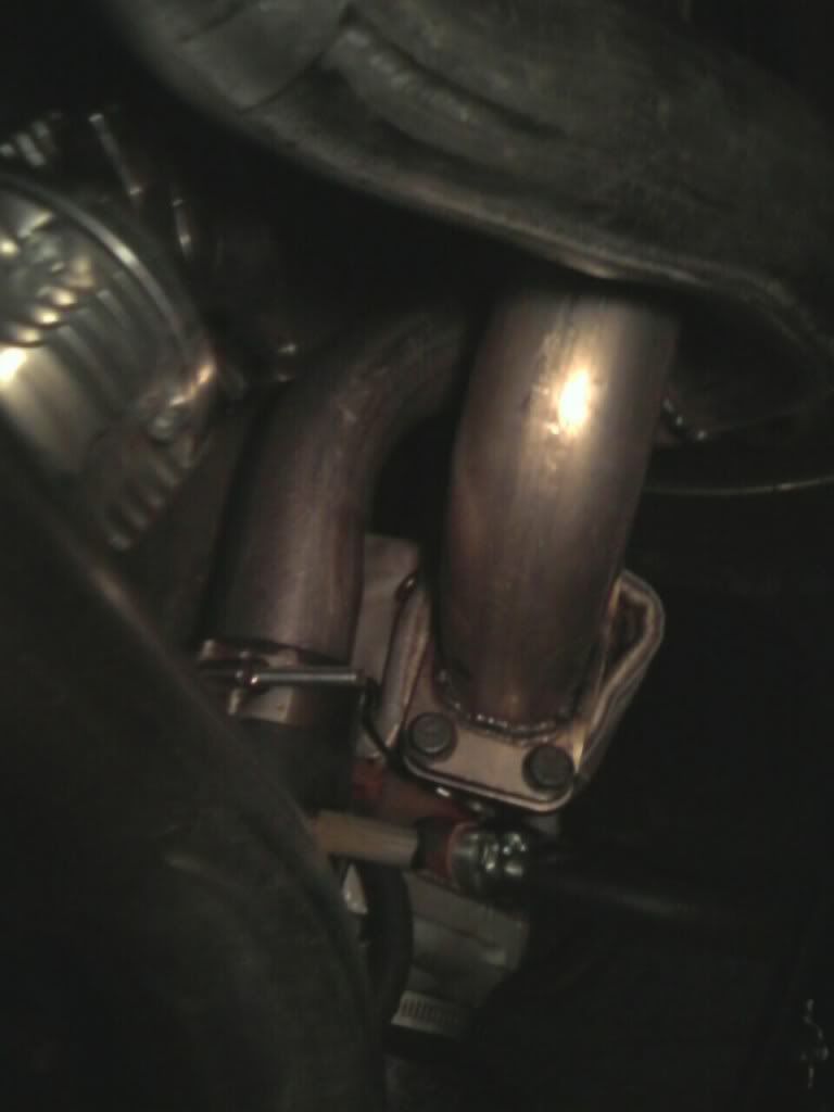

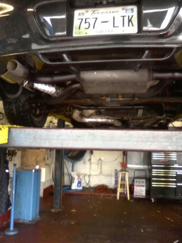

Here are some better pics and the final assemboy. Enjoy
