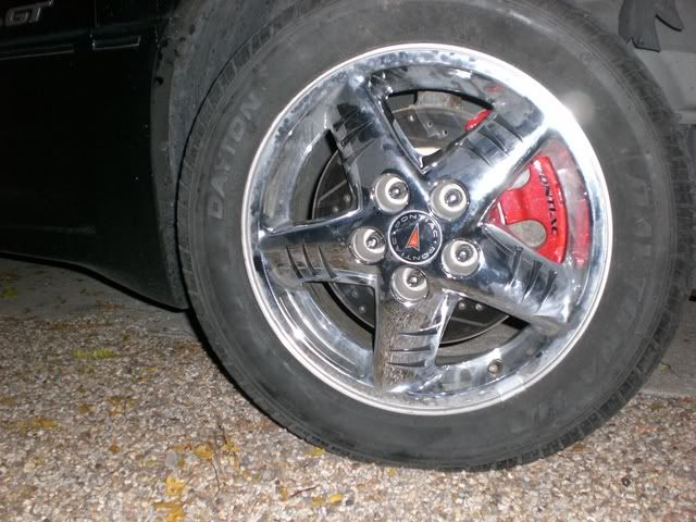

That's my car with ws6 brakes (same as all the other f-body ones). They fit alright, but I did need to grind quite a bit away from the inner plastic part of the wheels. Still its a very snug fit and I would only suggest it for winter.

only difference between those and the vette ones are the lettering and the vettes are made of a lighter material iirc. The gap is extremely small but seems to work (ran it two winters now) I did have to grind one of the wheels even more on the last pad/rotor change. Not sure why but it was hitting again. You don't grind the actual wheel but it hits the plastic "chromtech" cover. IF you have the non chrome ones you might not need to do anything.
