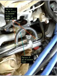

OK. I guess here's what a simple coolant bypass hose is. It took this OLD brain a bit to figure out. Any of you guys smell smoke???

Ya the coolant bypass is the easiest thing in the world . I just did mine today since i finally got my 65mm TB from Mark today which i def. notice a huge differ. with the ported UIM and 65mm TB. Now to wire up the nitrous and tune my PCM oh and put my LS1 MAF on and tune it for that. And i'm putting new motor mounts on bc mine are shot and the motor moves when i put it into gear
