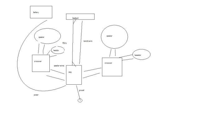

I got first dibs on a set of the Alpine Type-S 6x9's in the "Stuff For Sale" section hopefully. I was first to scream i wanted them anyways, . Hopefully he will let me get them for a decent price.
Couple things I need to get straight... 5.25 components up front, 6x9's in the back, I need a 4 channel amp for these speakers? And for the fronts it will wire into the crossover box and then send applicable signal to the tweeter and 5.25 as needed... right? Now currently the speakers run up to my HU in that harness in the back, do I need to now run a line from the HU to the new amp and bypass all of the speaker to HU lines?
Sorry for so many questions, just want to make sure I do this stuff right the first time, or at least as close to right as I can do on my own.

here's a little diagram i just drew up to help you out!!
**** its kinda small but w/e

Thats perfect, thank you. Confirmes that I was correct on how I assumed it would go.
What guage wire would you recomend when runnign from above locations? Also keep in mind I do already have a Memphis 1000D, 1 Farad Cap & 12" Alpine Type-R... Any idea off hand how that will all fit in to play?
