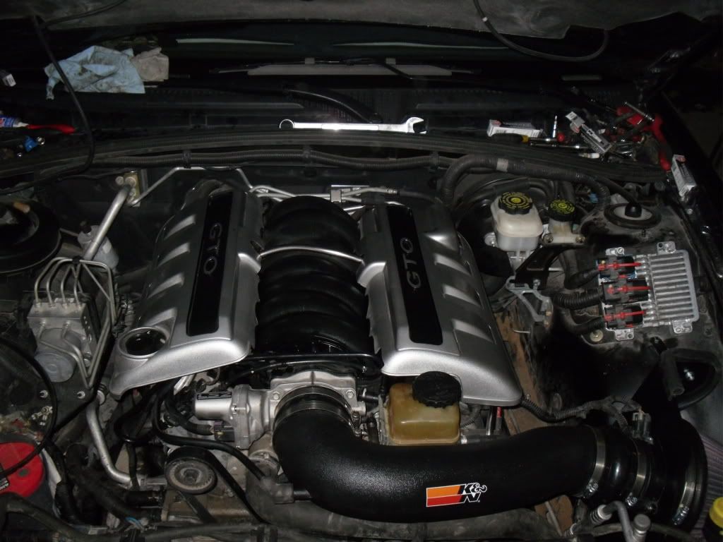

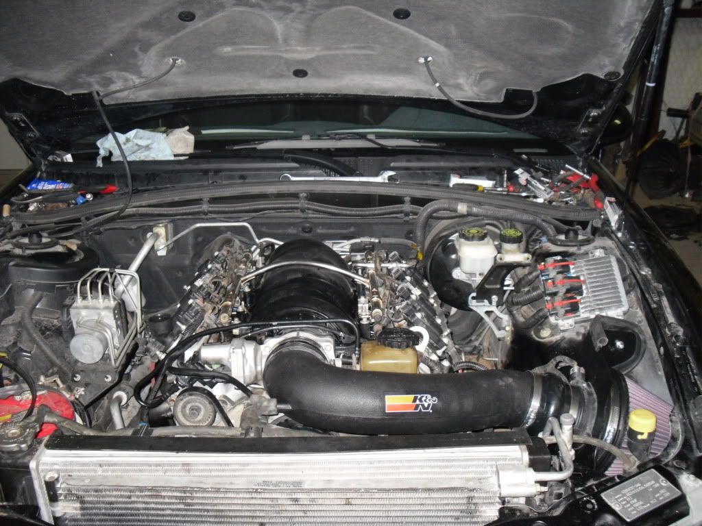

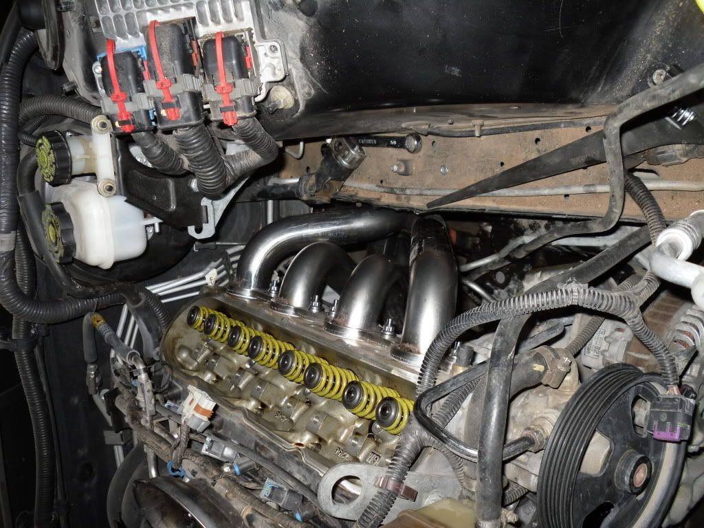

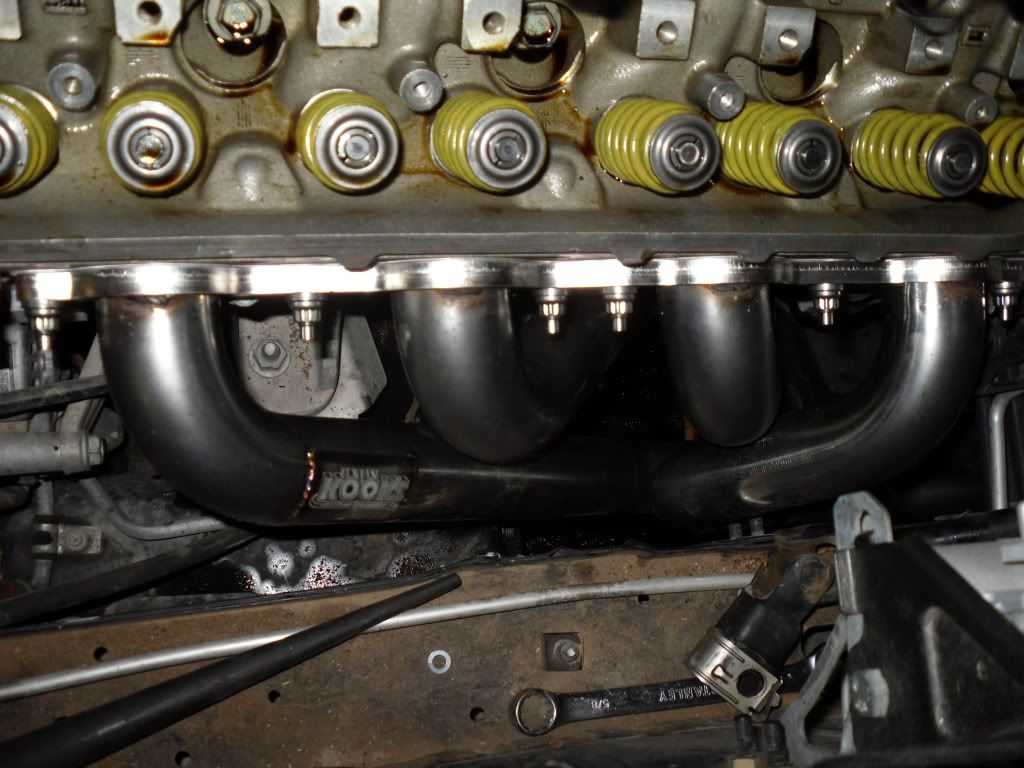

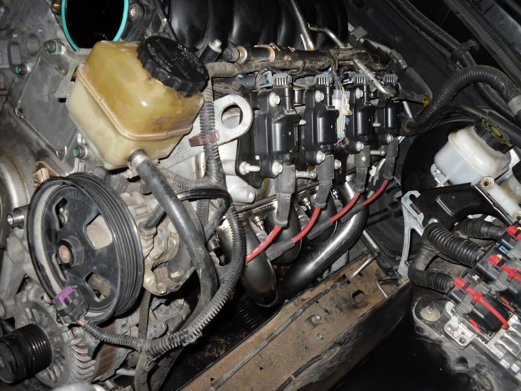

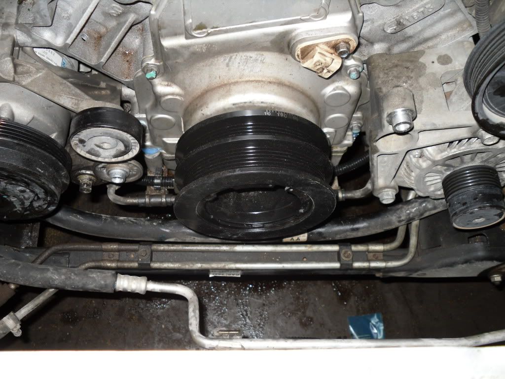

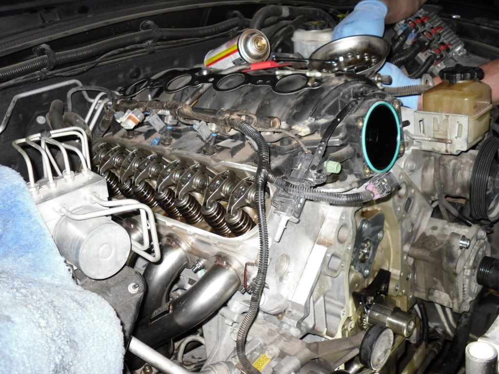

Got the some longtubes and a cam this past weekend!

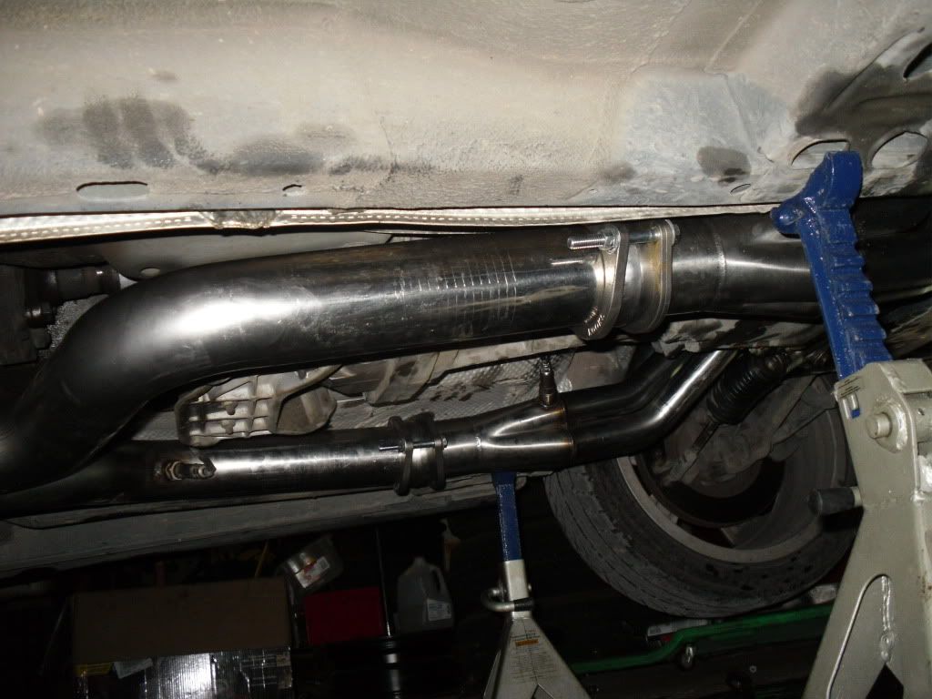

Went to some buddies of mine in Lubbock who installed and hp tuned everything for me, got some quick pics and videos of the car untuned with open exhaust. I got a magnaflow 2.5' catback system on and ill have those pics/vids later!
Mods that went on:

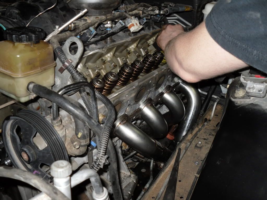

Custom grind Comp Cam: 226 234 610 625 114
Magnaflow 2.5' Catback
Kooks 1 7/8 Longtubes
PAC 1518 valve springs

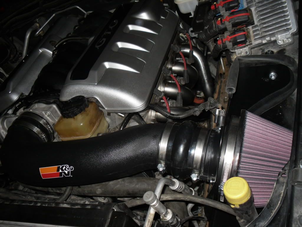

K&N Cold air
Powerbond 25% UD Balancer Pulley
LS6 Oil pump
New timing chain
HP tuned
+all new MISC. needed gaskets/bolts
Nothing
Coming soon!
