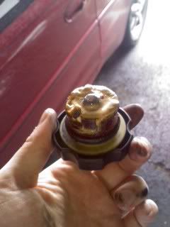

i switched from R.P to Edge this fall for 2 reasons. first is money, and second is simply i wanted to try it. i changed my oil filter last week and when i went to add more oil, i couldnt get the cap off. had to get a screw driver and pry it up. finally when i got the cap off, there was a sludgy orangish buildup on the bottom of the cap, and the threads. i have no idea wtf caused this, but i have never ever had this happen with R.P. so needless to say i'm going back to R.P, and probably doing a engine flush as well.
oh also i either use A/C delco pf47, or Napa Gold 1036. both are oversized.
I never have that issue with Edge. :
You couldn't pay me to use Royal Purple oil in my ride
Patman on BITOG & various LS1/Corvette forums had them send him free cases of Royal Purple to test.
He put it in is wife's daily driver Honda Civic (not his C5 LS1 Corvette), & that stuff sheared to sh1t !
This was shown twice using UOA (Used Oil Analysis).
I have heard of this colour before, after changing to a new type of synthetic motor oil (but not the sludge build-up).
It was the new synthetic motor oil cleaning out what was left behind from previous oils in the motor.
So, I would say that Castrol Edge has nothing to do with it causing it; but causing it to clean out your engine.
This could last for like 2 oil changes.

so ur saying change the oil and go back to Edge. that makes sense but i hope you can understand my distrust. whatever the hell was on my oil cap wasnt suppose to be there. and i have a hard time believing RP could have left that much crap behind. also this didnt happen when i switched from RP to Amsoil for a little while. i had no problems with amsoil, it was just too expensive.

ok heres the pic of the crap on my oil cap. it was done with a camera phone, as i dont take my regular camera with me when i change my oil.
