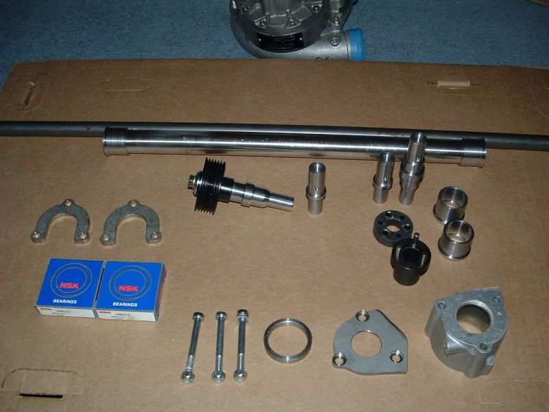

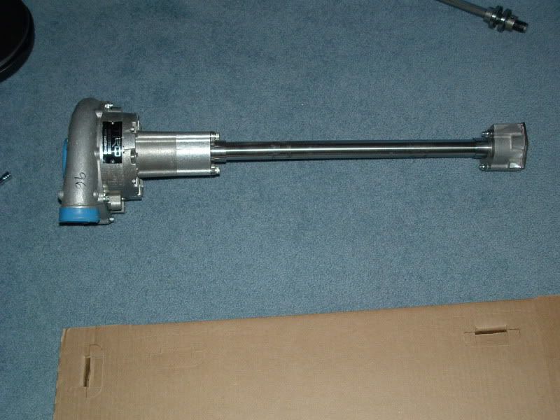

Old 02-08-2010, 07:05 PM   #87
O1GAGT
AKA: Phil
Join Date: Mar 2005
Location: Fort Wayne, IN
Posts: 1,107
O1GAGT Gettin' there
A few pics of the parts that I got back from the machine shop..... starting to come together.

nice build man...incase u were interested were having a meet in ft. wayne on march 21st

Thanks for the positive comments guys, I will have to wait to get the brackets finished and drive shaft legnth calculated once I get the engine and trans back in the car.
