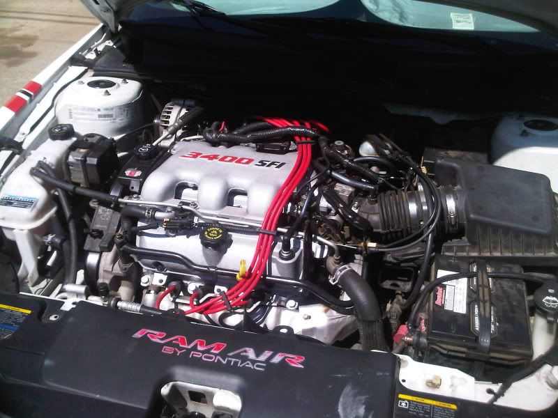

Minor problem, stupid mistake, but plenty fixable.
I have a small oil leak right at the ridge of the block on BOTH sides.....
So apparently even though the 3500 gasket set has the new ridge gasket. I drilled for it and installed it properly.
I FAILED to put RTV silicone at the edge of the ridge gasket against the heads.
I plan on tearing down in the next 3 days to fixxxxx... Whoo...

Yep, you still need to put a little bit of rtv in the corners where the gaskets meet. Actually I still recommend putting a thin layer on both sides of the middle gasket just to be safe, but that may be overkill.

I always put a thin line of RTV down the middle of the orange valley gasket and never had a problem.
I feel for you man, it sucks tearing down something that you thought you had done and out of the way. I have been there on more than one occasion and it is frusterating. The good thing is, I bet it will never happen again in another build. We live and we learn!

Are you going to reuse the torque to yield bolts? Why did you drill holes in the block for the nubs instead of cutting them off? I try to keep all my metal shavings away from my lifter valley

Drilling the ridge was no problem after Heli-coiling 3 rocker threads with the heads on the motor. -->Misfiring #3 After LIM swap
I actually cut about half the tabs off so I didnt have to drill 5/8" into my block. All the shavings from the block got caught on the magnetized drill bit.
I will clean and re-loctite all the LIM bolt threads, All the others should be ok.

The bolts are torque once and done.
Head bolts, ya.
LIM bolts, if Im not supposed to, I guess when it breaks its another teardown

LIM Bolts are as well. Thats why they sell replacements unlike UIM bolts.
The new bolts are, but only because they come with a pre-applied loctite that doesn't work twice if you reinstall the bolts. They are not like the head bolts where after you torque them once they aren't good anymore.
I personally never use those new LIM bolts. I always clean and re-use the old bolts with new red loctite applied. Done my own LIM probably half a dozen times and probably half a dozen more on other peoples cars. Not a leak yet.
Yup, same. My LIM bolts are original from 1999.
