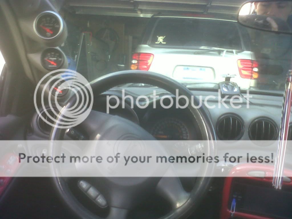

heres some pictures. ill have everything completely installed Saturday and everything working

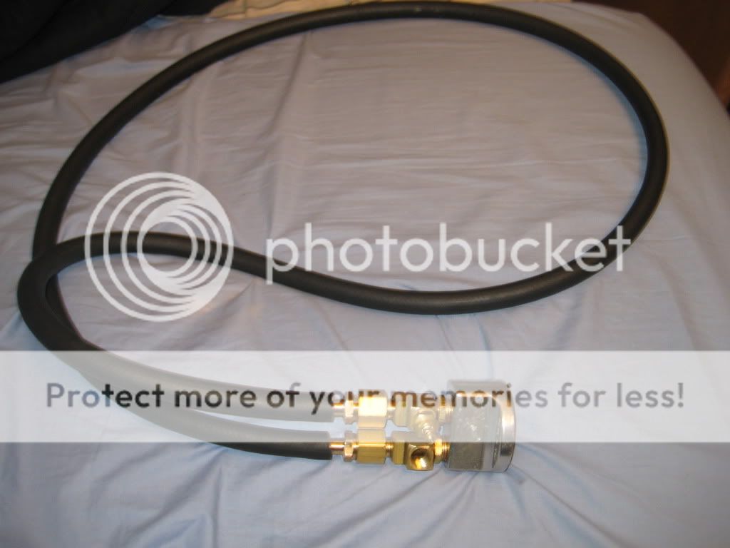

part of oil relocation kit
all the T-fittings, adapters and the oil temp sender, oil pressure will go on right when i install this

Old 06-09-2011, 03:48 AM   #15
whoa, your steering wheel looks better than mine did at 27k miles, and you've got 130k.
whats your secret????
My secret? well i wear racing gloves every time i drive the car......
jkk i have no clue i got the car with 107k on it and i dont know? i clean the car once a week interior and exterior
