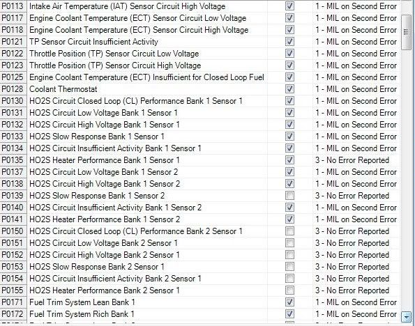

.... Since the header install I have been intermittently getting the P0132 code, and since I have an Areoforce scan gauge I can immediately clear the code, and in watching my O2 voltage output on the gauge the O2 sensor will immediately return to normal operation which means things are working the way they should and my wide band O2 gauge concurs that fact, then after a week or so under varied driving condition it’ll throw the code again, so any help with this would be greatly appreciated???
I got a couple O2 sensor codes with the TOGs as well after install, I would have to check to see exactly which ones. I set them to "no error reported," since there were no drivability issues. Not ideal, but nothing to worry about, in my opinion. Seems to be a by-product of the extra flow, or change from the heat retention of the stock manifolds and muffler system.
Edit: here are the DTC settings I use now
http://i493.photobucket.com/albums/r...h01/o2DTCs.jpg
Of course, check for intermittant wiring to rule that out first.

your P0132 code has the same setting as mine currently does...'MIL on second error'. I had thought it might be a product of the extra exhaust flow, or the way the flow was now routed, or the temperature of the exhaust flow, but I don't know. In watching the O2 voltage output on my Aeroforce scan gauge (and comparing it to my wideband O2 gauge readings) there are times when the voltage readings are fluctuating normally and other times where the voltage is up around 950mv and just stays there no matter what the driving condition, ..and, under either a rich, or normal condition, the wide band gauge agrees with what the voltage output of the narrow band is showing. and since I can reset the code through the Aeroforce scan gauge as soon as it appears and the O2 sensor will immediately then return to perfectly normal operation I was thinking of changing the setting for that code to 'MIL on first error' so I could have a chance to reset that code even sooner after the conditions arose to cause the code to appear and therefore also return to, and run in, normal O2 operation a larger percent of the time all together. But there has to be a better fix than that????? so to simply ignore the P0132 code all together wouldn't be good because once you're in a rich condition you'll be using a lot more fuel and either not know it or be able to do anything about it, because the O2 voltage output could get into a high reading and stay there, like the condition that causes the code to be thrown, and you wouldn't be alerted of it, and you can't reset a code that hasn't happened. still there has to be a solution??
