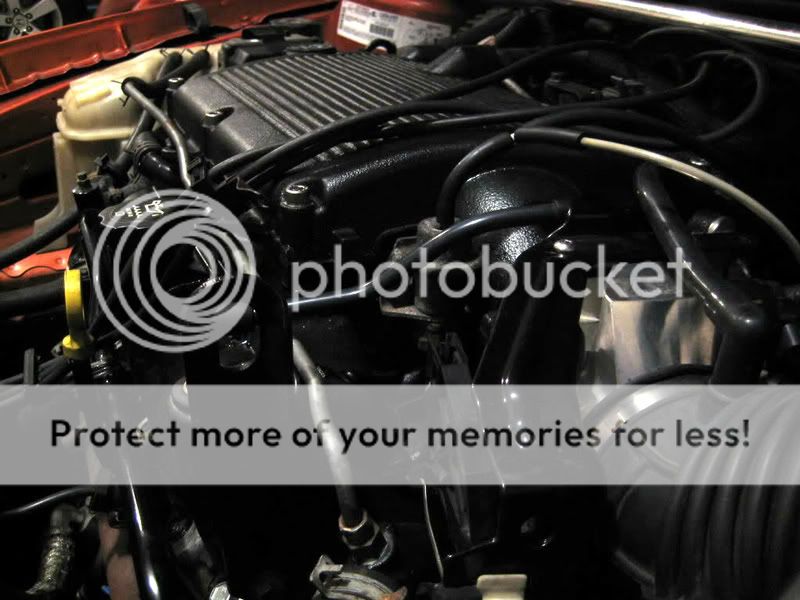

Started swapping parts over to the 3500 today. Fuel rail/injectors are in. When taking the 3500 rail off the ends of 3 of the injectors fell into the LIM....so we had to get a wire and fish them out....took about 40 min but we didn't wanna have to it off, reseal it...too much extra work for 3 little plastic pieces. Swapped over the thermo housing, engine mount, grinded off the 3400 sfi on the UIM and were gonna polish it so it looks nice under there Lots of grinding....we tried having a little fun and mixing the aluminum shavings with some rust (but the rust chunks weren't fine enough) to make thermite........didn't wanna light. Anyways....we were gonna swap over the harmonic balancer but it was getting dark. That, along with many other things will get done saturday. Hopefully sunday were dropping it in.
My 3400 uim has all kinds of oil on the sides....PCV valve was ****ed. . Gotta clean that and the TB out good.
OH YEA....the lower right bolt on the headers....PITA....had to wrench it out but for a while we were struggling to get it loose. It's in such a tight spot....we weren't even mad cause we felt bad for the guy who had to put them on (i took it to a shop years ago to get them installed). Finally got it after hammering on it a little to "break it free". Overall good day....coming along nicely.
billytheman1188 is offline   Reply With Quote

Given the time you spent grinding on the 3400 UIM, you could have easily used the 3500 UIM instead if you got the MMS swap kit. Adding the vacuum port is about the only work needed and everything else is plug-N-play after that. I guess I don't understand the value add of wasting so much time on using the 3400 UIM that offers lower performance over the 3500 UIM.
3500 upper will go on eventually. As of right now its the 3400....for some reason i think theres more involved than just adding the vacuum port. Also...it's kind of a waste to use the 3500 and then have the 3400 TB on....still decreases performance. Right now i'm not being picky....i just need to get the car back on the road. I can deal with the decrease in performance...i'm looking for reliability right now...not so much performance....yet
Eventually when i make a trip to ohio im gonna stop in to milzy and have him put the port and polished upper and lower 3500 intake manis on with a 62mm tb. Then he can tune right there....DONE.
Actually the stock FPR doesn't clear the neck on the 3500 UIM either so you also need to grind clearance on that. The performance difference between the two uppers is minimal. Most of the power gain on the 3500 comes from the larger displacement, higher CR, and design of the cylinder head ports. Not from the intake manifolds. Using the 3400 upper is just easier because... no modifications necessary.
Thats good to know (the performance is minimal between the two) cause i was a little bummed if i was gonna be losing a good amount of power....but like i said i just want this engine in and done! Most time consuming thing i've ever done to a car. Great learning experience though. The 3400 upper looks SICK polished....gonna be the only polished thing under the hood but w/e . Tomorrow were back at it!
The stock FPR does fit.

When everyone on 60degreev6 first started doing this swap, back before you'd even heard of this engine, they had problems with the FPR touching the manifold and had to grind out a tiny notch in the manifold to keep it from touching. There are obviously going to be differences from engine to engine in tolerances and such so maybe yours fit on there.... maybe it fits but it's touching, but it shouldn't. Looks pretty close to me.
You forget I've had this car and followed this scene about 4 times longer than you have. Think next time before you open your crap hole and reply with a little less attitude and a little more respect unless you want points.

It certainly didn't clear my FPR without extra work (spacers, grinding, unbolting the fuel rail and pulling hard).

That's exactly what I'm saying. There's a little bit of play in the position of the fuel rails and in the position of the UIM, and probably a little variation in the thickness of the casting on some manifolds. Some may just fit... some may not. Either way, even if it will fit you don't want the FPR actually touching the mani, so if it's close you need to sand/grind some clearance on the neck of the mani. Doesn't usually take much. I've seen the pics of it done.

No more grinding on the upper....just gonna slap it on there, **** it. No patience for it. Today we swapped over the crank pulley.....took us quite a while cause the teeth on his puller kept slipping but we got it. We put the pulley from the 3400 on the 5 and then we realized....****....the sensor........and we were just talking about it like 5 min before about how we gotta clean it. So....took it off again....wanted to bang my head against the wall. Tranny is un bolted....tomorrow were taking the 34 out and dropping the 35 in. by thursday it should be running. (mon tues wed we cant work on it). Kind of annoyed its not getting done this weekend but w/e.
