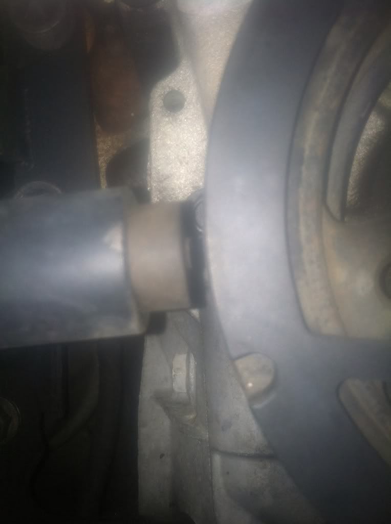

So I went outside to mess with the kit a little bit. I think I'm going to assume that the problem is that the sensor is too far from the pulley. I don't have a feeler gauge to measure the gap but I think I could probably fit a nickel in between there if not something thicker. Also the mount feels a tad bit loose. If I had to guess I would say it moves about .005" haha. I can't see it wiggle but I can feel it. So now I gotta go get some 1/2" allan wrenches because simple hex bolts would have been too easy for Milzy to use... Haha. So ideas on maybe getting the sensor closer? A hammer? Haha

I think we should try the 7x crank sensor ... question 2ksct does your car throw a battery code like on the intrument cluster?

Yeah it does every now and then. Sorry about the size but I uploaded I from my busted iPhone so I don't know how to change it

That gap is too wide. Think in terms of .040 spark plug gap to get an idea of the correct spacing. You should invest in a feeler gauge set...they aren't very expensive.
If the sensor feels loose, then it's going to vibrate while the engine is running which may contribute to the problems you're having. Did you apply any locktite to the bracket bolts when you installed them? If the bracket feels loose, then those bolts are going to start backing out over time.

Well that won't move it closer. If anything tightening the bracket more will probably more it further. Is there a way to bend it just a tad bit?

i moved it as close as possible mine had alot more space to give and that was the problem i suggest u drill out your bottom hole bigger so it can get closer mine runs like a champ now!!!!

^I'm thinking this may be the solution. And I also agree with starglow... get a feeler gauge set. They are cheap and you can use them for other things like checking spark plugs gaps too. Try and get the sensor as close as possible and see what the gap is. If it's more than the maximum gap they recommend, try drilling out the bottom hole on the bracket over size slightly to give you more adjustability. And I would definitely use some locktite on the bolts. The bracket shouldn't have any movement in it. You don't want that sensor moving around while the engine is running.

Problem solved. Let this thread die the most painful death a thread has ever died.
