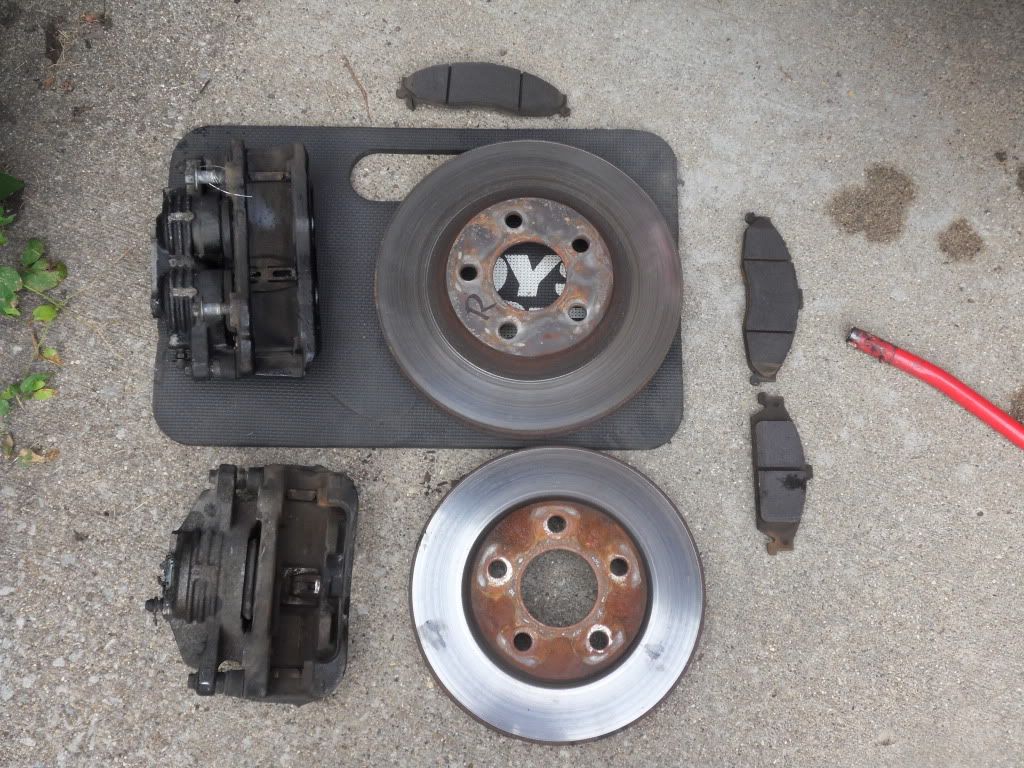

ok i had a differnt issue on each side.
the drivers side was simple one i realized what the issue was. if you buy a brake caliper from autozone the bleeder valve is open. i felt like a moron for not seeing that, but it was down river from the banjo bolt, and dripped off of it. tighted it up, it was sealed.
the passengers side was a little more tricky. looking at the caliper where the banjo bolt goes in i noticed the surface has a high spot. spent about 3 mins sanding it down, and same thing it sealed right up.
i dont think i have ever been more happy to have my car in working order again. i really thought i was have to buy 2 stock calipers, and call it good.
goes to show when you get so frustrated with something you just want to throw what ever is in your hand as hard as you can and then kill someone, that coming back when you calm down and looking at things with a clear head really helps. i was seeing red yesterday, today am very happy. thanks again for every ones feedback.
and the big question: does it stop better?
YES!!! pedal feel is really differnt, i have to use more pedal to get them to kick in. when you drive a car for 100k thats a big change. but when you want to really brake hard, my god! it stops on a dime. its probably the biggest change from any 1 mod i have done. . . .well other then subs.
and now for some pics
old
new

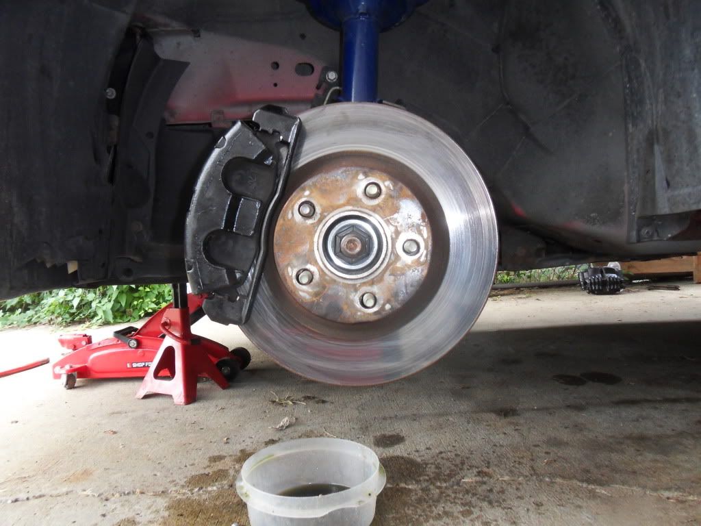

Your bleed screw needs to be at the top, the stock location on the f-body is on the car center side, while as you can see in our cars it is nose side. The way to do it is to flip the calipers around, f-body Right becomes grand am left caliper.

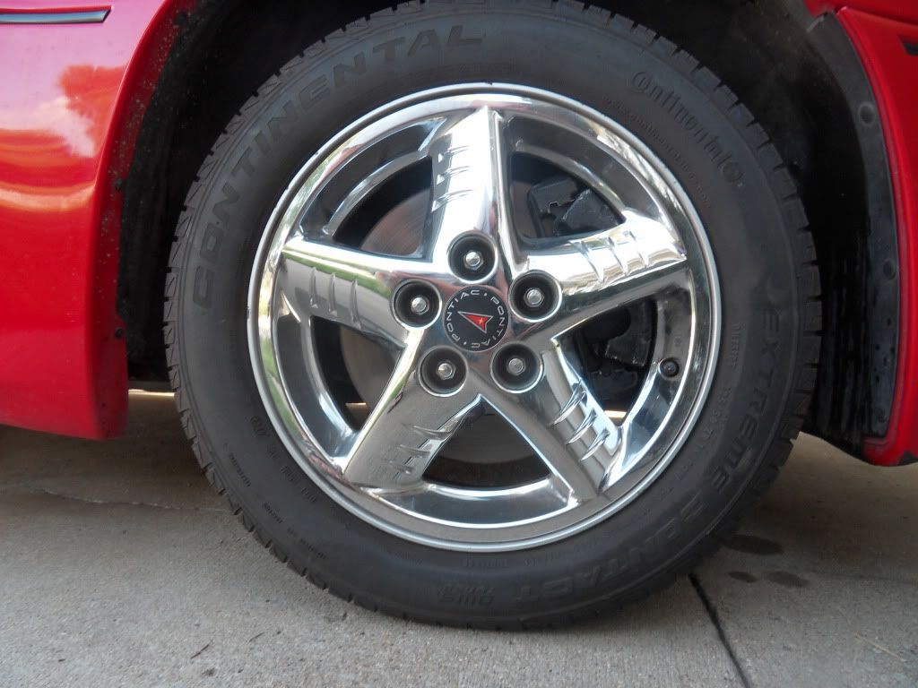

Okay, I didn't feel like reading through 17 pages of thread, but anyway will this mod work with stock 16inch star GT wheels?
Old 10-24-2012, 10:52 AM   #326
Try reading. That is the purpose of the thread. Read and learn!!!
Old 10-24-2012, 11:35 AM   #327
F body calipers will, Vette ones won't. If you have the "chrome" wheels, you'll have to trim a little of the plastic.

Also the corvette brakes and calipers will fit on the 5 spoke chromes if you sand down the chrome molding a little bit so it doesn't hit the caliper.

The vette and camaro calipers are the same physical size but the vette has raised (fins) on the top that can contact most stock 16's. A few people have been able (with slight modification for some) to use stock 16's alero is one example where nothing was required.
Really though 17 or 18 inch rim is the best way to ensure no contact problem.
