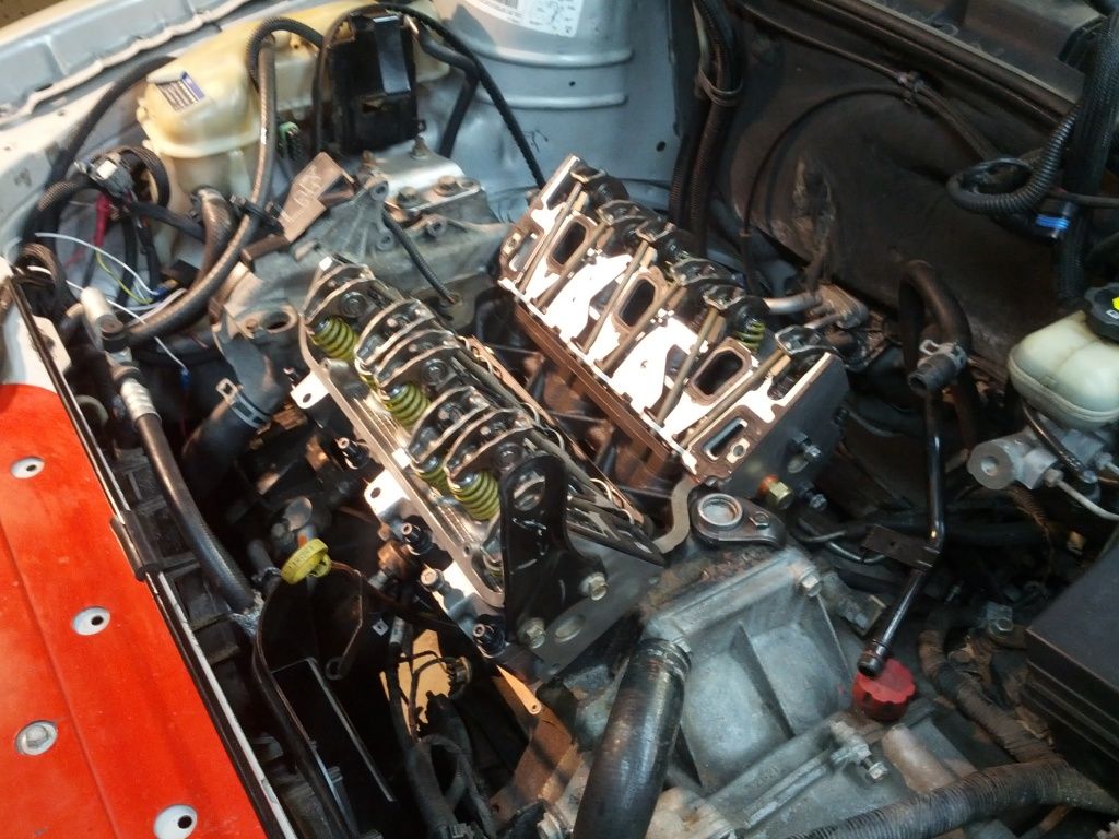

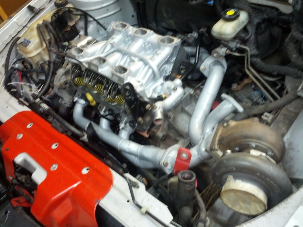

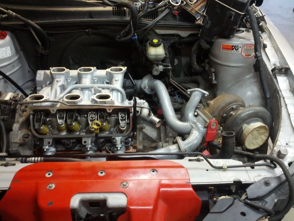

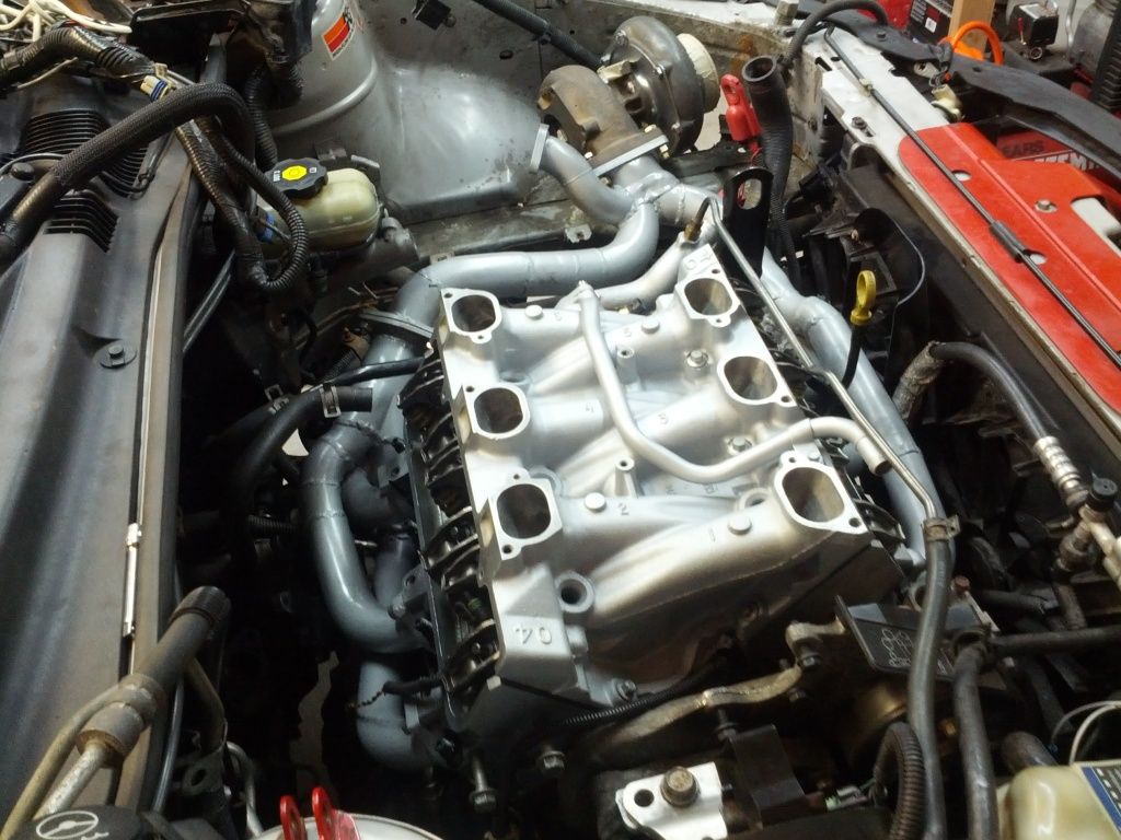

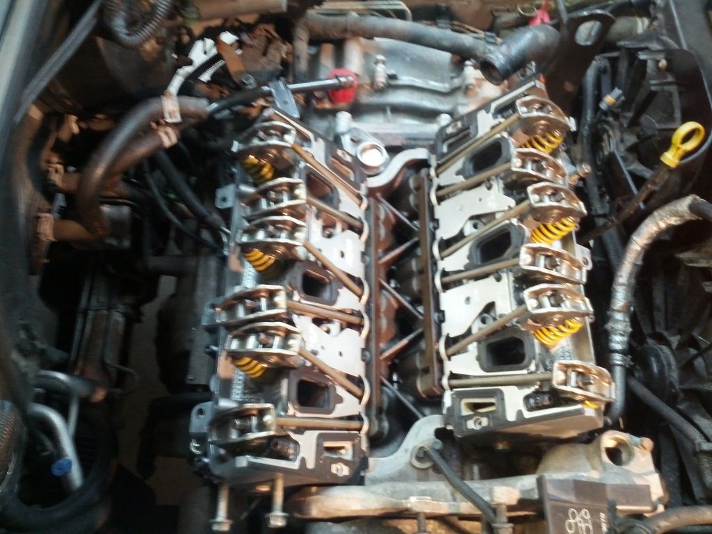

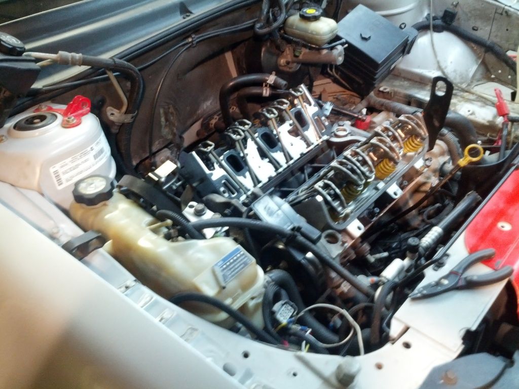

Just wanted to post some pics of some stuff that was done today. I installed the 3500 cylinder heads, and LIM. I also mocked up the turbo headers and turbo to see where I need to start placing and moving things. Sorry the pictures are from my phone and my motor is nowhere near cleaned up yet.

I would put some heat wrap around the master cylinder to prevent boiling brake fluid. ZZP's 3800 turbo downpipe gets that close to the master cylinder...that car was scary to drive fast because you had no clue if you had brakes when you got going...

Would I wrap just the brake lines or the whole master cylinder with this stuff?

That stuff is not meant for holding heat in. It is meant for reflecting heat, ie keeping something cool. I wrapped my fuel rails with it, and the stuff works amazingly well. I'm not sure how easy it would be to apply to something like the MC, but it would certainly keep it cooler. Maybe he could fashion a little heat shield out of aluminum and put the gold foil on that (it's adhesive backed). You can cut it into stripes and wrap it around things though too. I did that on the cross over pipe between my fuel rails.

WRONG!
Sounds like a good solution there.
But seriously, do something about that. Boiling brake fluid and not having brakes is the worst feeling in the world when you need to stop.

Just to give you an idea of how well that stuff works... before I wrapped the fuel rails, when the engine was hot I could put my finger on the front rail where you can see it under the UIM, and right away it would burn my finger. Now with them wrapped, I can put my finger on it and it's only a little warm. I can leave it there as long as I want.
DEI makes several other types of wraps and heat shielding fabrics that would work as well, to varying degrees. Some are like a fiber/nomex weave similar to header wrap, but adhesive backed and with an aluminized foil layer on the other side. Anything like that which reflects heat would help. You definitely to do something to protect the MC from high temps and keep the fluid cool.

I think that's what I am going to do is build a aluminum box around the MC and wrap it. I really don't have a whole lot of options with as close the downpipe will come to the MC. It's just another one of those things that you don't think of ahead of time until its right in your face.

All you may need is a alunimun shield and you could use the 2 bolts on the top of the rear manifold for a mounting position
along with what Aaron suggested should be enough
