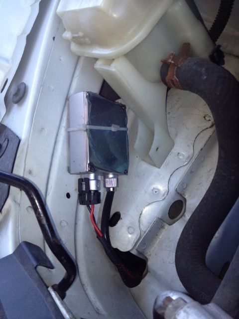

A kit is really Plug and play it u only got bulbs and wiring u are missing the converter!!! witch is not normal for a kit to not come with its simple plug and play and placing on your GT
as seen here this is what u need
