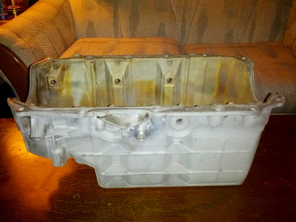

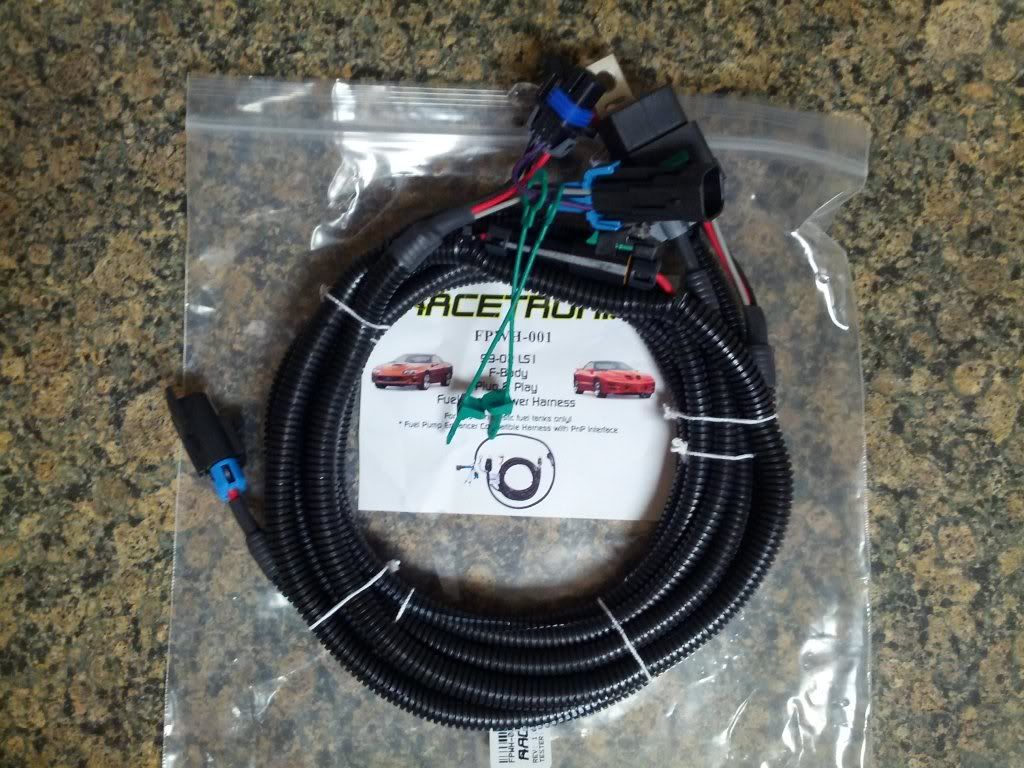

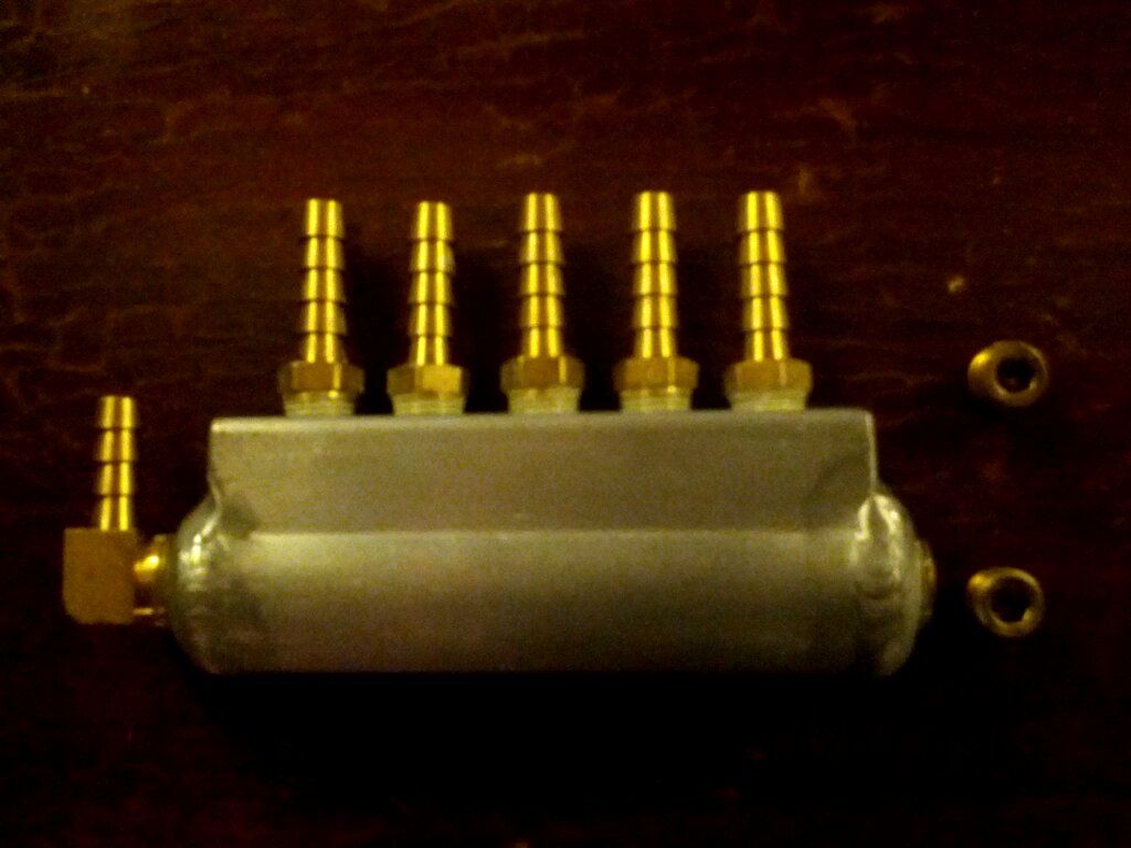

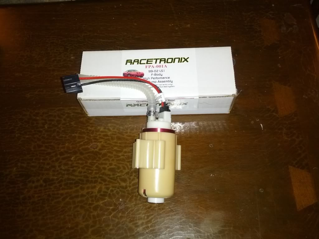

Got my new Racetronix fuel pump and wiring harness today. Tomorrow I am get my tapped oil pan, modified valve covers, UIM, 5 port vacuum block, and my intercooler with custom made brackets for mounting. I will post pics of that stuff when I receive it.

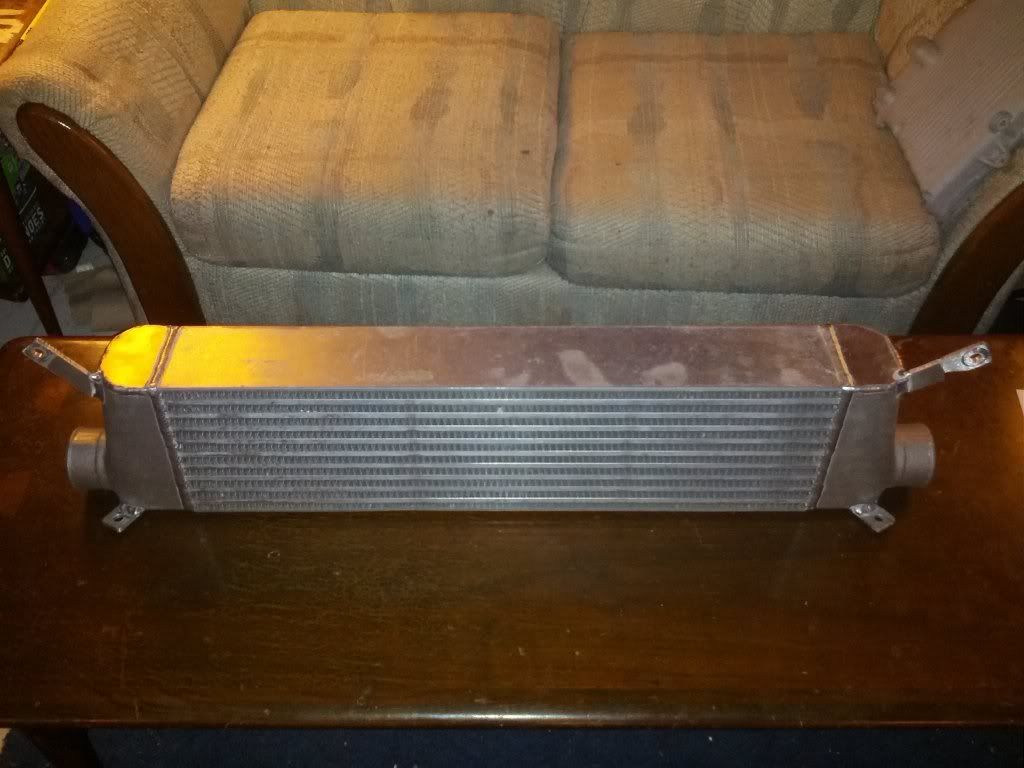

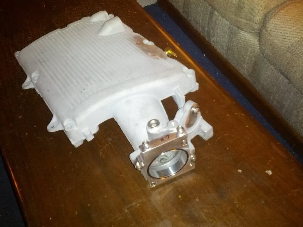

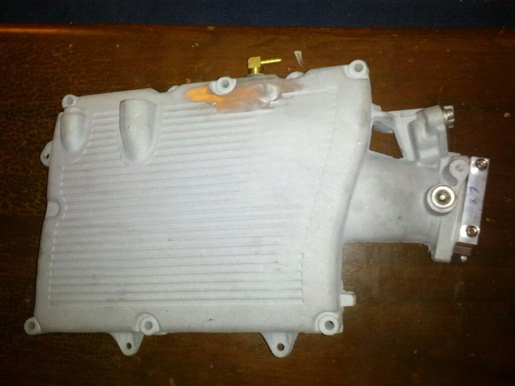

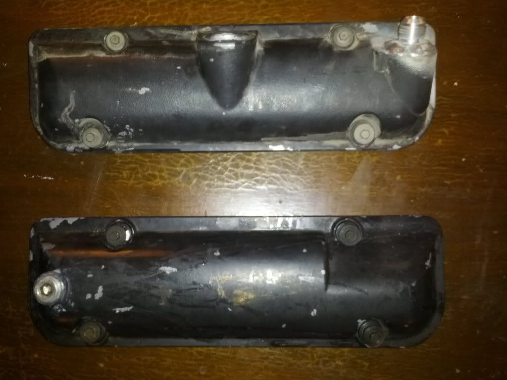

Well got my stuff back from Milzy today. I know these parts aren't clean I just wanted to give you a idea of what's been going on. Hopefully here soon I can start digging back in and getting this project knocked out. Life for me is just always so busy all the time its hard getting the time in that I need. I'm really hoping to have this done in the next few months.

What's with the plug in the rear valve cover? And the -AN fitting on the front? You do know you need the PCV in there to control the flow rate right?
The PCV is being deleted and I am using a breather in place of the oil cap. We had to plug everything off so it doesn't act like a leak.
2002 Grand Am GT Turbocharged
Old 02-17-2013, 04:53 PM   #87
Bad idea IMO, but your choice.
I am going to install a catch can off of the valve cover. I can if need be attatch it to the rear valve cover too. Those plugs can be taken out if I ever need them to be.

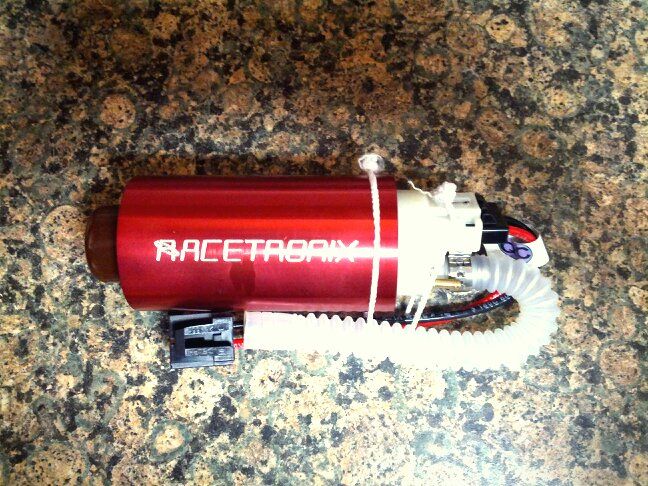

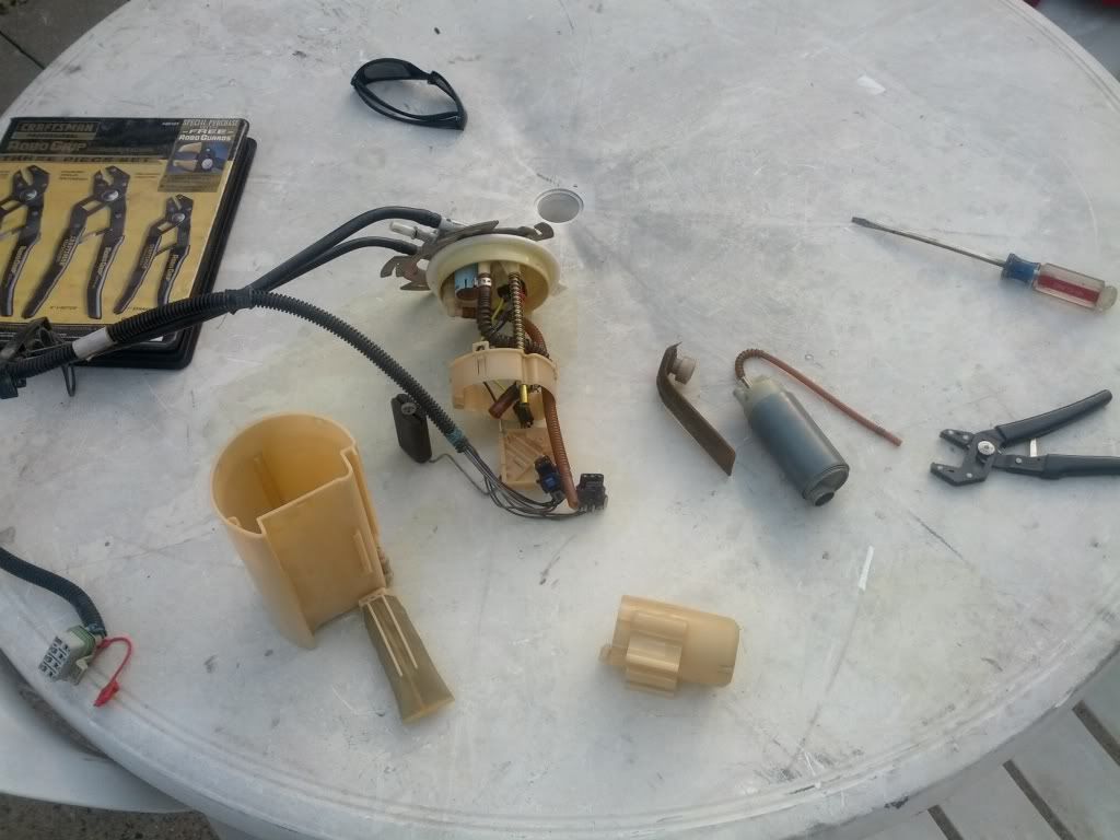

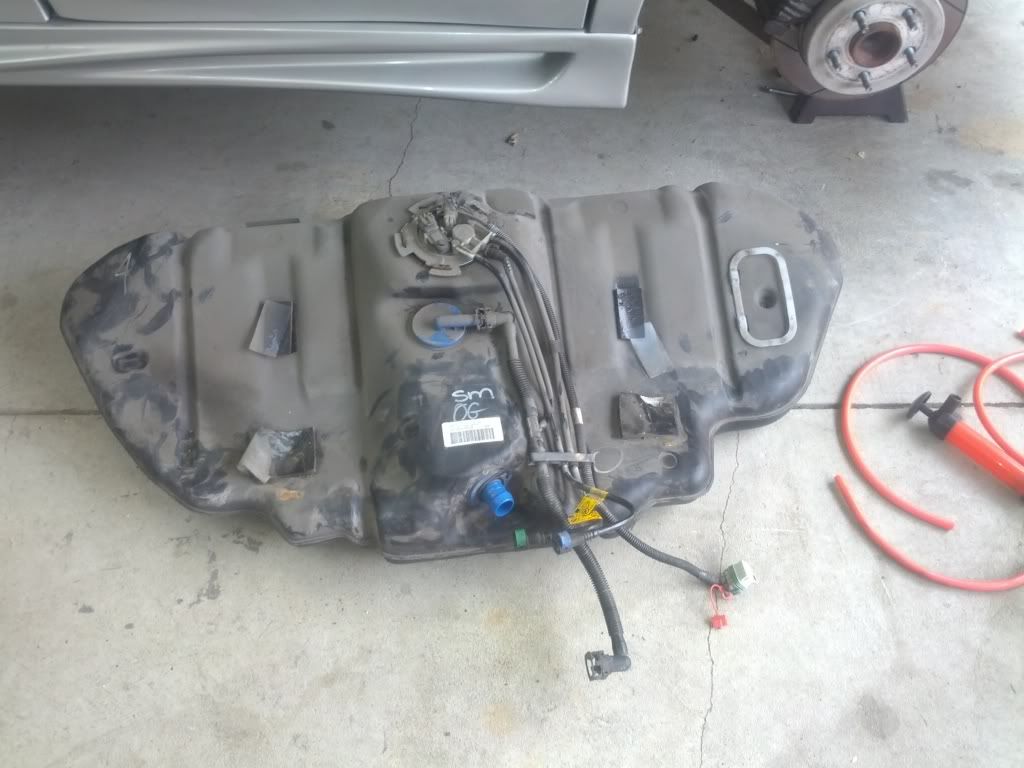

Well a small update. We got a near 70 degree day today so I did some work on the car. I pulled the fuel tank and fuel pump to get ready for the upgrade to the Racetronix 255 F99 performance pump. I have to do a little work to get it installed but it will work out just right.

I got the fuel pump installed to the holder. I will you this was not straight forward as it looks. I had to use my dremel quite a bit to get this to fit into place. I just have to find a new venturi tube.
