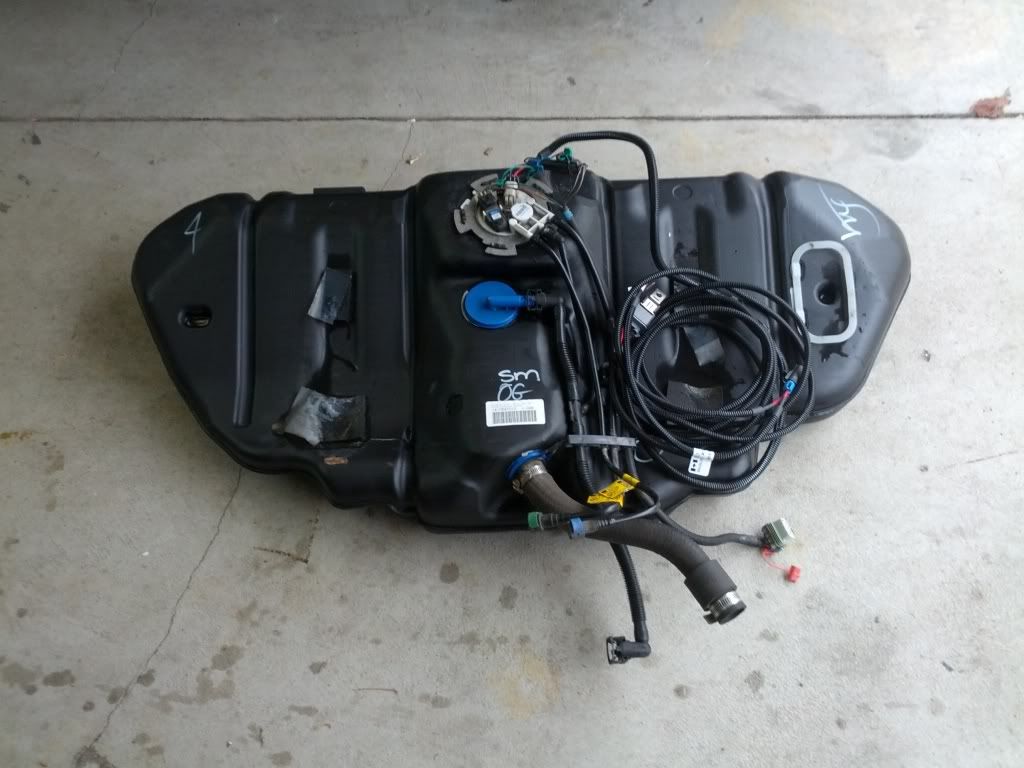

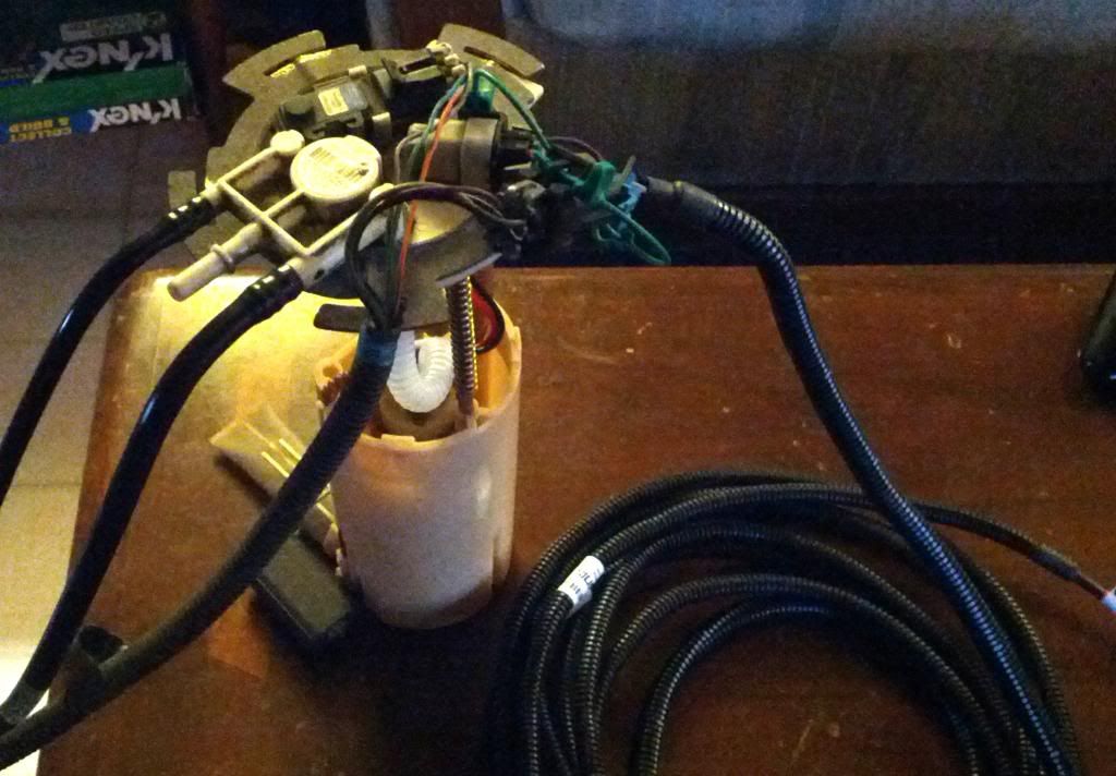

Well I got my fuel pump wired up and ready to go. All I need to do now is install the tank back onto the car and run the upgraded harness for it.

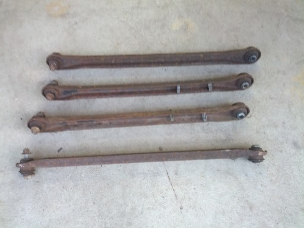

I decided to rip out my junk lateral link bars today. All the bushings were cracked. I already have brand new GP ones on the way. I didn't order the BMR ones because it would have been over kill and $300+ more. The GP ones I have on the way will be a good enough improvement for now. I already have Speed built sway bars.

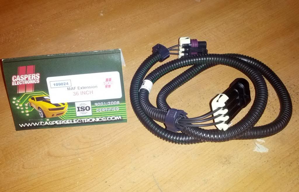

Very small update. I just received my MAF extension cable so I can move my MAF once I start installing intercooler piping.

Using stock or upgraded Maf ?
Using a stock MAF.

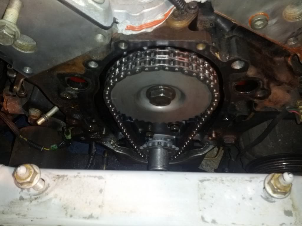

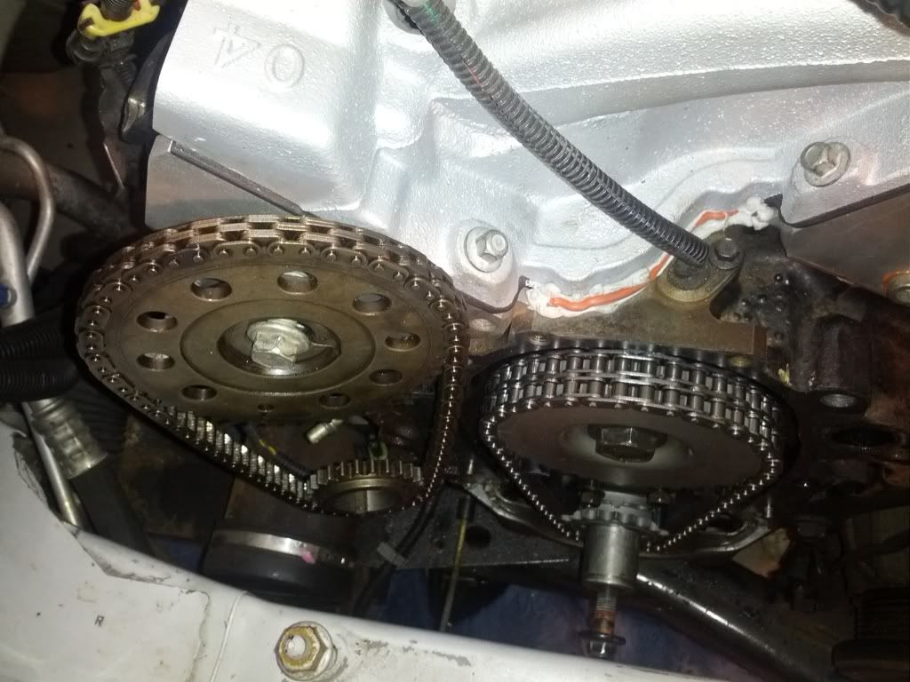

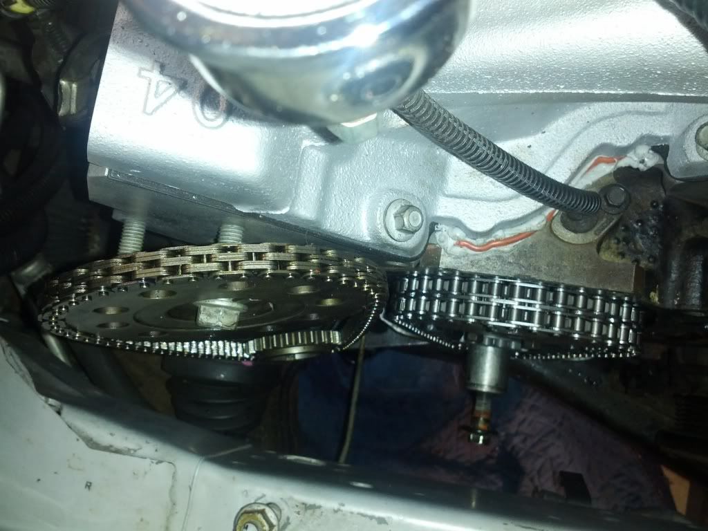

I installed my DRTC today. The pictures show it installed and the difference between the stock chain and the awesome DRTC. I couldn't believe how loose the stock chain was and that it was as small as it is. I will have more updates coming because I have a ton of stuff to install.

What did you do to clearance the crank in the car?

Yeah, make sure you've properly clearanced the crank and the front cover before installing that timing set. The crank snout has to be machined to work with that.

I dremeled the crankshaft and sprocket so it would slide flush. Once I had everything torqued I hand tightened the timing cover and checked if and where the chain would rub. Tomorrow I will grind on the timing cover to help with the clearance so it doesn't bind. I also grinded flush two plugs on the block to help with clearance of the chain.
