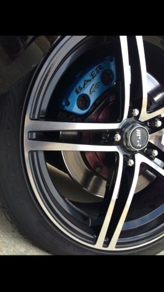

High Gloss?
For mine, I just used high heat engine enamel.
I did the bracket black and caliper a grabber blue color.
Old 04-20-2013, 07:39 PM   #37
Yes but high heat engine enamel has options like low gloss and semi gloss bro. Should be on the cap
Old 04-20-2013, 08:06 PM   #38
The blue is more of s matte type, and the black is like glossy.
Ehh well it kinda looks glossy, here's an idea.
and on car (if you kinda want an idea with engine enamel paint i used.
sorry its small, ill try to make it bigger after work.

Nice Nathan.
Old 04-21-2013, 01:18 AM   #40
thank you!
edited above post for a little better idea on car.
