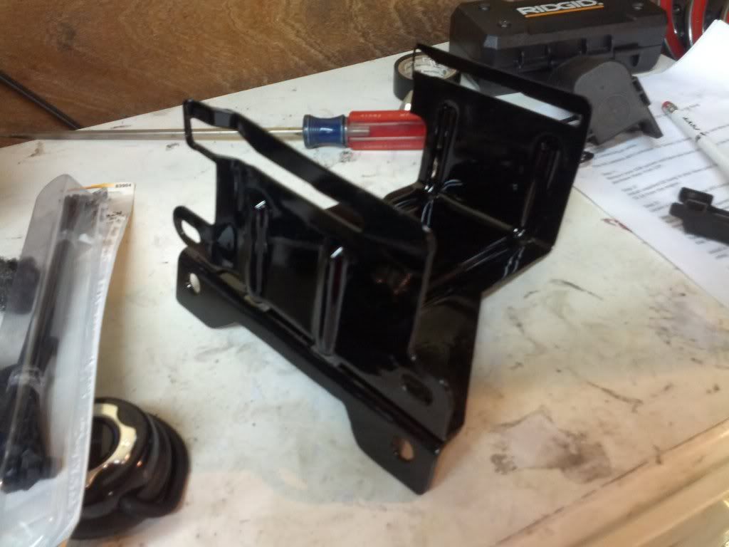

Here is a couple of pics of work I did last night.
Modified fuse bracket and powder coated thanks to Milzy.

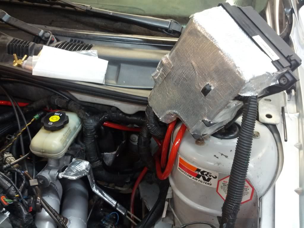

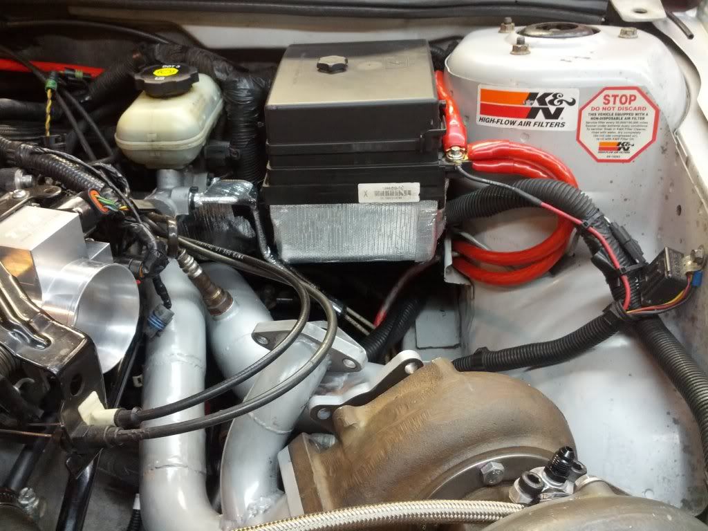

Wrapped the fuse box, master cylinder, and brake lines with heat shielding. This stuff works great and can withstand radiant heat up to 2000 degrees.
[IMG][/IMG]
[IMG][/IMG]

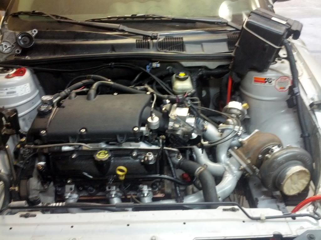

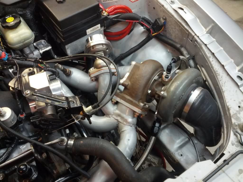

As of a hour ago the turbo is bolted in for good. All that's left to do is run some vacuum lines, and run the intercooler plumbing and fire it up.
