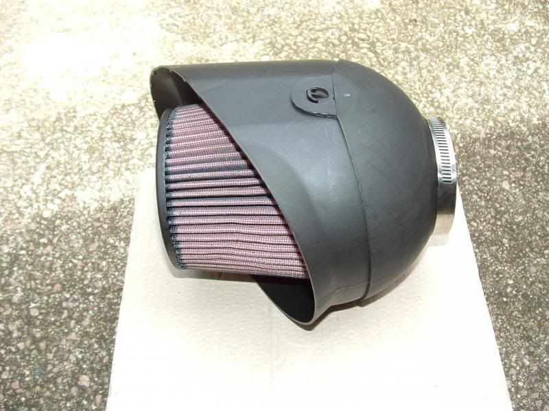

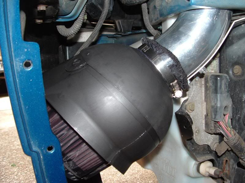

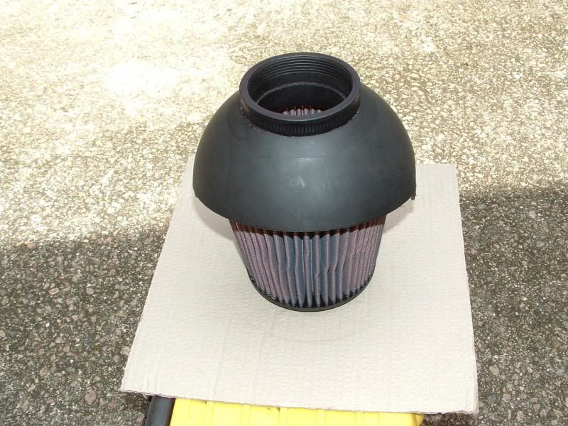

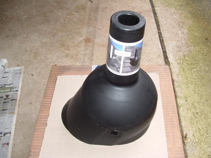

After having problems with water intrusion entering my CAI when it rains, I built this neat little water shield today from a roof pipe boot which was pretty simple. The shield covers most of the front side of the filter against water intrusion inside the fender. The remaining exposed backside will be covered when the fender well is re-installed.
Not sure how effective it will be yet but it's better than the few expensive plastic shields on the market. Originally I had the K&N mounted sitting behind the bumper so I pulled it back to where it is now. The Injen Hydroshield is just for added protection and to help keep the filter cleaner plus I already had in on hand.
Note: The K&N filters have a longer neck and the ebay filter neck is too short to extend through the top of the boot before bottoming out and may not work with this mod.
[IMG][/IMG]
[IMG][/IMG]
[IMG][/IMG]
[IMG][/IMG]
[IMG][/IMG]

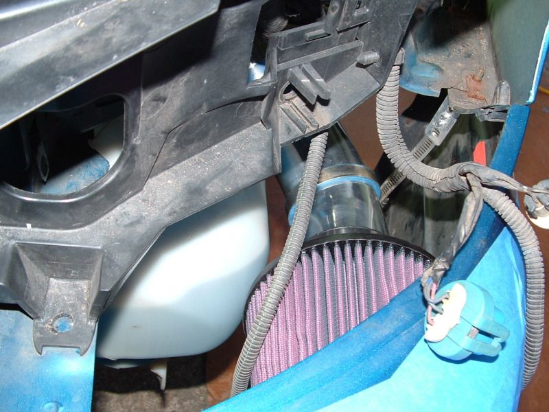

Here's how I originally had it installed so I think a lot of water was coming in around the headlight and fender openings up top and running inside the filter. The CAI tube actually had water sitting in it when I took it apart.
