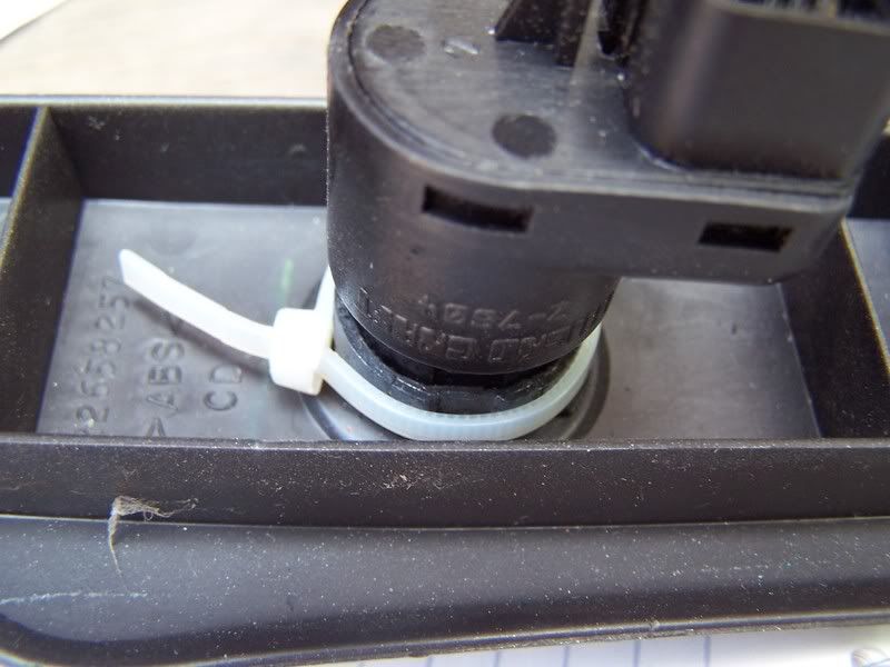

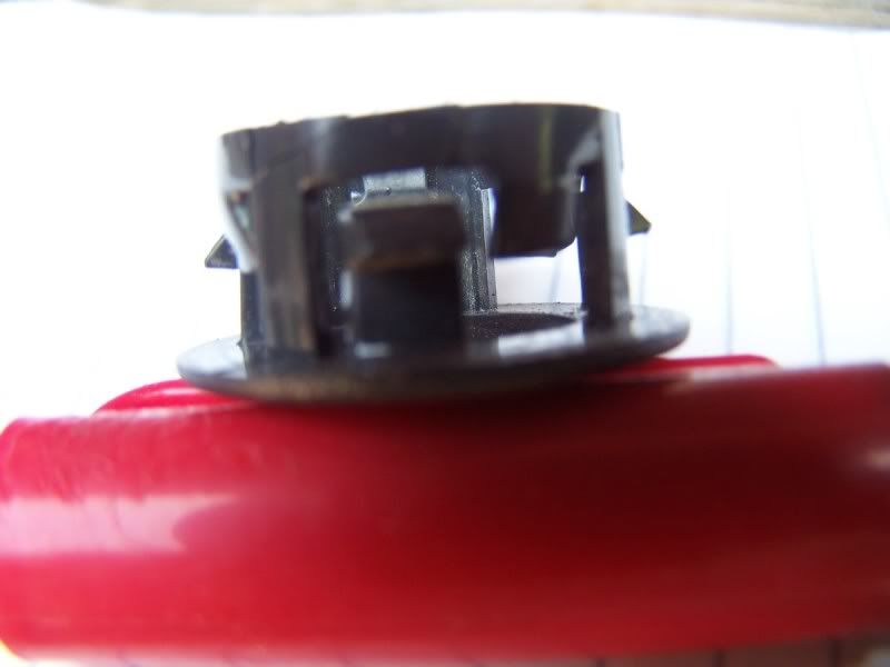

You probably can't put it back together. It started out as one piece.
This has bits of paper to show where it broke
I put a wire tie on it.
~Jim~
I'm going to have to try that Jim. I had a piece break completely off that's basically the size of where the paper is on your pics
The switch has a gangsta lean to it now...
