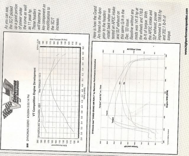

The biggest mistake most make in engine modifications is at the start.
After you decide you are not going to boost an engine, your very next decision should be selecting a cam profile. All part selections are dependent on the camshaft profile.. Valve timing is the overriding factor in what you want out of an engine.

Who was testing that AleroBBB? Surely that wasn't something GM actually did, was it?
Old 08-20-2013, 08:26 PM   #48
The magazine, "High Performance Pontiac," back in the day
http://www.highperformancepontiac.com/
After searching an old thread on here, I'm bummed out because I thought I had the first set of TOG headers made for the 3400, but the original set John (APOC) had were "nickel coated" not ceramic like I have
