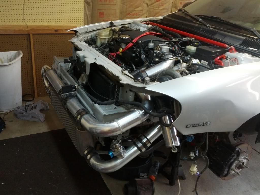

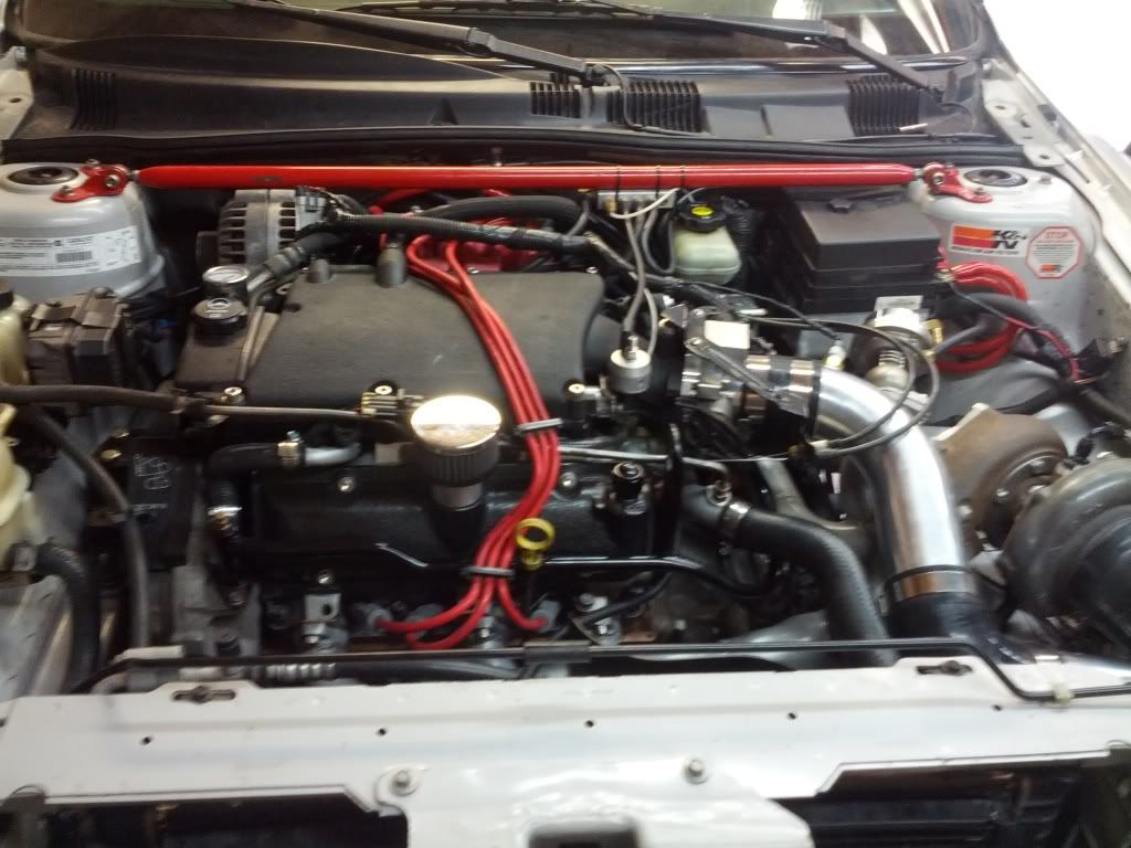

I will post videos of it as soon as I have it out of my garage and cleaned up. I did a little tuning to it today to get it ready to fire up but had somethings come up. Hopefully here in the next few days I will have it tuned enough to at least get it movable. Here is some pics though of it from last night.

Looks amazing man very nice work!

Fantastic man.

Not bad. The I/C piping routing is pretty good. Not too sure on how some things are going to work with how you placed them though. I mean, everything should work properly, but a couple things might not be "ideal".
With the space you are using running the piping from the other side of the I/C back to the engine, I think you could have just got a taller I/C with a divided core and both inlet/outlet on the same end. Not sure if those are readily available or if it would have had to be custom and/or cost you more money, but it would have given you more I/C volume and surface area with shorter piping for better response.
Also, it's good that the BOV is before the MAF sensor so things will read correctly and you won't have any fueling issues, but with where you placed them, you are going to have to take off your bumper or get under the car and remove splashed shields and stuff if you need to get to either one of them or adjust the BOV. Could be inconvenient. I would have made them more accessible. Also I'm not sure how placing the BOV before the I/C and that far from the throttle plate is going to affect it's response. It might have been better to place the MAF sensor in the engine bay and put the BOV still in front of that, but behind the I/C and closer to the TB?
Anyway those are my ideas. I think it should still perform very well though. We'll see when you get it started.

The welds on your IC piping look very neat! Your whole setup is awesome, you should be very proud.

Oh trust me I am. It came out better then expected. I took a lot of time and I paid attention to every little detail.

That setup looks super clean, keep up the good work.
