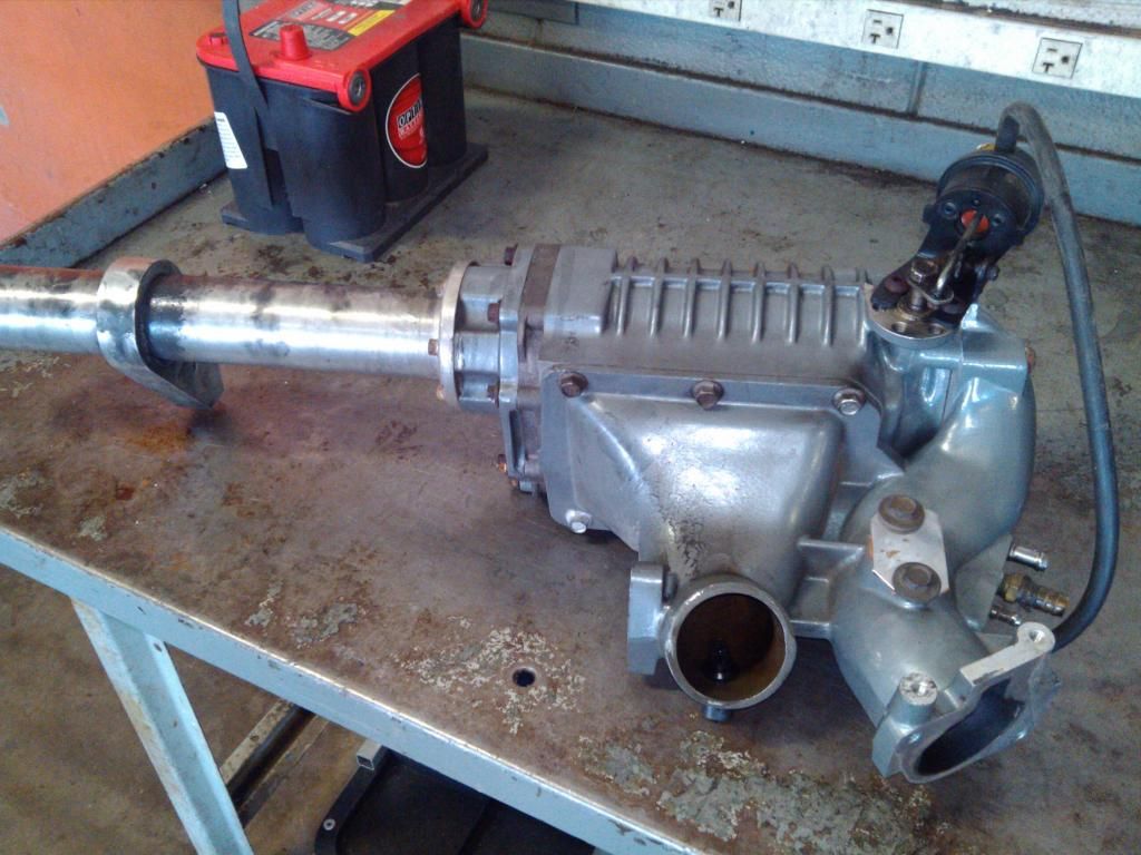

OK. Got everything put back in. The coolant hose just barely clears the bypass linkage, but it's noting like it was.
Casualties: 1 busted ring finger loosening one of the 3 bolts on the supercharger
Had an engine A-frame nearly fail on me when changing the serpentine belt, so I had to use a real engine lift, which meant I had to remove the hood to raise the lift arm and raise the car up on the lift to slide the legs of the lift under the car... So much fun..

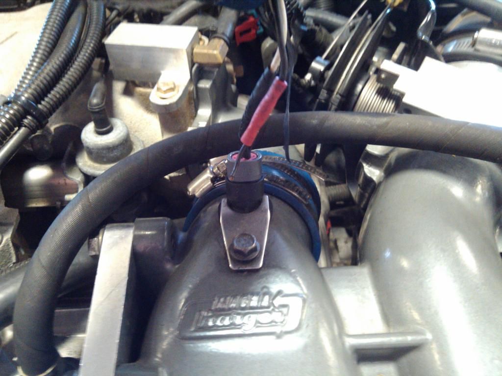

The "EGR delete" can be seen here..
The bypass

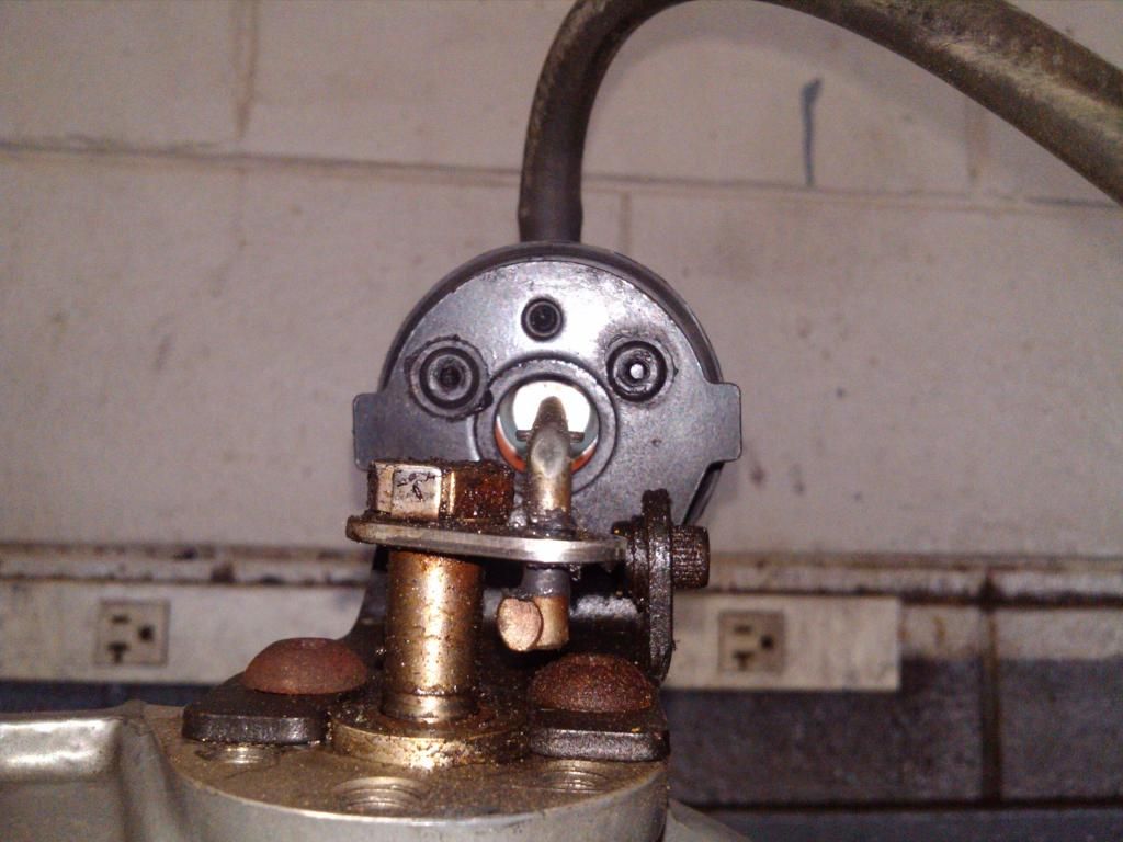

One other casualty:
The IAC sensor plug....
All in all the S/C isn't too hard to do, just a lot of unbolting..

Just get a new iac pig tail.

IAC is installed in the throttle body.
The sensor on the SC outlet casting is the IAT (intake air temperature) sensor.

got a pic? Yes there should be a sensor there. It's usually in the black rubber intake tube that is between the maf sensor and tb on a stock car. On the SC it gets relocated to the outlet and there is a small bracket that holds it down with a 10 mm bolt.
there should be a lead on your harness somewhere that will plug into that as well.

Sheesh.. A new pig tail from the stealership is $30+

Well, I don't think it was your only problem, but it certainly could have been part of it. The PCM uses the IAT for a couple things like as part of the calculation of air density for determining fuel needs, and for making adjustments to ignition timing based on air temp, so yeah it's kinda important for that sensor to be plugged in.

Ok, well if you had it plugged in, then that probably wasn't the problem. It's ideal to have it in the blower outlet, because you want the PCM to see what the actual air temp is going into the engine behind the SC, not in front. But as long as it was actually plugged in, the PCM would be getting some kind of signal so it wouldn't freak out.
