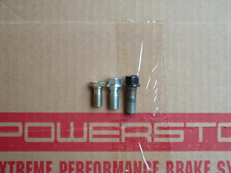

I have the Goodridge lines also but it takes a few weeks to get them after you place the order. I bought mine through Amazon for $118.
[IMG][/IMG]
Here's a photo of the bolt issue. The left bolt is the one sent from Goodridge with an incorrect thread pitch. The center bolt is the one I special ordered and the right side bolt is stock for the Camaro calipers. That bolt has the correct thread pitch but is too long to work with the Goodridge lines that have a thinner banjo so you need shorter bolts like the one in the center..

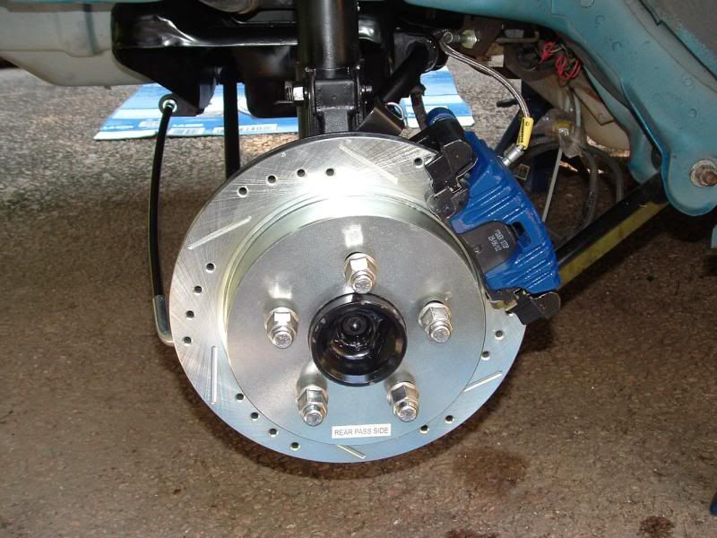

[IMG][/IMG]
As installed on my GA....
[IMG][/IMG]

If you do the big brake upgrade like I did, then the stock Camaro caliper banjo bolts are too long for the Goodridge lines as seen in my photo, so there's no way they would work in this case.
