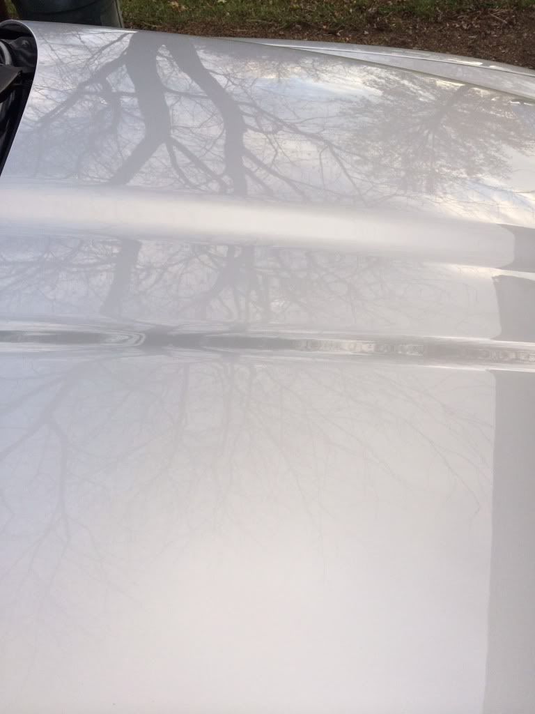

i dont know what it was about the megs #7 glaze, but when i left it to dry, even spraying QD on it and using a MF towel it was still super hard to wipe off.
LEARN FROM MY FAIL. +30 minutes to wipe a product off of the car.
i had been doing my parents envoy suv, but not even halfway through they're talking about trading it in, so i just glazed the remaining panels. the m105 did wonders on the deep scratches on the hood. the rear bumper was messed up pretty good and i was looking forward to getting some before/after pics of it, but thats not going to happen now.

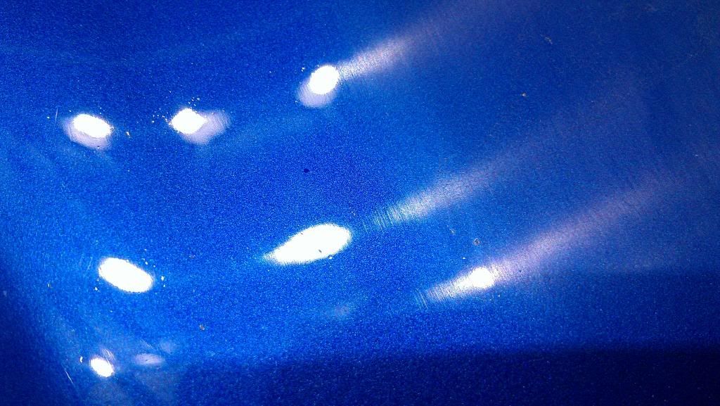

anyways, time for a pic. i found some 3ooo grit trizact 3m wetsand paper. hit up the ole' subie fender for some more leveling and hit a new problem.
after i buffed with m105, i still had visible sanding lines in the clear. look at the light bulb reflections. the part on the right had not been buffed yet, but the part on the left with the lights has been buffed with m105 on a yellow pad. didnt have this problem before with 2k grit and an orange pad. very confusing

yeah that is weird. try to buff it again with the yellow pad and m105, see if it makes a differnce

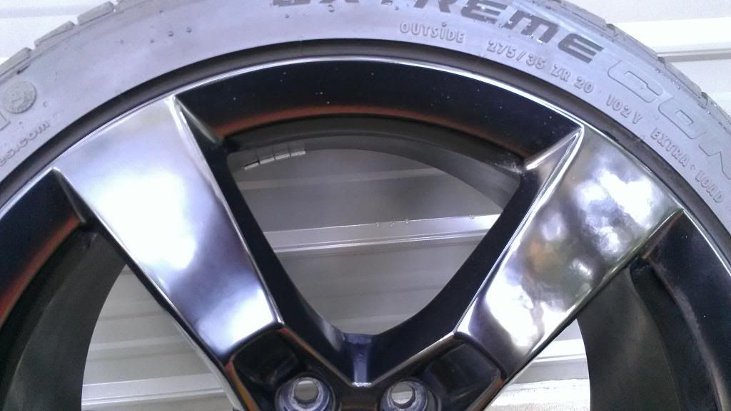

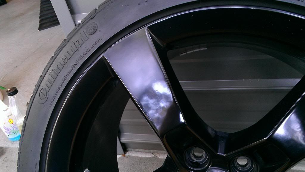

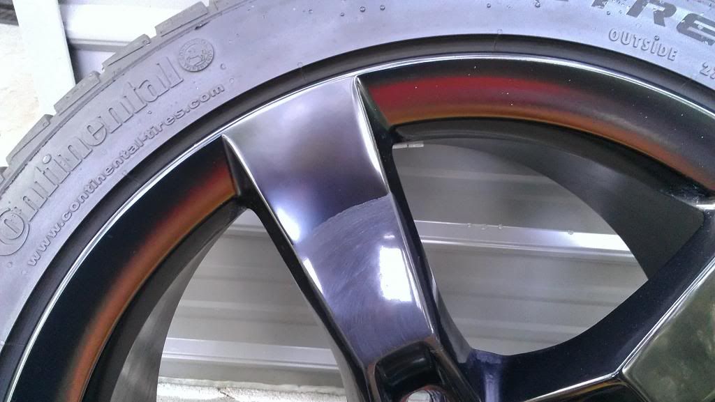

david, stewartfn18, gave me some wheel glaze from the dp brand, or detailers choice? anyways, i couldn't believe the difference it made on the black rims!!!
spoke on right was glazed, left was clean but not glazed. the finish is called matte black, and they're in perfect shape so far. in the unglazed condition, that's exactly how they looked when they came out of the box.
applying glaze to bottom half of left spoke.
top half is unglazed, bottom half IS glazed! big difference.

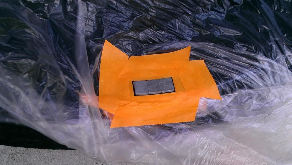

how bad is your Obsessive Compulsive Disorder? i cant stand having silver wheel weights sticking out like a sore thumb on a black rim. i sprayed this one, but i'm going to get some hobby paint brushes and dab it on the rest.

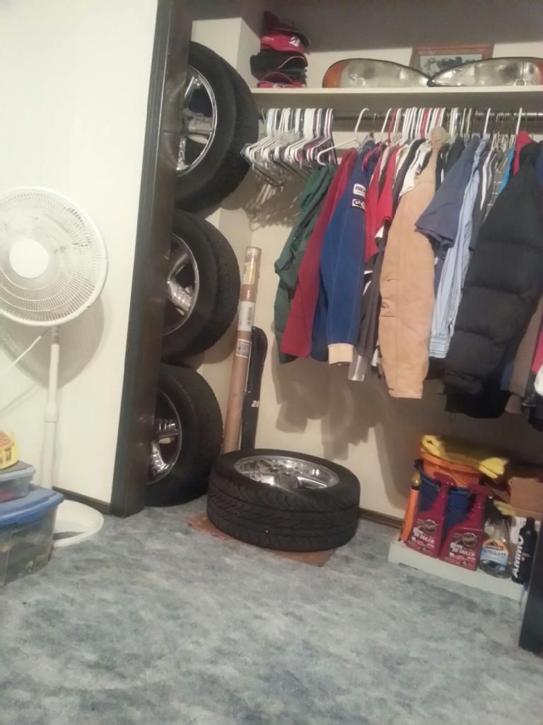

Anyways, I cleaned the fk outta my room and now my closet can be useful. Removed the closet doors and found a place to store my wheels for the winter
Old 11-11-2013, 06:40 PM   #147
A+ for ingenuity!!!

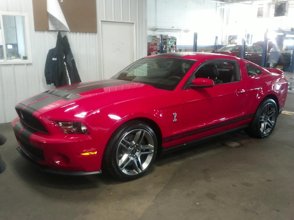

here is a detail I did at work today. 2010 Shelby mustang I had roughly 7 hours in it but it turned out really good
swebster is offline   Reply With Quote
Old 11-15-2013, 09:39 PM   #149
what all did you do? paint correction? what products did you use?
you've come to the right thread!
I did a full detail interior and exterior. inside I used a citrus all purpose cleaner for the panels and carpets which wasn't really dirty at all. On the exterior I used 3m machine polish followed by 3m ultrafine polish. sealed it with 2 coats of blackfire wet diamond.

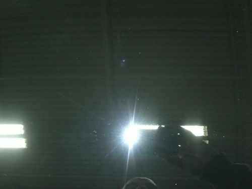

Got to use my DA finally did a meg UC UP and carnauba wax feels nice but still need some work with the DA saw a few swirls when I got home tonight. What type of light do you all use when looking for swirls?
if you've still got swirls after UC, maybe press harder with the DA, and do 6 slow passes. but if they're scratches, and not swirls, you've probably got to get a tougher compound, like m105. the UC should knock out all swirls, but it can't fix scratches.
my g8 has deep random scratches all over the hood and trunk, b/c of previous owner lubricating their car-wash brush with sand and dirt. pay attention to how you've been washing the car, so you won't have more scratches in the future.
i usually have a clip-on light on top of a ladder while i am using the DA. after i wipe the section off and i'm ready to inspect, i hold the light as far away as my arm can, so i can inspect the reflection, and i move the light back and forth. also try moving your head/eyes closer to the panel, and at an angle. example: if you're checking the front fender, then have your head back near the door while the light shines perpendicular to the fender. -but that's only if you're totally nuts about a flawless clearcoat like me.

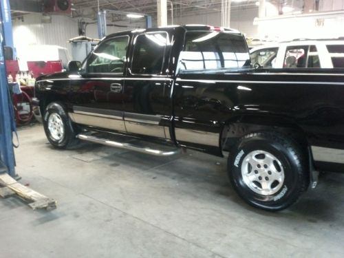

2004 Silverado hood
-before
-after
-side view of truck

the best light to see swirls in is with a halogen light like this one
http://i.walmartimages.com/i/p/00/01...05_500X500.jpg
however, direct light with a light bulb, or flashlight will work
