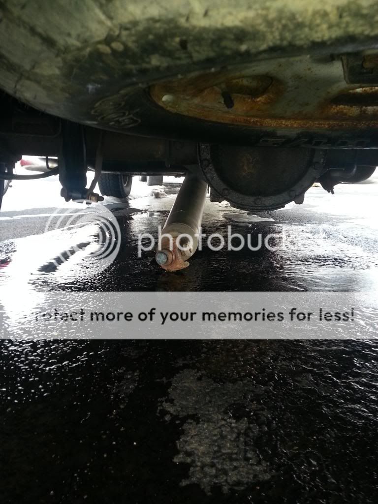

Welp, I was headed home after my final on Friday, it was around 7:45 p.m with about a three hour trip ahead of me. I got about 45 minutes out of Carbondale when my drive shaft slammed to the ground (going about 60 mph). I was stranded there for about 10 minutes until someone stopped to help me out. The guy actually used to live in my home town at one point (small world). We sat there for about an hour and a half waiting on the tow truck to get there. The guy kept me company the whole time, trying brighten the mood a little bit. Anyway, my friend came and got me from Mount Vernon that night. Got home around 3:30 a.m. My parents had hopped on a plane to Florida around 7:00 p.m that night as well. Here is a couple pictures from that night. Moral of story, there are still some good people in this world.

Twisted the yoke right off? Damn that sucks.
Old 12-16-2013, 01:35 PM   #5218
shoulda put it in 4x4 an limped it to nearest store
Nearest store was 20 miles away. My insurance covered the tow to the dealership. They are looking at it now, and I should be getting a call with a quote. I'm really hoping its under $1000.
Old 12-16-2013, 02:09 PM   #5219
With it being dealer... good luck.
Old 12-16-2013, 02:09 PM   #5220
From a dealer? hmm maybe.
Should go to independent mech even getting a new rear diff wont cost too much figure couple hundred plus labor.
