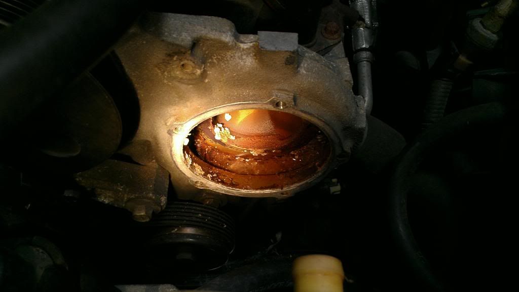

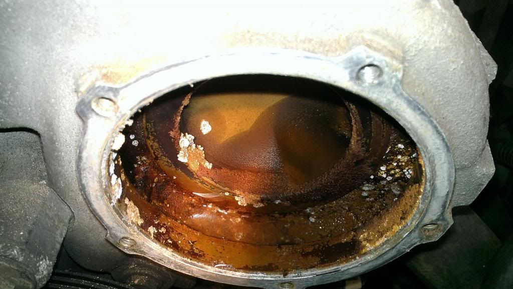

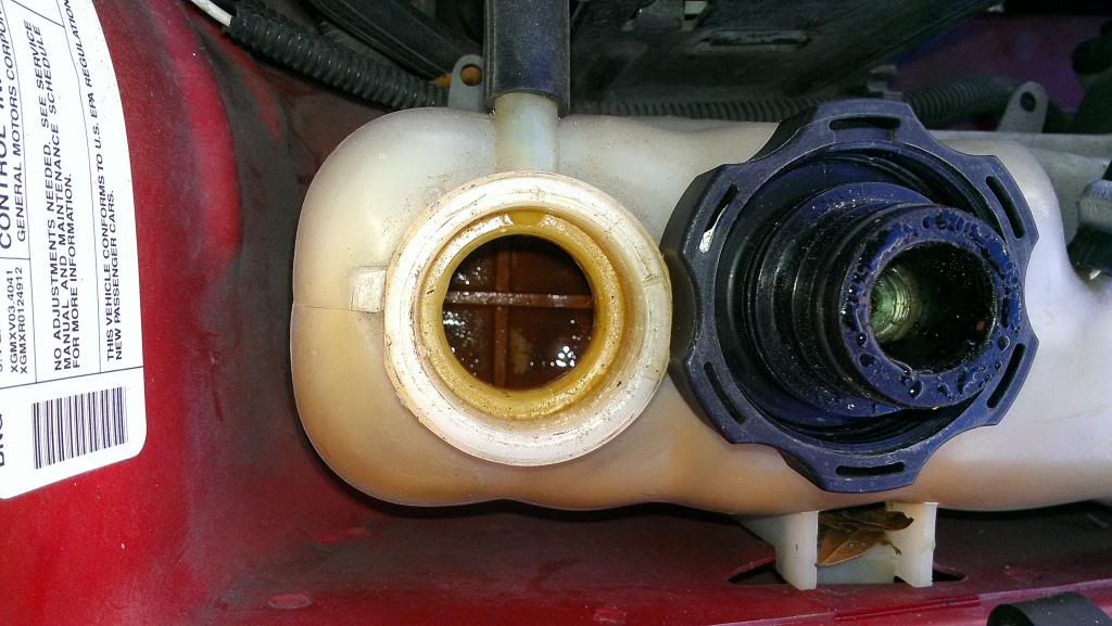

walked out of advance auto and saw this! i walked right back inside and said "okay, who has the gto?" spent 10 minutes talking and listening to each other's cars.
grand am's water pump was getting loud. bearings were shot, but it wasn't leaking. but when i pulled it off, i expected water to run out. THE FRIGGIN THING WAS DDDDDRRRRRRRYYYYYYYYY
And the coolant resevoir was empty too. So i'm thinking i've got a coolant leak AGAIN. i put the new pump on and filled it with water and let it idle for 20 minutes. Never saw a drop of water run down the block or drip off of anything. but i do see a trace of oil between the rear head and block.
also, i thought that when i filled the coolant tank up and let the car run, it would pull water out of the tank. But after 20m i unscrewed the lid and coolant shot out the overflow tube.
My temp gauge has been working fine. and i didn't ever get a low coolant warning light like always before. oil looks clean. only put 10k on it since the head gaskets were replaced.
the car sits outside in the grass, so i wouldn't notice a coolant puddle.
