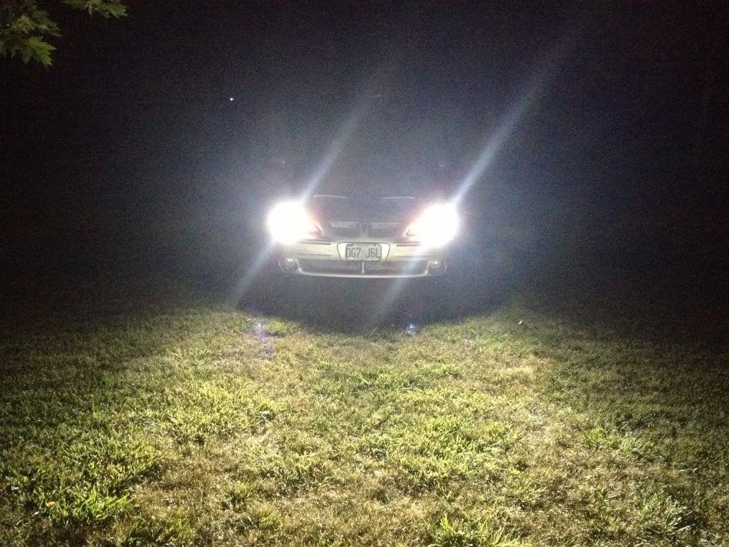

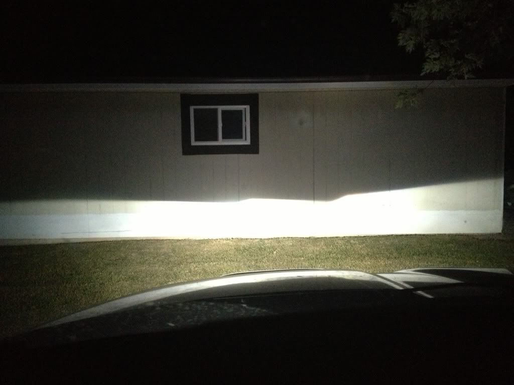

Yes I know my cutoffs are crooked... Another reason I'm going to be redoing it.
Old 12-26-2013, 11:18 AM   #115
Second picture looks like they're aimed a little high.
Doesn't the projector only go in a certain way. As in, it has 4 screws to fasten it down and then a locking/threaded nut/shaft on the back side correct? So how is it possible to get the projector crooked?

They were aimed a little high. But the driveway makes it look worse than it was since it slopes down quite a bit. Also the aftermarket projector housing I used didn't have anywhere for the threaded shaft to mount to so I had to come up with my own. I used the original holes from the crappy projector that was in there and then drilled 2 more for the bottom. It should be much easier to mount them in the stock housing since I can use the threaded shaft. As far as I know that's all that is necessary to mount these.

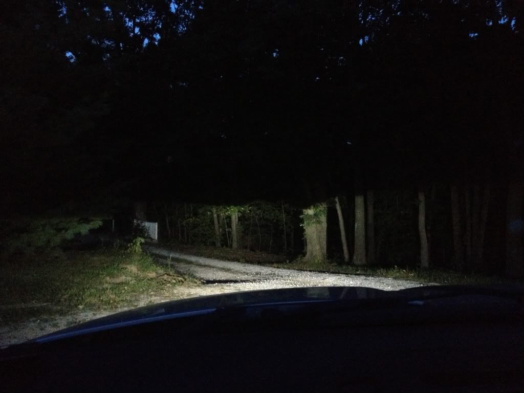

There where better pictures posted on the 3.0s but I really would rather see road pics then wall pics. Seems like 95% of output pics are on the ceiling or walls
Still leaning more towards the 2.0s. Like I said though, its really a win win, if I wait till the 1st and see 3.0 road shots and dislike them I can get 2.0s at a discounted price. If I like them I can get the 3.0s since they'll be out.
