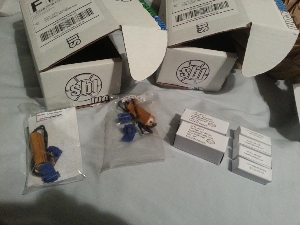

Meanwhile I got some goodies for once I do the retrofit, changing the front turn signals all to amber LEDs. Probably will install them Sunday since its supposed to be 55 degrees and sunny.
Total bill $90 . Nothing compared to the $190 bill that it will be to convert my rears to LEDs.

What u get and from where
Old 01-08-2014, 07:51 PM   #190
The boxes don't give it away? Gottem from superbrightleds
Got two 45 SMD LED 3157s:
http://www.superbrightleds.com/morei...led-tower/903/
four 5 SMD LEDs for the sides/inners.
http://www.superbrightleds.com/morei...se-tower/1127/

Let me know how you like those 3157 bulbs I need some new ones. Mine are only forward facing so they reflect off of nothing and some are burnt out since I got those from oreillys. Also let me know how those resistors work out. Mine will occasionally shift off their contact and give me a fast blink. I might try and find one that is like a pigtail that plugs into the old bulb socket and has another bulb socket on the end. Either that or just solder it on.
Old 01-08-2014, 09:03 PM   #192
Make sure you got 6ohm 50watt resistors and make sure the splice went all the way through. I don't know what route you went with resistors. I don't buy the mumbo jumbo that claim bulbs have a built in resistor.
These 3157s should be really good. SBL says the 18 and 45 SMD LEDs are the brightest LEDs they offer.
Hopefully the 5 SMD LEDs will fit, I test fit it on my old lights and there is like 1/32" space between the reflector and the LED
