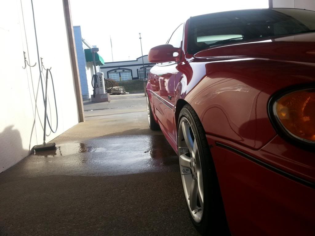

I think your tire looks beefier with the BBS's for some reason.
Personally think its fine as is, wouldn't change a thing for a while.
Old 02-15-2014, 11:23 AM   #63
Thanks tanner. I think the 8 inch wheel helps that... but they are slightly stretched. Not like honda stretched. But its noticeable. I wasnt aiming to stretch them but I also wasnt going to buy new tires when these have tons of life left. Plus I love these nitto tires.
Old 02-15-2014, 11:42 AM   #64
If you where to put a percentage on stretched it would be 1%. I have the same tire and width. Only noticeable if you stare at the damn things without moving your eye. They're EVER so slightly. I would say its barely noticeable to the normal person.
I felt the same about my tires, if I still had my wheels but no tires I would of gotten 255/35 Michelin pilot super sports for lulz so the spacer wide stance would look better. It doesn't look funny atm but would look better with 255s. Not to mention I got tires with barely any miles on them so..
Regardless though a 225 is still a decent enough square stance with enough lip to protect the lip of the wheel. But then again the type and brand of tire you get will be wider then the other.
