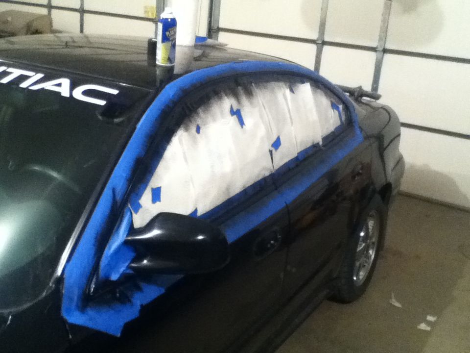

Old 02-28-2014, 04:08 PM   #6386
but what about the glass. please tel me you taped off the glass unless you want to spend hours with a razor blade scraping the over spray off.
the tape job itself isn't bad but over spray is a bitch.
Old 02-28-2014, 04:16 PM   #6387
He used plasti-dip. The can is on the top of the car. The plasti-dip should just peel or rub off

I beat sleepy to it.
Not tryna be a ****, but it looks like you're spraying way too close. Hold the can about a good 8 inches away from what you're spraying. The final result will be much smoother!
plasti-dip or not it would save time in the end. it would take far less time to lay some paper down than to sit there and remove the over spray from that stuff.
Old 02-28-2014, 05:48 PM   #6390
Thanks for the tips guys. I am re-taping it now. And I will hold the can back a ways.

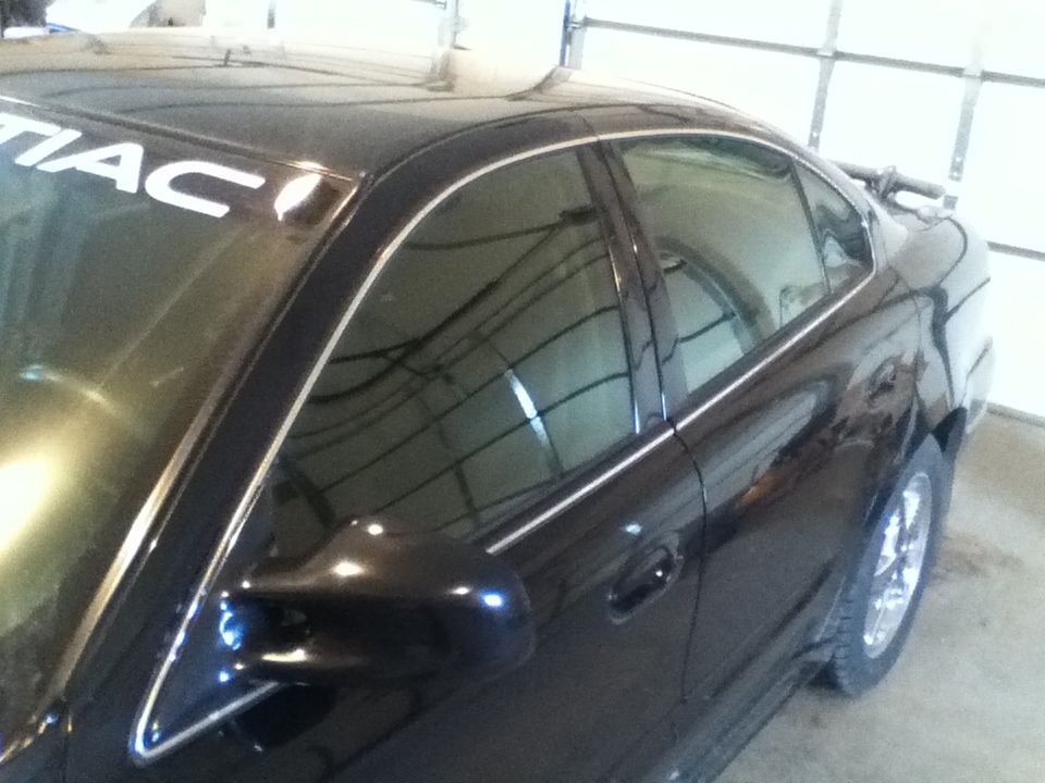

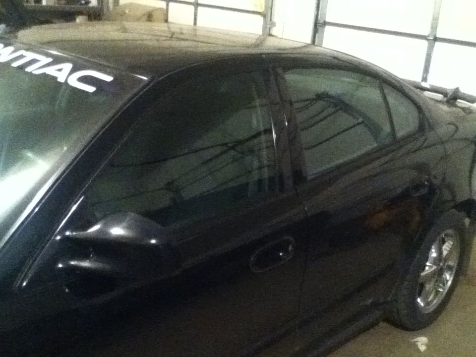

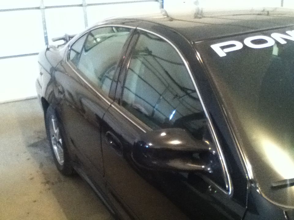

Old 02-28-2014, 08:49 PM   #6394
Before:
After:
Before:
After:

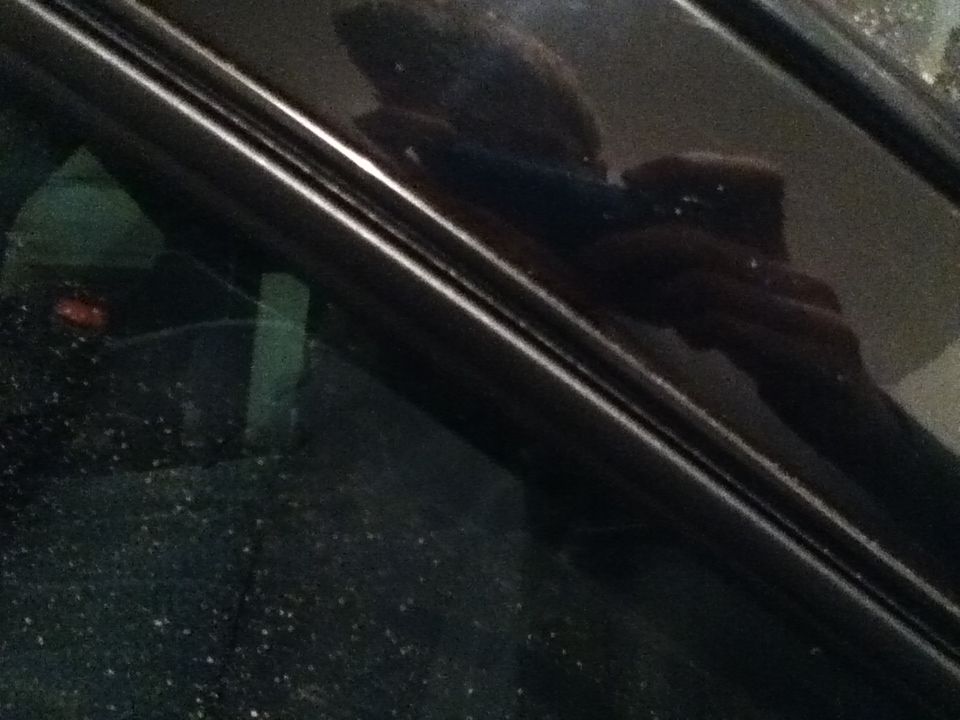

A close up: (the window is just dirty, that's not plasti dip)
