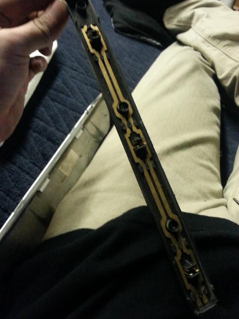

You need grand am housing/lense.
Impala 3rd brake light led board/wiring.
Remove stock board (3 hex screws) then either solder the wire to the brass plates on your stock board. Or just wrap wires around postive/neg brass parts. My solders wouldnt stick so I just wrapped it around. Works fine.
Then you can either silicone the board into your stock housing or just firmly push it it. I just pushed mine in and it holds snug.
Here is a look where I wrapped the wire around the stock board.
Also is a pic of the board after all taken apart. One side of the brass is postive one side is negative
