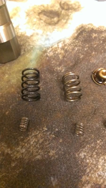

So this is trippy. The new lifters springs are way more stout than the TCE springs.
Im going to leave them just the way they are..

Old 04-26-2014, 08:41 AM   #98
They may be shorter, but that doesn't mean they are weaker. There are other factors that affect that like thickness of the coil and metal type and the way they are wound. Anyway...
It's kind of odd that they are that short though. I didn't know TCE had/sold lifter check springs either. I got mine from WOT, and I believe they were LT springs, not LS. My dad has a Corvette with an LT4 and I know the difference between that and the LT1 was the LT4 has a different cam and 500rpm higher redline which bumped the hp up a little, and the lifters where the same but the LT4 lifters had stiffer check springs. It's my understanding that the springs give more valve train stability at higher rpm with bigger cams/stiffer valve springs. I'd have to check my receipt (and I'm not sure if it's noted on it) but I think the LT4 springs are the ones they carried and sold me.

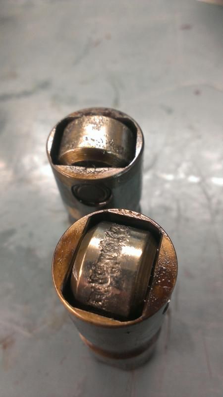

When I did my engine build my lifters had some damage on a few of the rollers as well. Not nearly as bad as yours, but I decided to replace them anyway to be safe. I ended up getting some sealed power oem replacement lifters instead of factory stuff, and I disassembled them and compared their springs to the oem ones and to the LT springs I had. They were a little bit different iirc, but I don't remember any of them being different lengths, so I find it odd that yours are. The LT springs were noticeably stiffer and that was it.
edit: was looking back through my old threads, trying to find the pics of the lifter springs. Haven't found them yet, but did find that I actually used LS springs. I'm thinking now (iirc) the LT4 springs and LS spring may be the same? I think I might have had my dad look into it for me and find the part numbers, but I don't remember 100%. Too long ago and I'm getting old.
