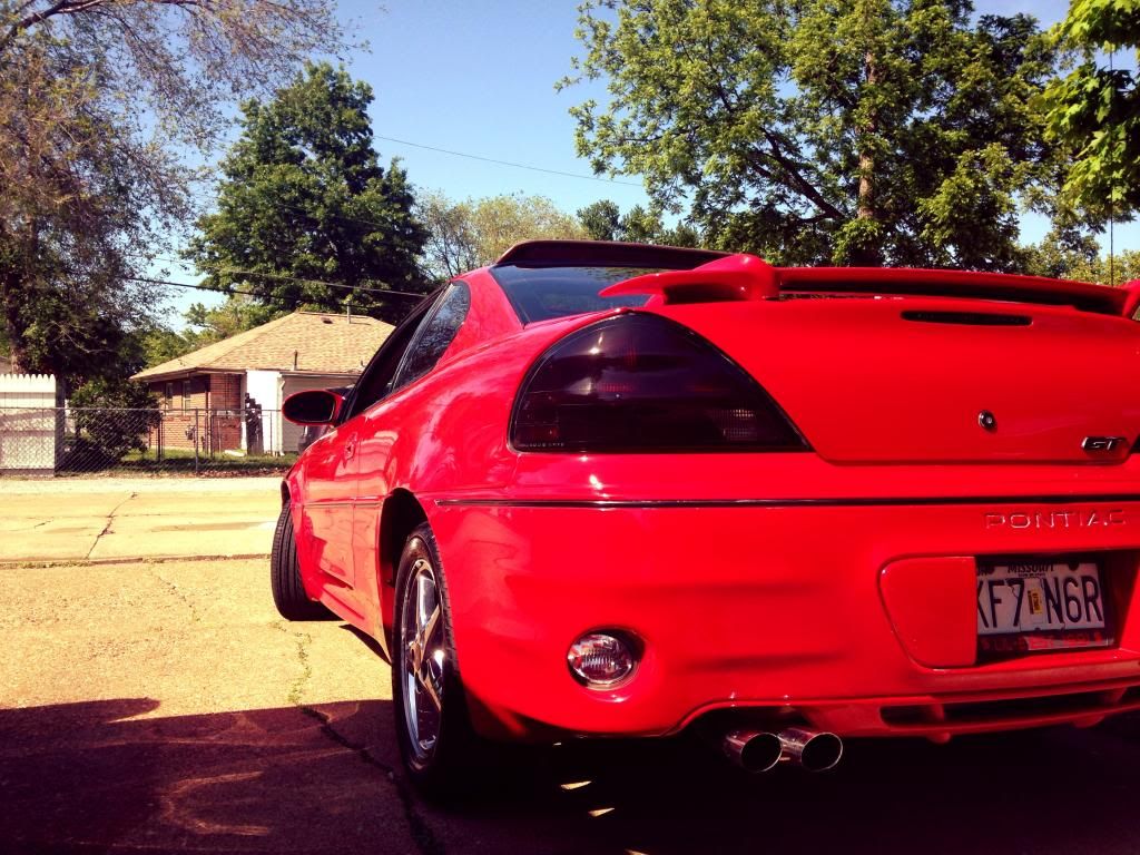

Decided to spend the day claying because I needed to spend quality time claying the car. Wasn't nearly as much contaminants in the paint as there was when I first clayed a long time ago.

looks good, and i'm prolly the only guy here that likes the shiney tires. but they really make the chrometecks pop!

I like shiney tires but I don't do as much obnoxious shine like I used to do. Just a little good enough shine.

if it didn't end up all over my fenders, i'd glossify the heck out of my tires.
but i do like you say, just enough to make them look clean and dark, and not sling off.
car looks good btw. fresh but still needing a wax to make it look like a deep red pool of kool aide

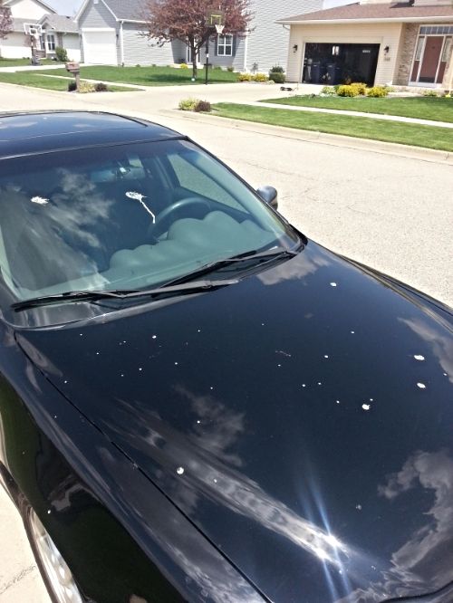

I am also planning on doing some detailing tomorrow. So I should have some good reflection pictures.
This is what my car looked like when I went out to it today. Car was filthy to begin with but then the damn birds just added to it. Just went and sprayed it off at the car wash quick since I knew I'd be doing a detail tomorrow.

God damn is the bird okay?
I mean sht(no pun intended)

send that bird a warning

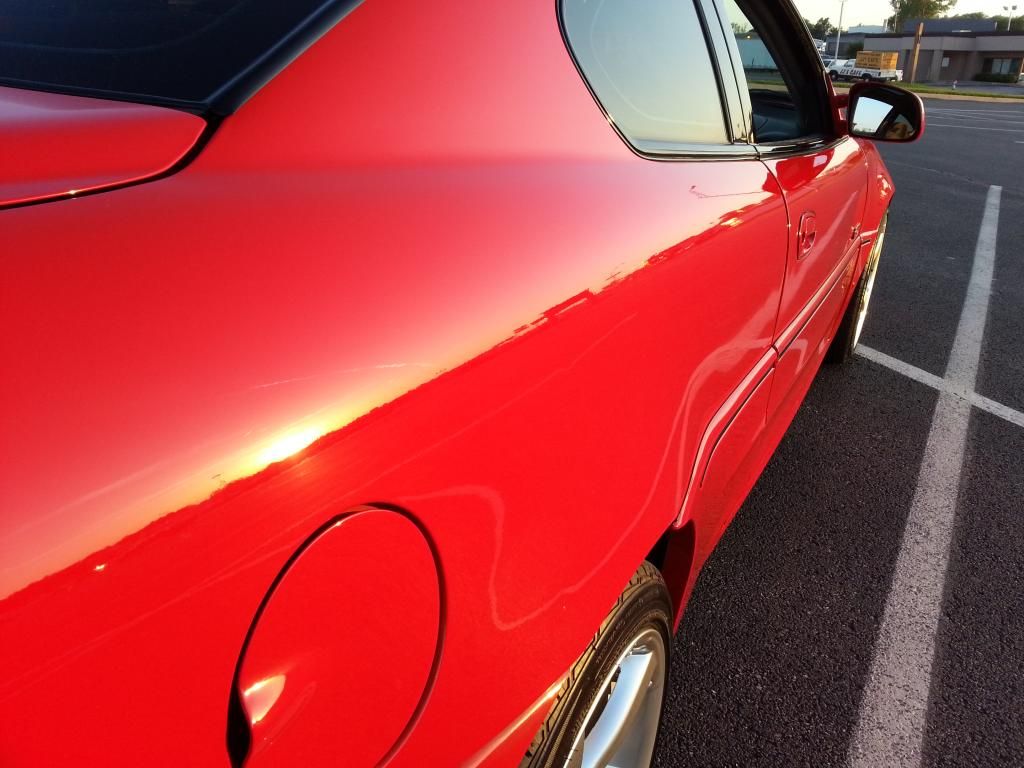

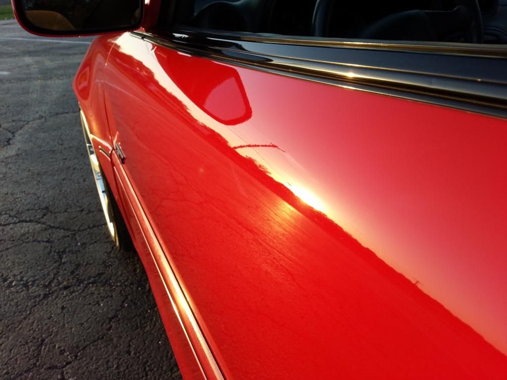

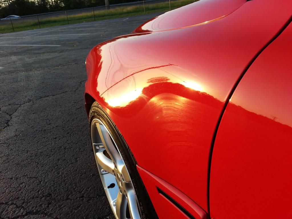

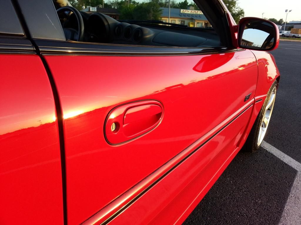

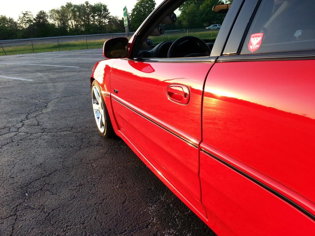

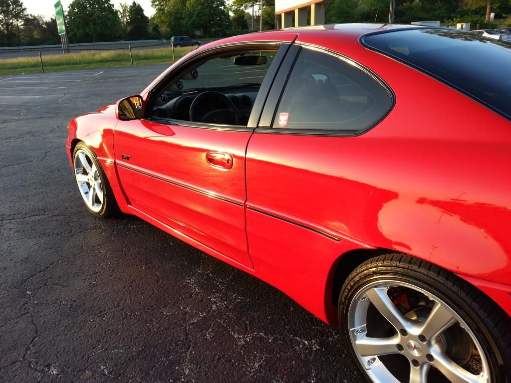

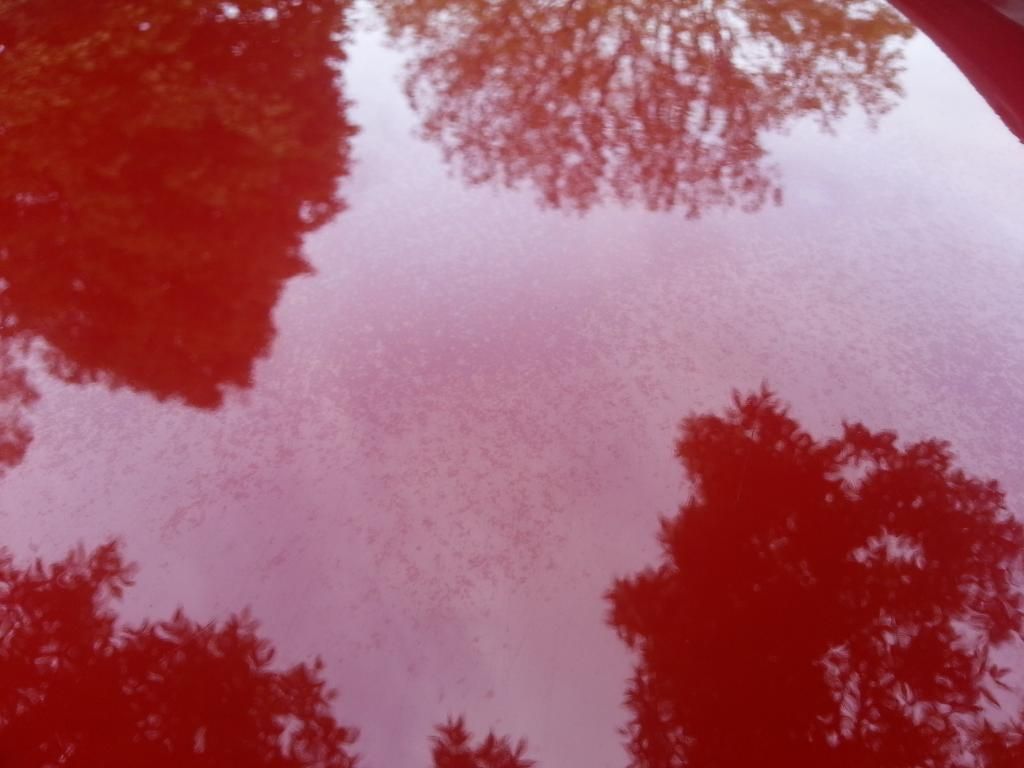

I'm going to have back problems when I get older from them sht. The Medium cut and Heavy cut pads really made everything faster.
Buffed with Megs UC, polished with Megs UP, put 2 layers of AMMO Skin Defense coat on paint, windows, and wheels,, and topped it off with AMMO Creme, going to to another coat of Creme tomorrow. Topped tires off with a subtle shine.
Did a much more thorough job this time, Got the stains out of my black b pillar overlays now they look brand new.
It even reflect off the asphalt

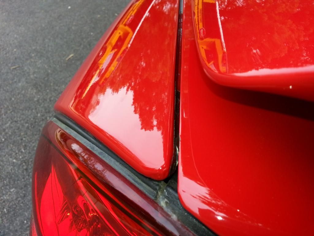

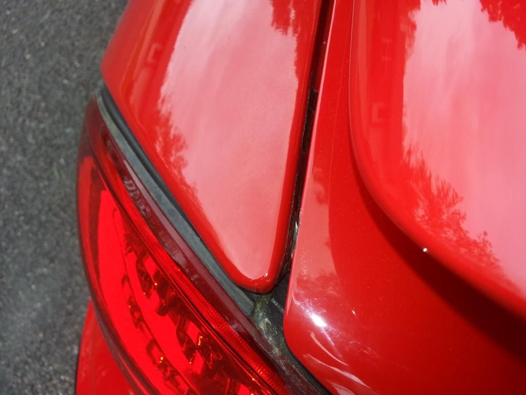

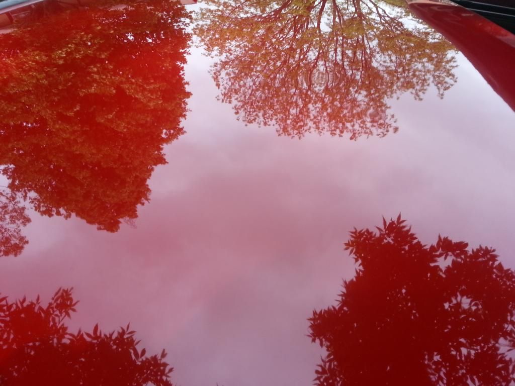

And here are some before and after I got, I didn't do complete pictures because I want to concentrate on my work, I can never do a picture by picture. These are the stains that where in my paint and in curves of my paint, that was my first objective to get out. Found out claying gets it off but it would take forever to do it with the clay.

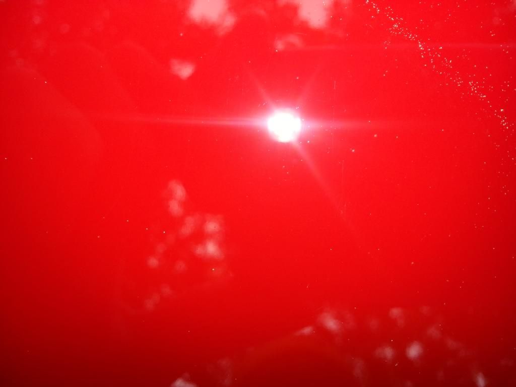

Don't worry, its completely gone, thats just the sky cracking through the clouds that you see in the reflection.
Another, you can see it near the corner of the fender.

Wow that looks great nice job. Which pads did you use with your UC and UP?

I used the Yellow and pink with UC on speed 5 and 6. Yellow=heavy cut and pink=medium cut. then just used UP with the white polish pad.
Old 05-20-2014, 11:40 AM   #618
Also started with my normal orange light cutting pad but then I decided to try out the new ones which helped alot.
