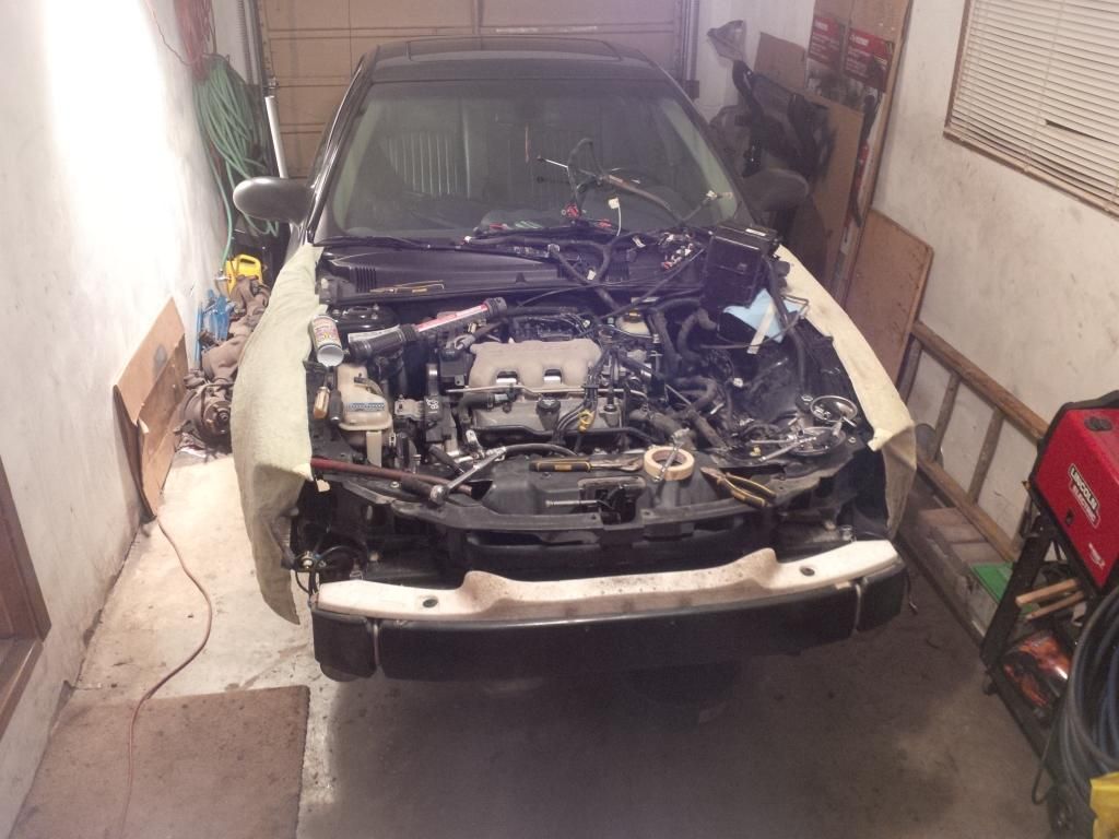

today's progress... busy Wednesday so going to try and get the drivetrain out tomorrow after work

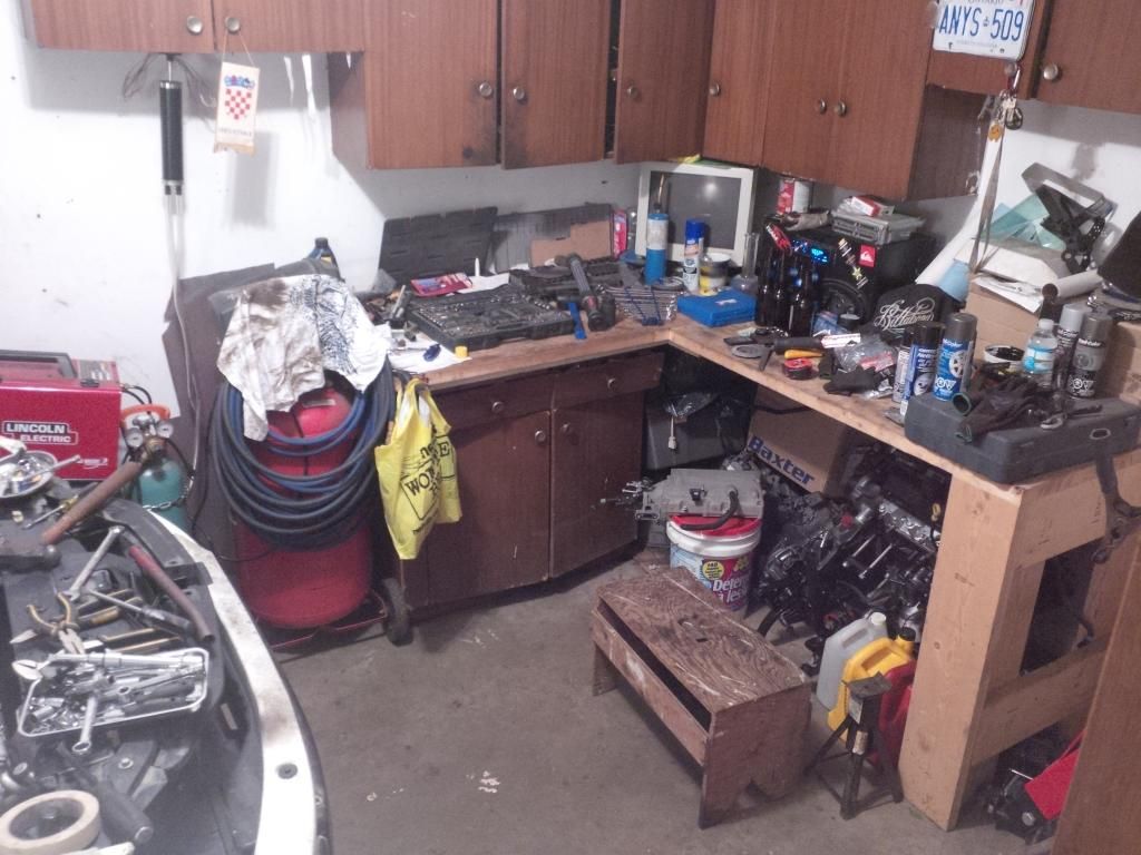

Man what a tight space to do a swap like this
haha ya its little but at least it has walls and a roof
that's roomy compared to my mechanics garage.... he only has 8' ceilings and it's about 12' wide .... You should see him doing a rear end on a lifted Sierra lmao! Barely fits in there to begin with then up on Jack stands it's pushing the roof up
12 feet!?!? **** that be nice, I'm not even 10' wide my trucks not fun in the garage with a 3.5/4" lift... after the car trucks getting a solid axle swap and will be sitting around 10"s of lift with 35s
extremely tight
and infront of the car isn't much better been debating on turning my L bench just into the back wall but I love the space I have on top.... decisions decisions

didn't work on it as much as I wanted but more progress, pretty much only thing holding me back from yanking it is the damn exhaust! can't get those bolts to budge so might just chop the DP and install my headers at the same time....

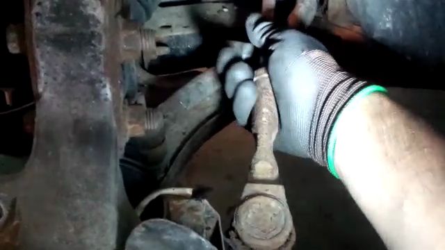

and I might need some tie rods

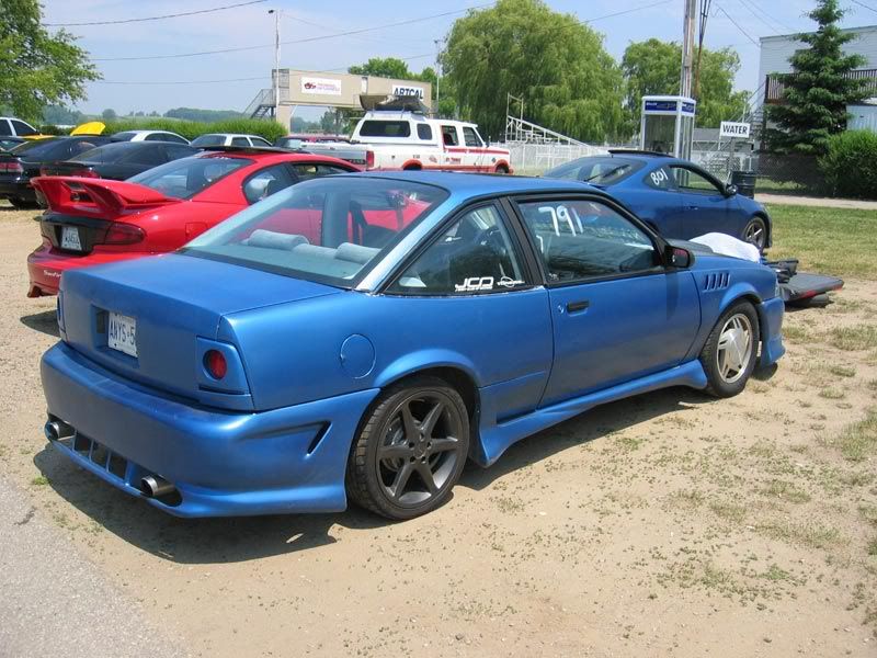

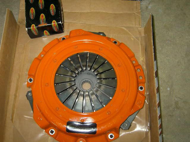

Tim you might want to look at a different clutch for that trans if you end up getting it, I had the same one on my 90Z24
was a decent clutch but there was something that had clearance issue's so CF made them slightly different then there normal dual friction clutches and they didn't perform as well in the older 2.8/3.1s and that transmission is more then likely a cable driven speedometer....

was my 1st car and 2-3 transmission went in it but I also learned to drive stick on it and beat the **** out of it haha still miss it some days minus the body kit I put on
