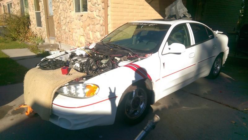

OK the car is in my driveway.. Totally towed it from my dads shop to here.
Here is my only problem right now...
I put the wiring harness on, I cant find the connector that goes the the crankshaft position sensor. ('back' of the block dead center.)
I am completely lost on where it could be. It seems like it would be on the loom that comes between the back of the block and trans.
That loom also has like a speed sensor on the tranny, the low oil sensor and one other thing. I got so mad just waiting to put the motor in I said Eff it and put the motor in!
So Simple, But So STUPID!!!!!!
I have one more connector to find for my ignition. Also...
Still have to mount the fuse box, pull the connectors in for the ECU, mount the battery tray, CV axles need to go in, power steering lines, need an alignment.
Crunch time!

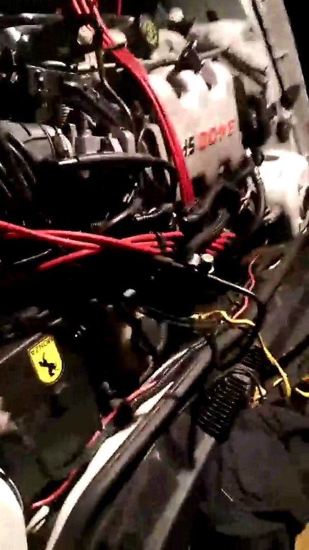

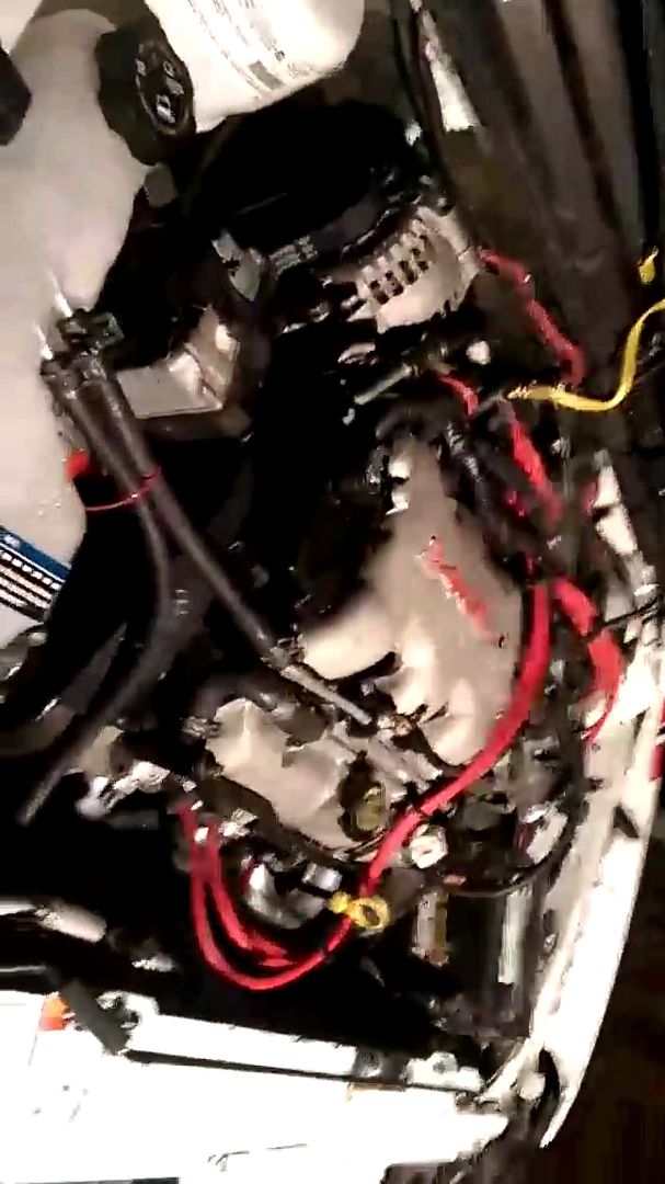

All put together!
Just have to connect the power steering lines to the rack and hook up the trans cooler lines.
I am going to modify them and add another cooler after it comes out of the radiator core.
The rear headers arent on yet. got some welding to do..
Once the exhaust is done it goes to the shop to get tuned!!
Im having trouble sleeping at night. :/
Yeah that is 3"
