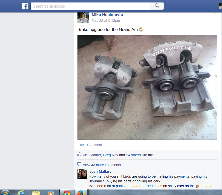

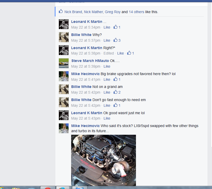

Thought this was kind of funny as well... Made a post in a local FB group about the brake upgrade, so much hate for the N-body haha
Facebook is retarded. I can't do that crap anymore, so many retards.

What group was that? Don't recognize any of the names. Was it Grand Am Nation?

FB wasn't grand am specific or anything, just a 519 cars club for my area

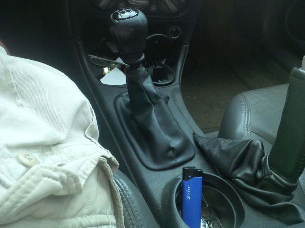

checked out a couple junkyards after work today and FINALLY found a 5spd grand am for its shift boot!
Doesn't seem like much but I hated how my interior looked with the Alero shift boot just kind of floating around the shifter, might go back and grab more spare 5spd parts for myself or perhaps for resale also grabbed some 98+ F-body calipers for its brackets

Mike, I've got a complete interior from a grand am 5 speed.... i was going to swap over my alero to the ga interior but only did the seats....

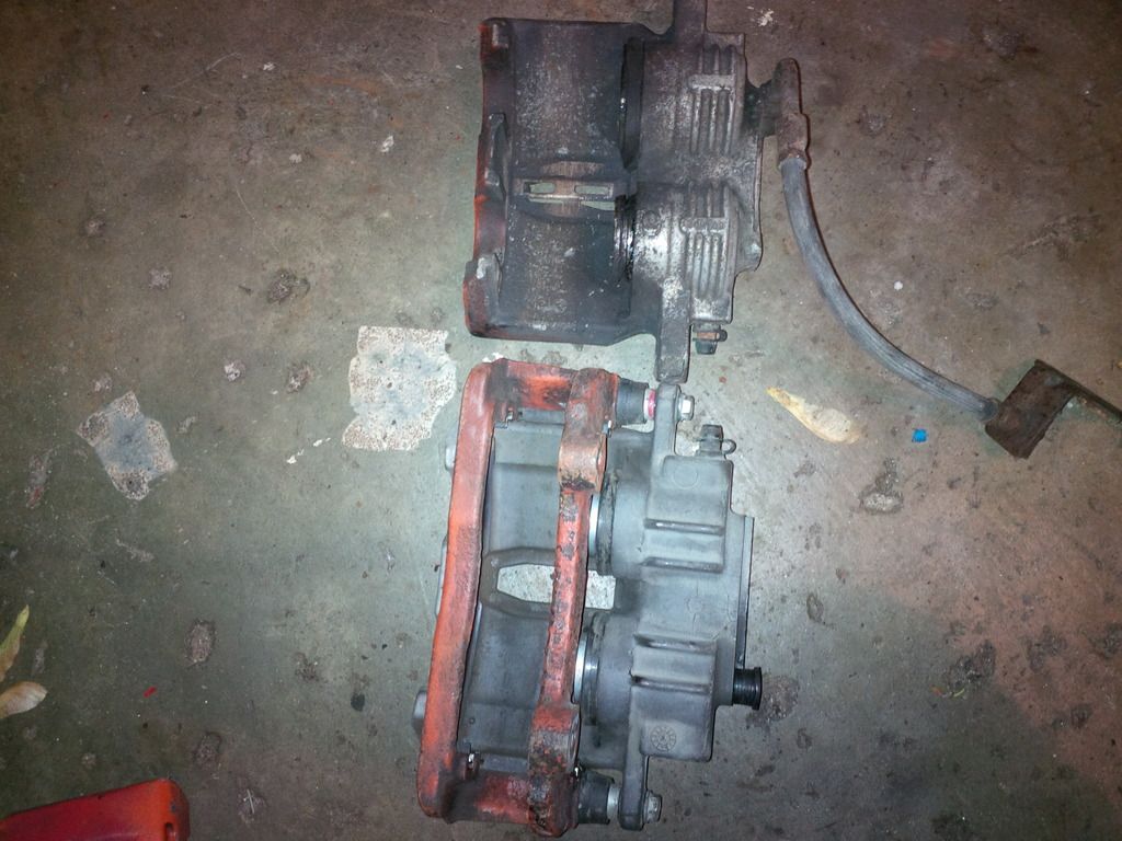

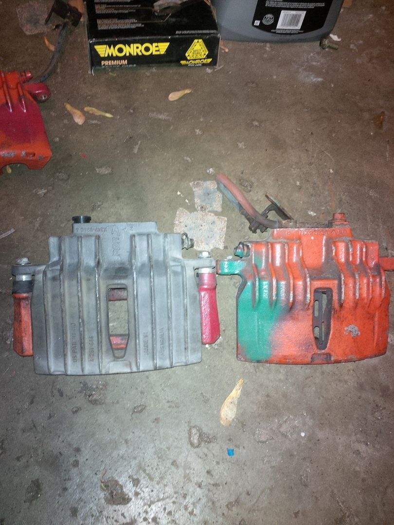

if you are grinding the ribs off you might as well run the f-body calipers since they are the same thing minus the ribs.
not true.
-Pressure cast vs gravity casting
-more ribs(top/bottom)
-thicker in some spots
-slightly different design/construction making them more rigid
-they actually have a smaller piston(40mm vs 44mm) but C5 pistons are double the thickness it looks like
-LS1 people are saying F-body calipers will spread under excessive hard braking and C5s hold up under same conditions
and last but not least I really want the Corvette writing, want people to be like wtf when they notice it
did some reading last night if you couldn't tell couple pics for comparison
