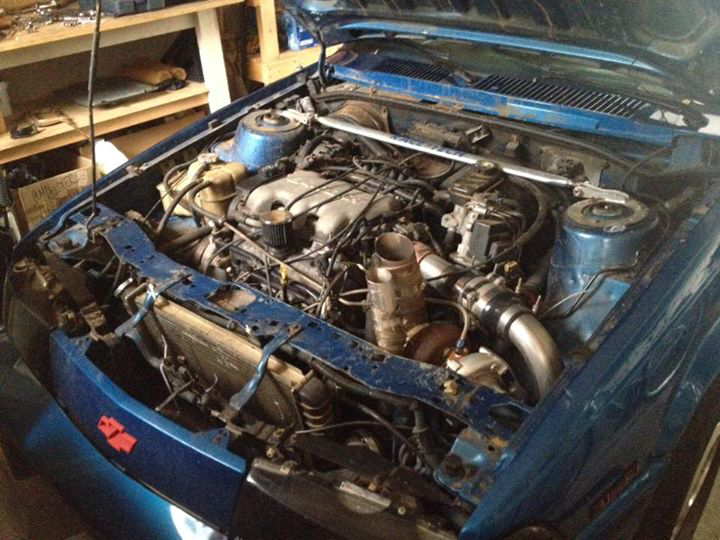

Will be buying another turbo as well and selling my godspeed gt35... 7L CAT Borg Warner turbo will be going in
will need some cutting and welding I'm sure but this is the budget setup I'm going with!

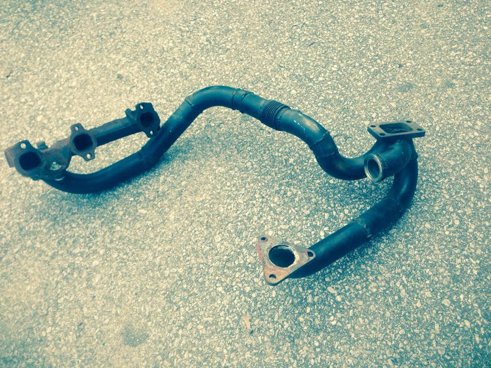

Dang dude you had a good sized turbo before, now something bigger? Did you weld up those turbo manifolds yourself?
new one will be pretty similar to the GT35 but with a bigger hot side according to a local turbo shop
manifolds are 2 fronts from a LX9 with custom crossover that I did not weld, it was originally mocked up in a Sunbird GT so I'm expecting to chop it up, especially since the entire crossover is one piece so I want to add a V-band or 2 and will probably change location
