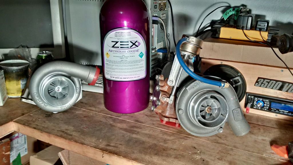

picked up my Borg Warner

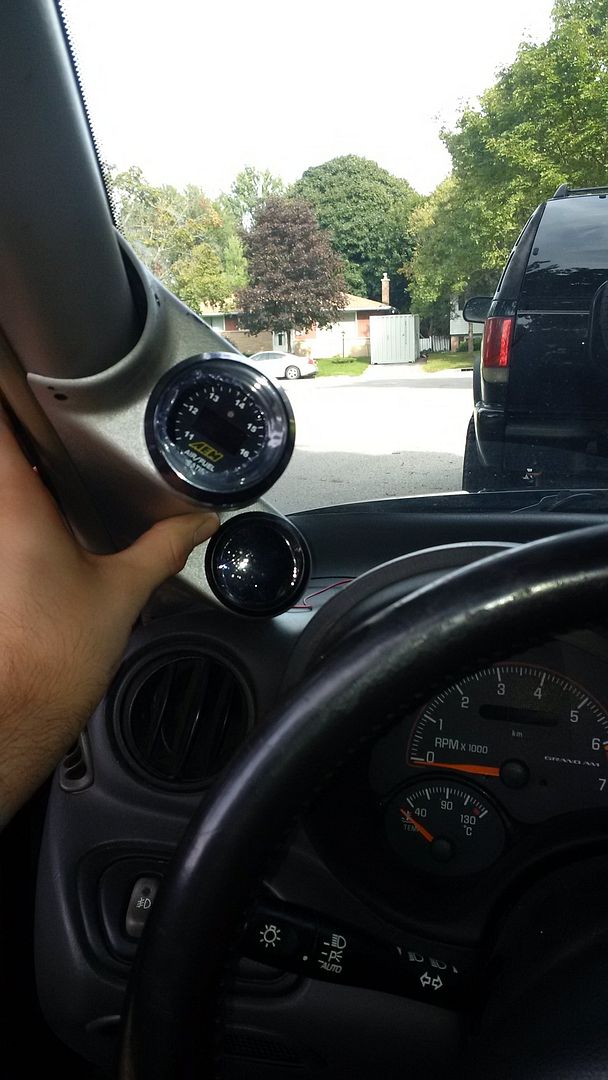

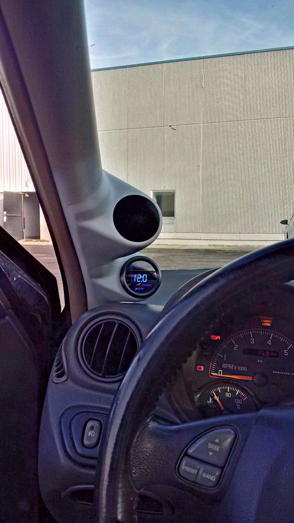

J-body gauge pod with AEM wideband and volt meter for now
Trimmed and plastic welded in place, had it higher up at first but decided to move it down as I plan to add another pod
quick sand and primer, still need to weld in a bung for the wideband

Dropped my exhaust lastnight and got a o2 bung welded in for my wideband, running rich at WOT it seems

You want to run rich at WOT, that is normal. Makes more power that way and prevents detonation. Stock AFR is commanded 13.6 at WOT. A lot of people command it richer than that after doing mods, and sometimes it allows advancing the spark timing as well (especially if switching to premium fuel). Guys running a lot of boost dial in as low as 10:1 for AFR.
Old 10-10-2015, 09:39 PM   #307
I think mines dialed for 12.6-13.3
