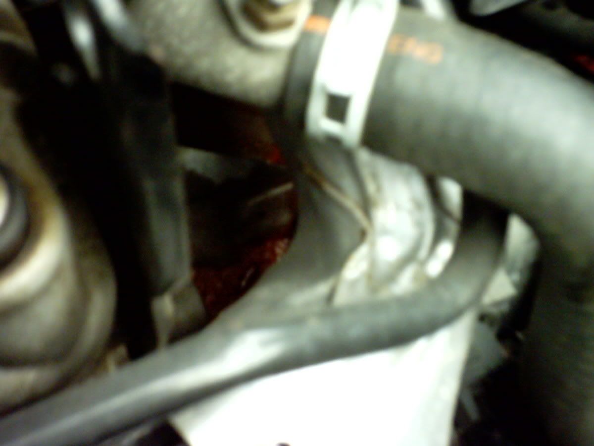

Ok now i got a low coolant message a month ago so i put some in, every 3 days it says low again so i just let it go maybe thinkin its buggin out but i check n its outta coolant...its weird..i put more in...same happenes...weirdest part is theres no coolant on my driveway or anything but today i was putting more in and saw a leak somewhere in my engine..not sure where its from cuz im not good iwht engines, heres the pcis of the leak..

LIM leak, bummer, its not a question of if, its a question of when, it will get you all.

LIM = Lower Intake Manifold
LIM gasket leak.
Get it fixed right away!
As you don't know if if is also leaking internally.
Check your crankcase for 'milk' (oil & water/anti-freeze mixing).
If you see it, your engine is living on borrowed time.
If you take it to a garage: The labour book rate is about 8-hours.

If its leaking on the outside, the other side of the gasket is just as degraded, and on the verge of leaking. When I had to pull my front head because of a broken exhaust stud, my gaskets were in terrible shape. Not leaking internally, but it could have started any day. Fix it before you have coolant in the oil, that will ruin stuff FAST.

yea brought it to my friends shop today, LIM leak indeed, 840dollars with labor to fix.....maybe saying bye bye to the GA..i know thatsa bold statement but im 18. i dont have 900bucks laying around, my mom doesnt give a sh!t and thats all that story

LIM leak fixed - 850dollars
