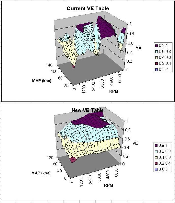

I am wondering if DHP with the 1.0 PCM made any changes to the VE table?
The DHP Powr Tuner VE tables were off pretty bad, and alot of people were wondering why they were fighting their tune. Thankfully that issue is now corrected.
In the top pic you can tell where the problem was. The bottom pic is the corrected VE table, so if you are using the Powr Tuner make sure you are running the 1.2.3 version for the corrected VE tables.
I have a feeling they didn't. Changing VE without scan data is to risky.
As for the new tables, I've already completed my VE tuning with them. Strange thing was it didn't make any major changes to the rest of my tune.
As long as we're using v1.2.3 we'll have the correct tables though right? I'm hoping this is part of the reason I was having so much trouble last summer. I was using v1.2.0 last time I tried to VE tune and I couldn't even keep the car running long enough to get into gear and out of the parking lot with the MAF disconnected. Whatever the issue, my car needs a VE tune BADLY and I want to get it done this spring.
Old 01-25-2007, 09:56 AM   #31
Sprucegagt
Schwartz Power!
Sprucegagt's Avatar
AKA: Andy
Location: Ranson, WV
Age: 46
Posts: 2,027
Vehicle: 2000 Grand Am GT
Sprucegagt a trusted member
Yes, 1.2.3e does have the correct VE tables. 1.2.2 had them as well. But get 1.2.3e, because saving your scan data is faster with it.
