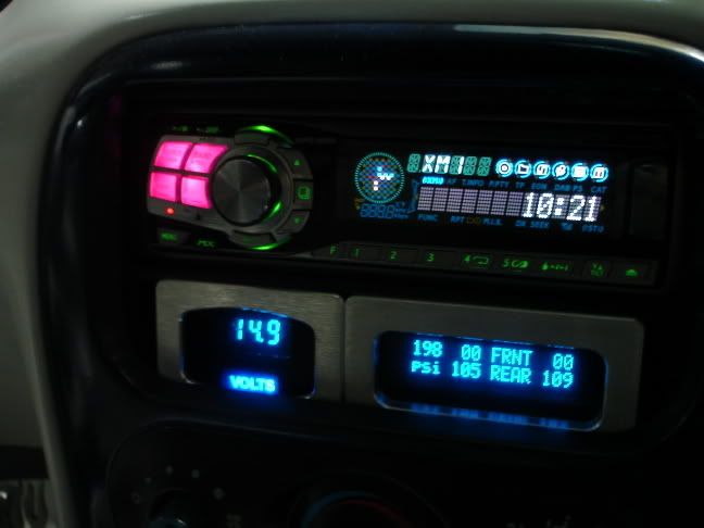

nice setup.....where did u run yours lines?
and wheres your gauges mounted?

Thanks, my gauges are the dakota digital ones.. so i don't have to run any extra air line, Just ran more wires. LOL Rick (fmkustoms) sells the digital gauges too on his site.

how about the air lines for the air struts how did u run them?

nevermind i ran my front lines today, as soon as i get more airline ill run the rears and snap a few more pics
