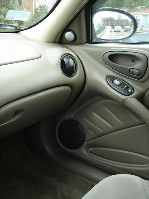

Hey man,
On amps and speakers, the RMS rating is the key. I honestly don't pay any attention to the peak ratings.
An amp's RMS rating is what it can put out continuously, all day long. The peak rating is what it can put out briefly during a dynamic track (hope I phrased that right).
A speaker's RMS rating is what it can take all day long without overheating the voice coil. Peak is, again, what it can take briefly without issues.
Your setup looks good. Stock door size is 4x6, but it'll sound significantly better if you can stick 5.25" (or 6.5") speakers in there. The easiest way to go bigger is with the Metra 82-3300 kit (made for the Cavalier/Sunfire). If you go with a set of components (separate woofer and tweeter) like these or these, you can mount the tweeter up in the sail panel like I did.
http://i74.photobucket.com/albums/i2...ss/tweets1.jpg
http://i74.photobucket.com/albums/i2...ss/tweets2.jpg
http://i74.photobucket.com/albums/i2...ryss/pside.jpg
If you have the stock tweeters up there, you can get a set of blank sail panels (no hole) for about $8 apiece from the dealer, then make your own holes. That way you can flush mount the tweeters and know they'll look right.
As far as amps, your best bet would be to go with a GM-7200M and a 6200F. Wire both subs in parallel off of the 7200M and they'll each get about 200 watts. Wire the front and rear speakers to each channel of the 6200F.
Once you have some subs in there, you can cut off the bass going to the regular speakers and they'll play louder and cleaner. You might be able to do that right from your radio.
